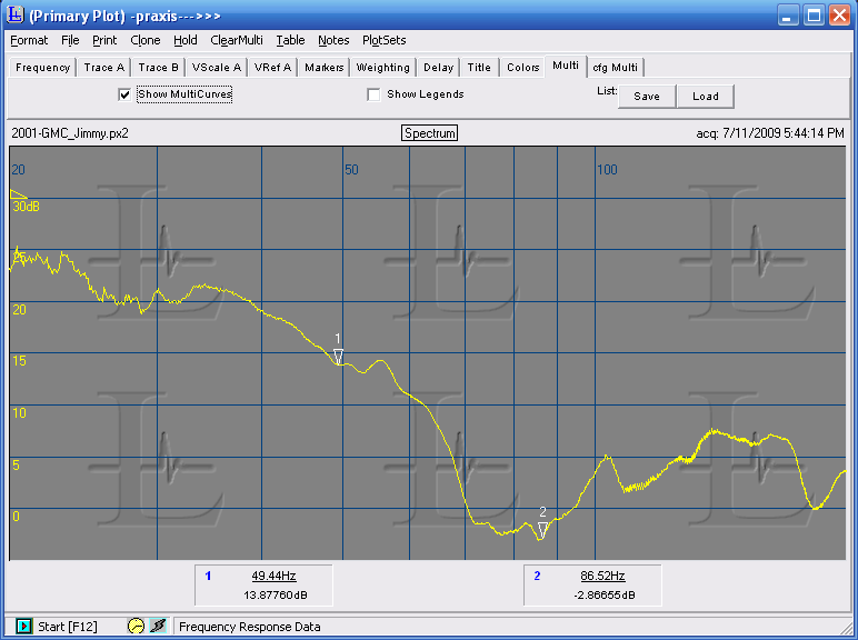

Just for the hell of it I will throw up my results and my vehicle transfer function //content.invisioncic.com/y282845/emoticons/smile.gif.1ebc41e1811405b213edfc4622c41e27.gif

Hate to break it to you Matt but all that fancy stuff doesn't make a vehicle loud. All this transfer function stuff and testing with equipment your not going to use yourself doesn't help with anything at all. There's way more to it then that.... Once you figure it out I can say, "I told you so."
I never messed with clampmeters, transfer functions, box sizes, port sizes, etc, etc, etc.
What it comes down to is test, change, test, change, test, change. No one can show you that except yourself.
Geoff I know what you are saying, but I do beg to respectfully disagree with you to an extent, why keep changing things if you can come to the same conclusion on the first box from running these simple and effective tests. I can put my TL side by side and the graphs will correlate. The fact is all though this testing wont get me a world record, it will be effecient and it will be effective. Jeff Brown and Jordan have done tons of testing as they always do and they came up with subs up port up and that Xterra is crazy loud for a daily beater, as I plan to have mine as well.
Also if I recall, and you said this yourself, you threw your box together once, no test trials or changing of anything. You told me you threw it all together and thats just how it came out, doing some crazy sick numbers right off the bat, close to some world records if Im not mistaken, and that was with no testing. Just ironic cause from what i got you did no changes to your box what so ever.
Because those tests are complete ********, that's why.
Unless you are testing YOUR equipment in YOUR vehicle, any and all testing and computer simulations don't mean ****.
Same conclusion? Hardly.
If you really think that putting a single 12" in your car and testing it firing in different position is really going to give you an accurate representation then you are delusional.

Yea, using a smaller box then going to a larger box with bigger displacement will change the transfer function significantly, however the peak should be close to the same. I went from a 4 cube ported box at 34Hz to a 1 cube sealed box and my overall peak frequency stayed within a few Hz.
Are you referring to the vehicle peak or the enclosure peak?
If vehicle, then yes I tend to agree with you. Though once again it is install dependant.
