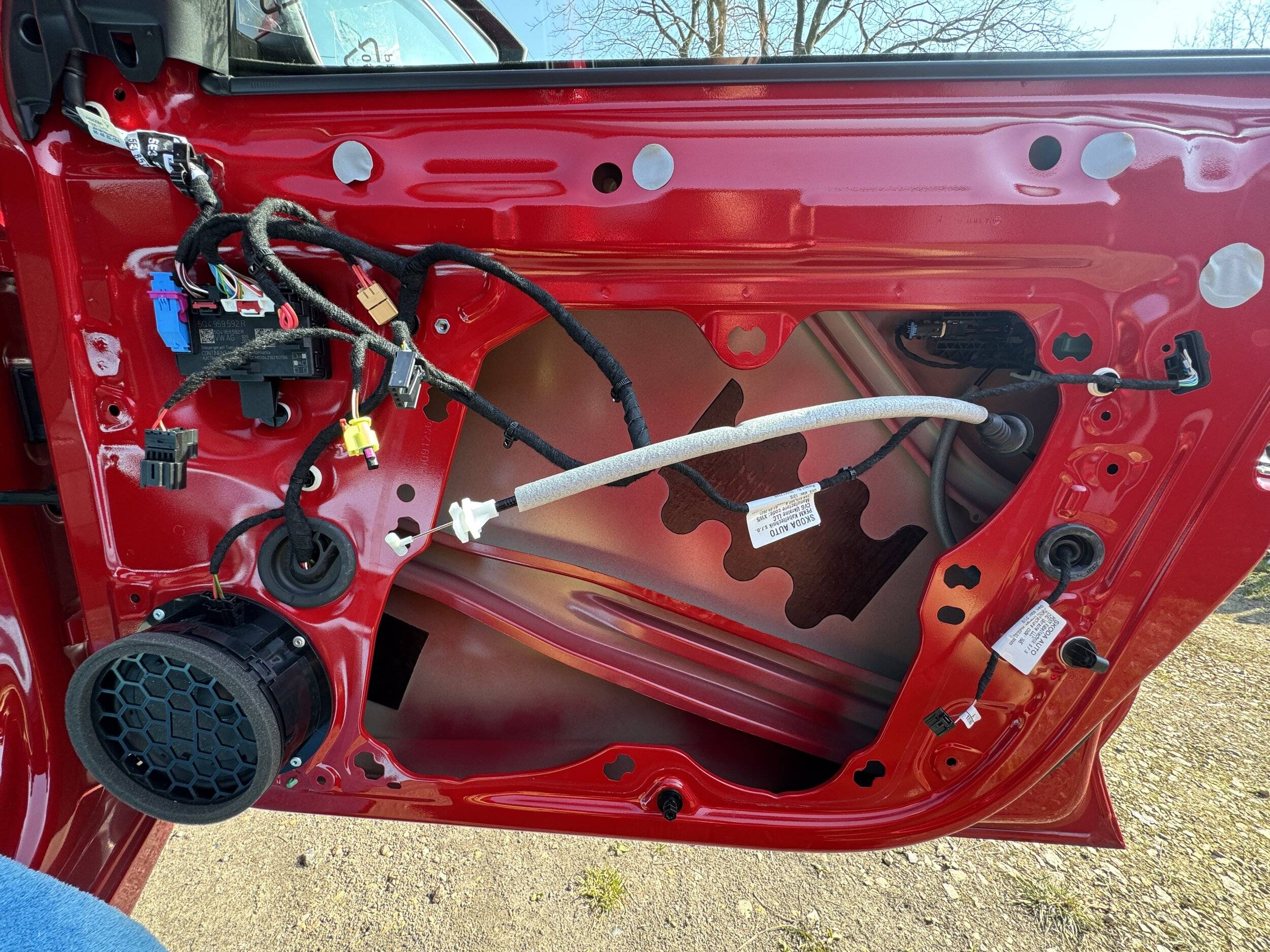

2. Factory Condition (Before)
The stock door had:
large open service holes
thin outer skin with noticeable resonance
minimal OEM damping
plastic door card with no decoupling
speaker mounted on factory rivets
no acoustic sealing around the driver
Result: weak midbass, panel buzz, energy loss, and poor acoustic control.

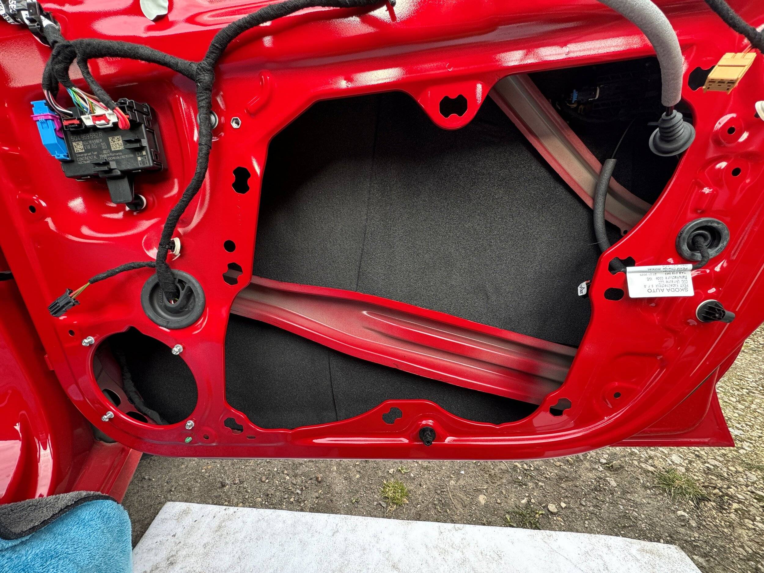

4.1 Outer Skin – COMPLETED
Aero Gold applied to large flat areas
fully rolled for maximum adhesion
C3S applied on top for absorption and noise reduction

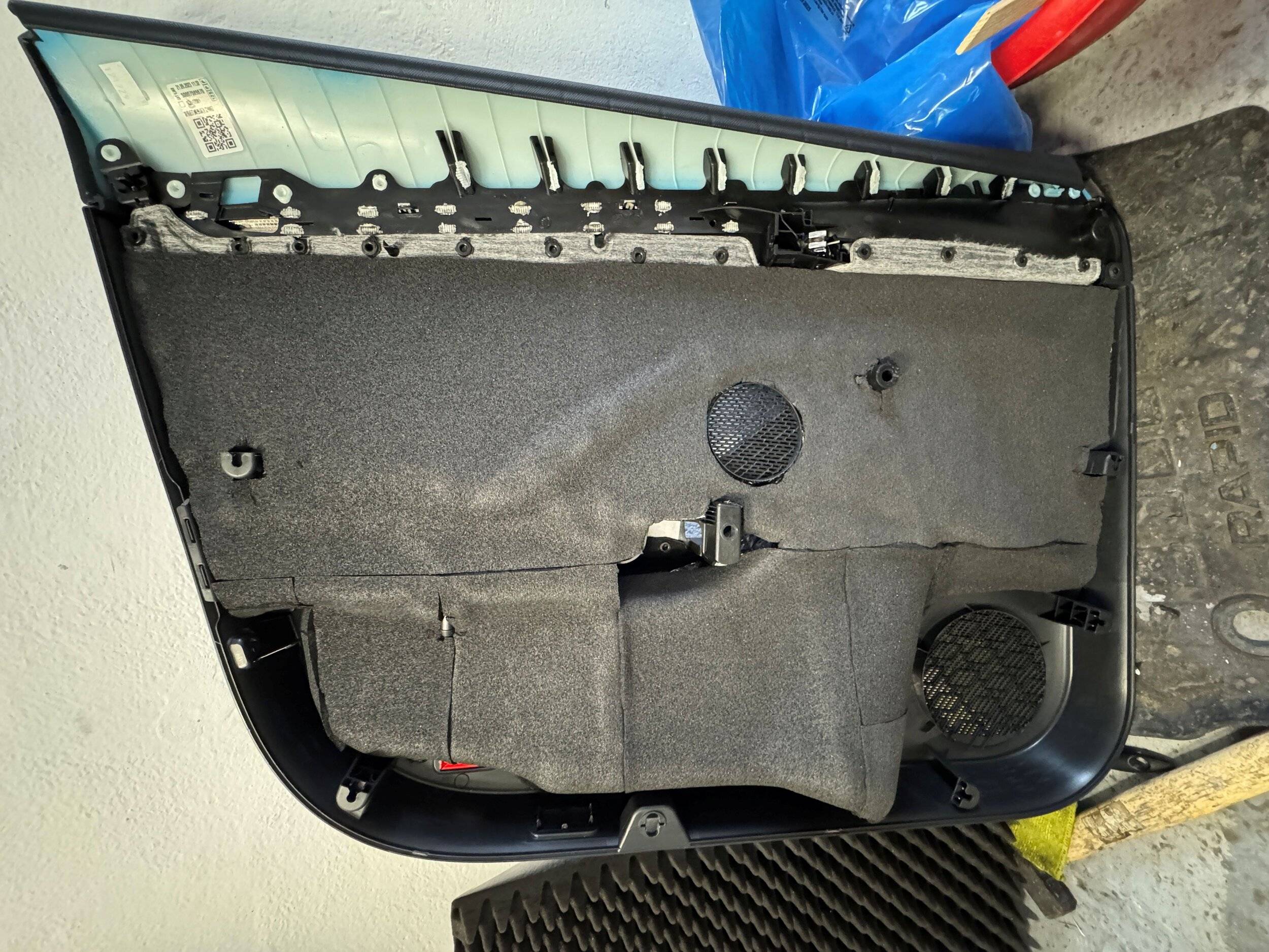

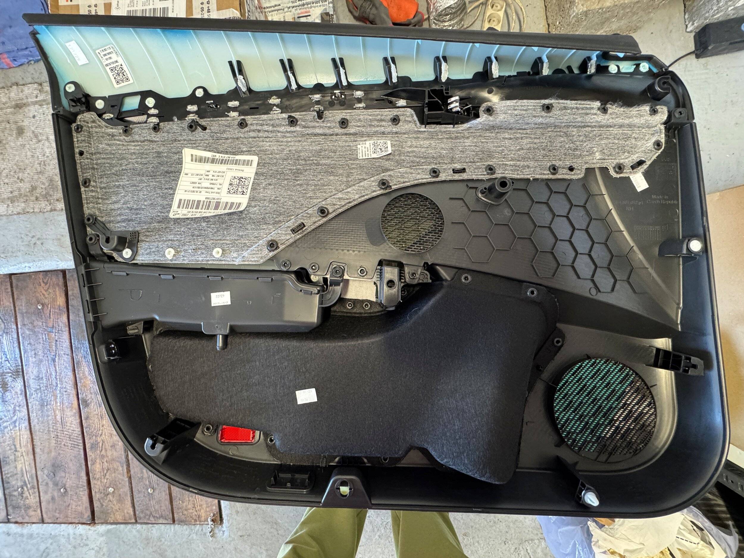

4.2 Door Card – COMPLETED
spot Aero Gold stiffening
full C6S decoupling layer
no rattles, no plastic resonance

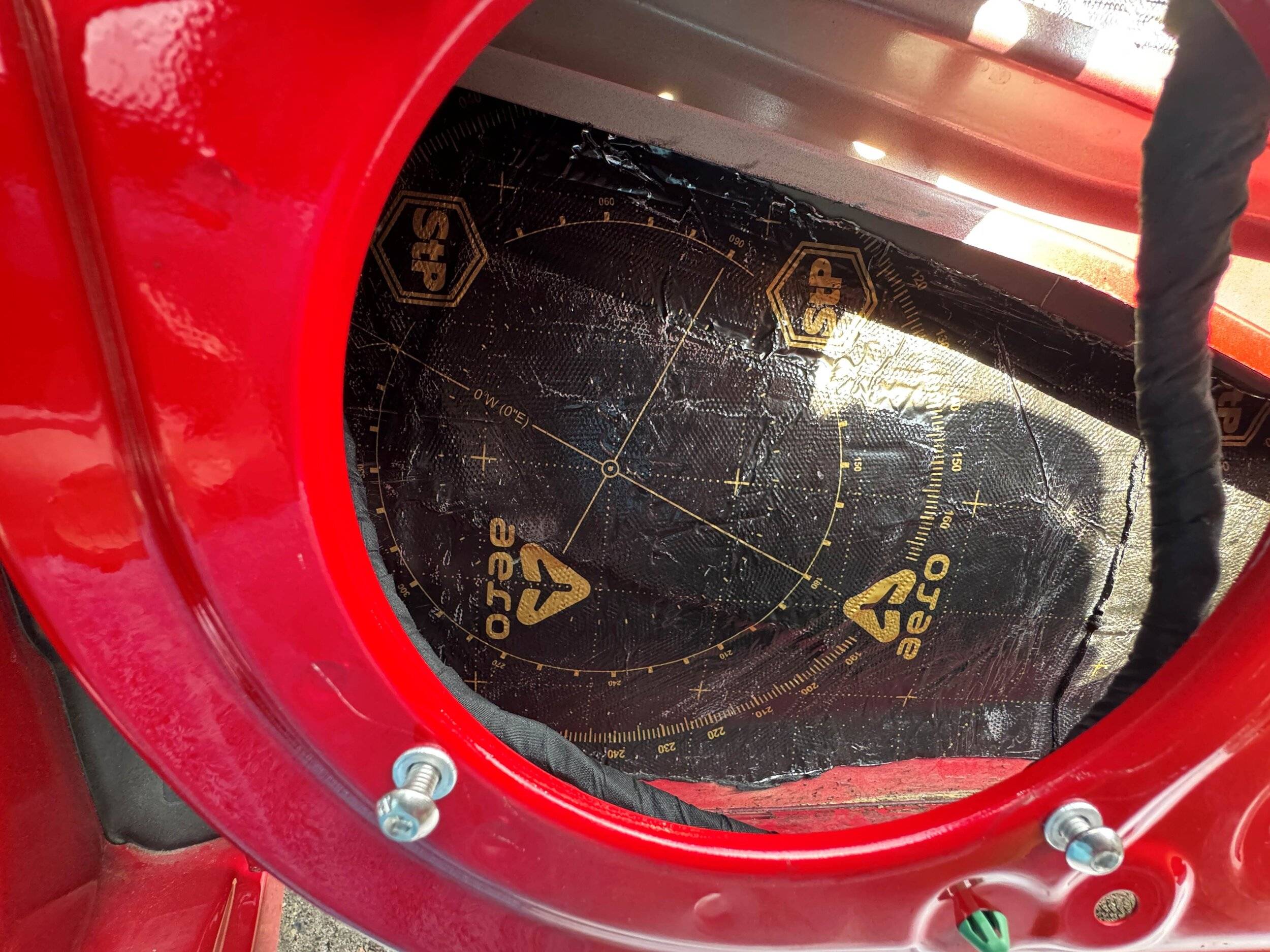

I add shots

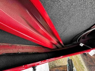

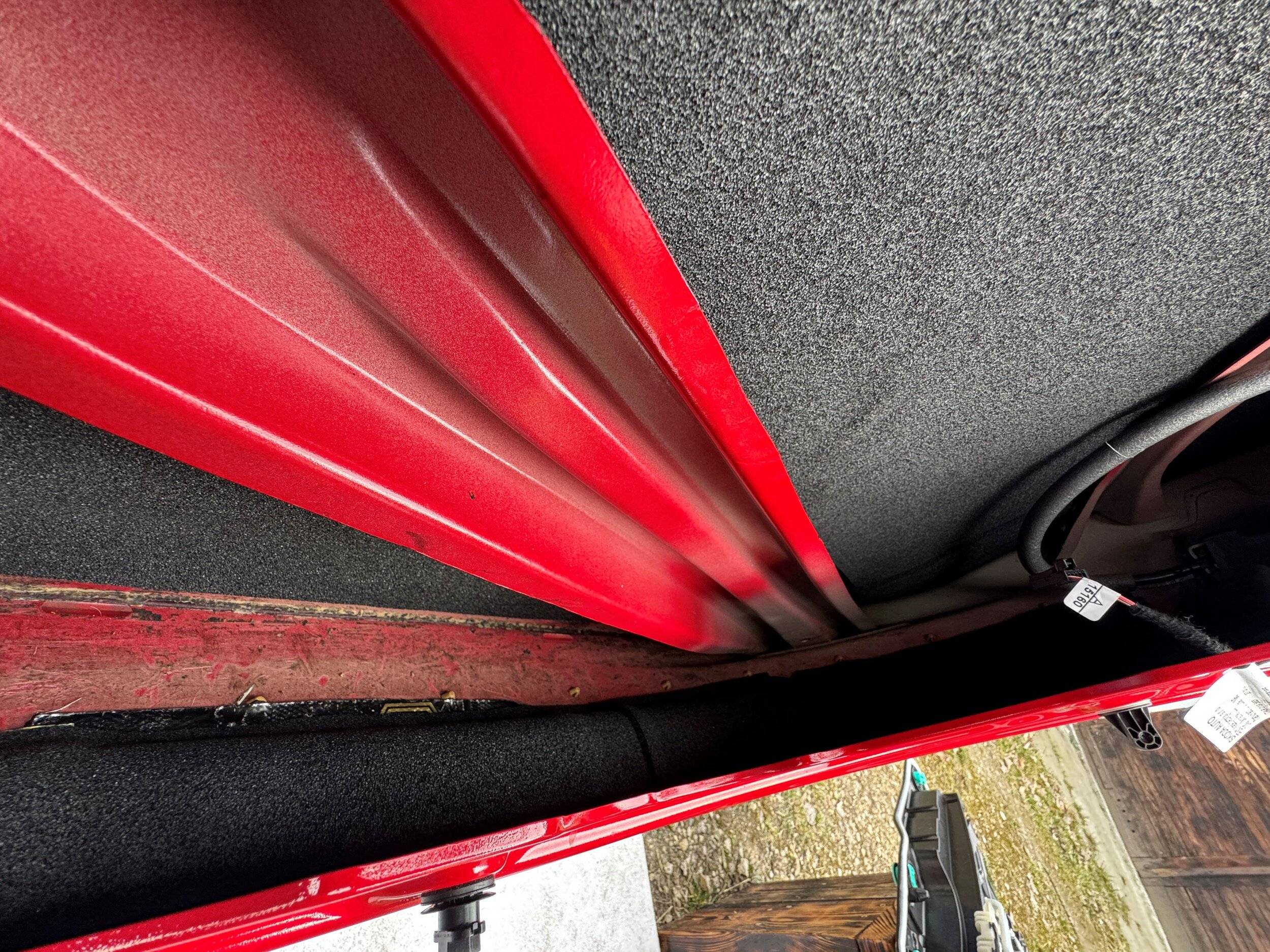

At the bottom of the door are factory drain holes... did you leave them unobstructed?
The sheet metal should be positioned vertically, with the edge of the mat about 10 mm above the holes. On the other side, attach it to the seal clips. This ensures easy access should replacement be necessary.
