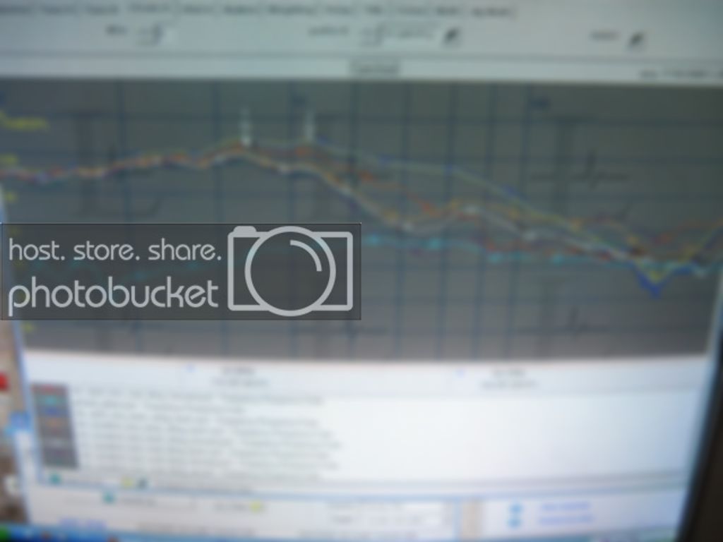

The real build started today and will follow through the next two weeks. This is a SS NW build in my daily driver. Here's the updates for the season plans:

Then onto the box which will be my pride and joy. John at AE helped me run transfer function tests to find not only the transfer function but which configuration would be the loudest for sub and port displacement. After rigorous testing subs up, port up is the verdict. That way I can have maximum airspace and not worry about my port too close to the hatch. Also 43hz and 55hz were the peak frequencies. John helped me design up the box so I have ten cubes all below window line. Interchangeable ports, two are slots, and one is a set of 4 aeros. Today we made all the bracing necessary and the top two baffles. We used all 8 ply baltic birch, everything was cut on the CNC table. I then went over each part with a 1/8" round over and a circular sander. I will let the pics do the rest of the talking, and try and get a vid of the CNC table in action, man is that thing help a bit.
Transfer Functions

Tommy I really respect ya man and look up to you, so dont take this as any offense but I would beg to differ. We ran transfer function with placement variation (i have shown on the graph) and the sub up port up is scientifically louder in my vehicle. What about Jordan from your area, he is doing 152 something with 2 15s on less then 4k with subs up and port up in an Xterra. Your right it may not win world finals in SSNW, as I know it will not be hitting 160s+ but id be pretty content with a 152-153 range, long as I can bassrace the 49.9 class I am set. Not saying your wrong by any means but there are several loud sub up port up builds that are just nasty.
Just stating what I know. Yes, I know you don't plan on winning world records with it, otherwise you would do a better layout. //content.invisioncic.com/y282845/emoticons/wink.gif.608e3ea05f1a9f98611af0861652f8fb.gif
152-153 is a pretty low goal with the equipment being used. Hell, we had a 4 door blazer doing a 151 on the dash with a type-r 15" and an orion 2500d at 1 ohm.
Even with that layout it should be possible to do a 153+, unless you are tuning low for music.
