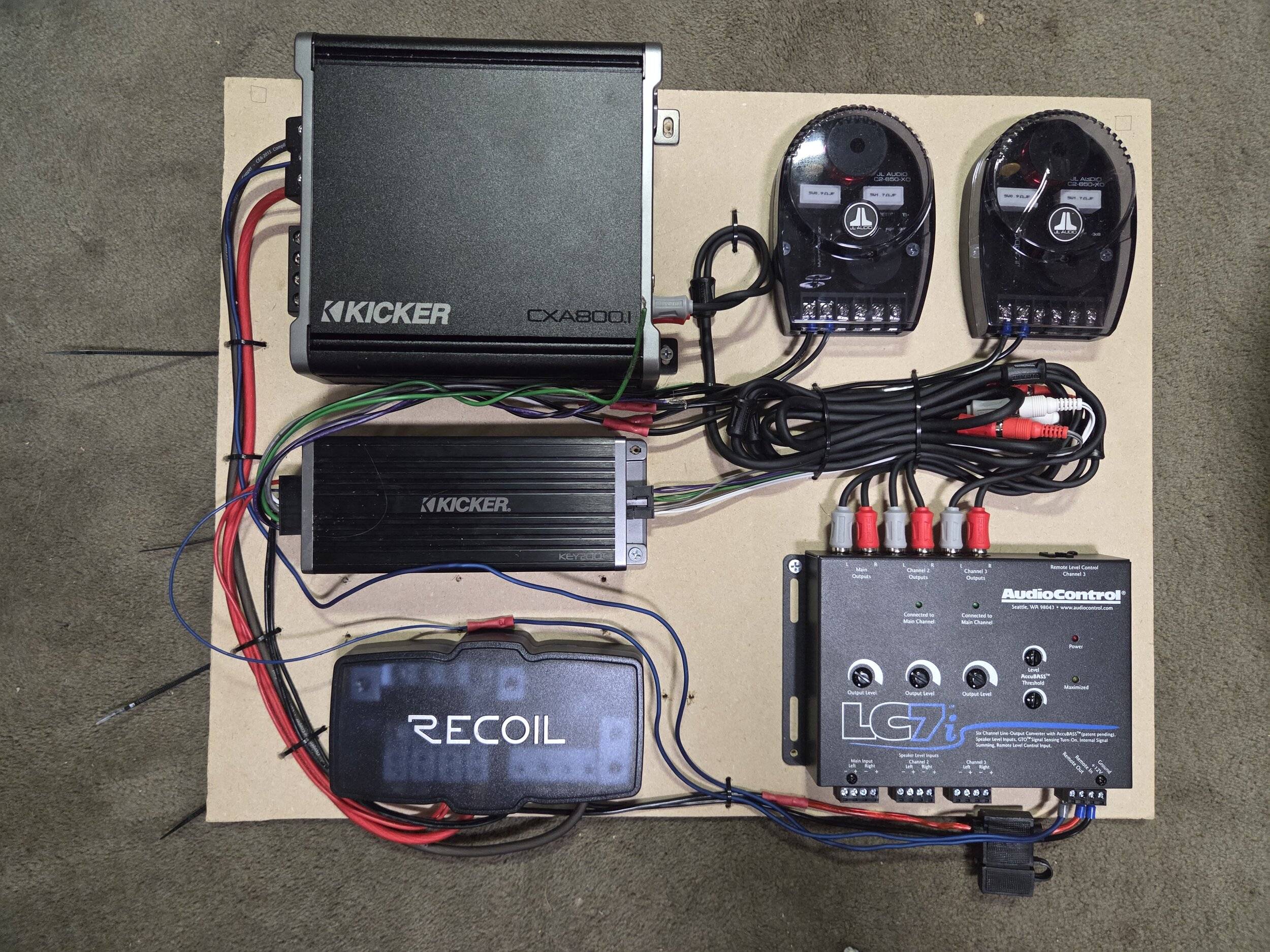

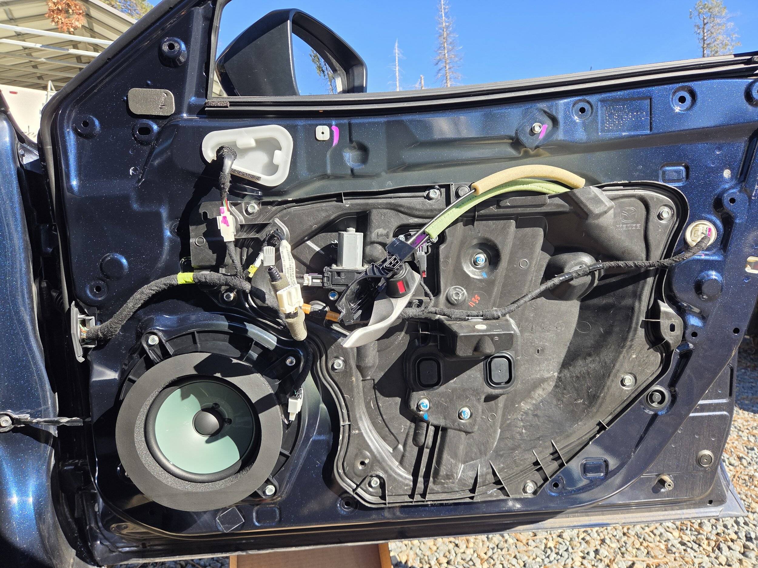

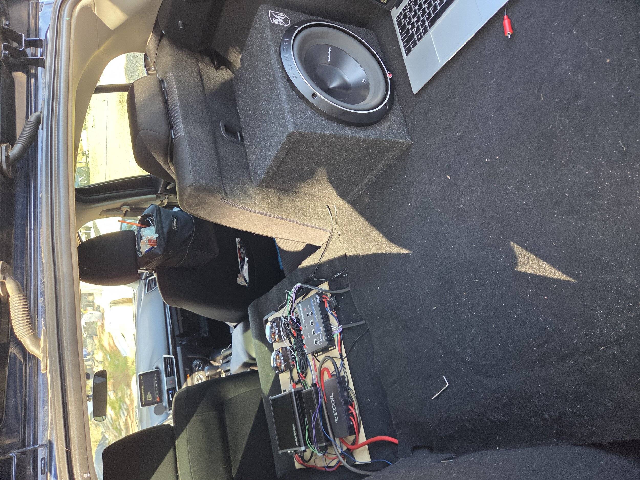

Hi all! I'm new here to this forum but I've put together this SQ audio build through tons of hours and hard work. I'm curious on general opinion of the speakers I have installed and general tuning advice to get the most out of them. Specifically a description of the fosgates for the rears on SQ because I know nothing about them, a friend sold them to me for $80.
Fronts : JL C2 650
Rears: Rockford Fosgate T1650 (installing soon)
Sub: Rockford Fosgate P3D2 - 10 (Sound Ordanace Box)
Amps: Kicker KEY 200.4 (Fronts/Rears), Kicker CXA800.1 (Sub, yes a bit over powered for the sub)
Oh yeah, this system is installed in my 2016 Mazda 3 Hatchback using a LC7i for the LOC from the stock head unit. I also used some 80mil KILMAT in the front doors, will also put in trunk and rear doors because it rattles like crazy. Fast rings as well on speakers with foam tape.

Welcome to the forum! It sounds like you've put a lot of effort into your SQ (Sound Quality) build, and you've chosen some solid components. Let's break down your setup and provide some insights on the speakers and tuning advice.
Rear Speakers: Rockford Fosgate T1650
  • The T1650 is a decent choice for rear fill, especially if you got them at a good price. They are 6.5-inch coaxial speakers that provide good midrange and high-frequency response. While they won't outperform high-end components, they can add some ambiance to your listening experience.
  • Since you’re focusing on SQ, consider the placement and level of these speakers. Rear speakers should generally be lower in volume compared to the front speakers to maintain a balanced soundstage. If they overpower the fronts, it can muddy the sound.
Amplifiers: Kicker KEY 200.4 & Kicker CXA800.1​
  • The Kicker KEY 200.4 is a great choice for the fronts and rears, as it features automatic tuning capabilities that can help optimize the sound based on your vehicle's acoustics. Make sure to utilize this feature during your setup.
  • The CXA800.1 is indeed a bit overpowered for the P3D2, but if you manage the gain properly, it can work well. Just ensure that you don’t push the sub too hard to avoid distortion or damage.
Tuning Advice​
  1. Gain Settings: Start with the gains set low and gradually increase them to find the sweet spot where you achieve clarity without distortion.
  2. Crossover Settings: For the JL C2s, set the high-pass filter around 80-100 Hz to keep them from trying to reproduce low bass frequencies. For the P3D2, set the low-pass filter around 80 Hz to ensure it blends well with the fronts.
  3. Time Alignment: If your amp has time alignment features, use them to ensure that sound from all speakers reaches your ears simultaneously. This can significantly enhance soundstage and imaging.
  4. EQ Settings: Use a parametric EQ if available to fine-tune the frequencies that might be causing issues. Start with a flat response and make small adjustments based on what you hear.
Final Thoughts​
Your setup has a lot of potential for great sound quality. As you tune and adjust, remember to trust your ears and make incremental changes. It might also be beneficial to get feedback from others who have experience with similar setups.
I encourage other members to chime in with their thoughts, experiences, or additional advice to help you get the most out of your build!

That 800w Kicker amp isn't going to hurt that sub. How did you set the gain for the sub amp? Because we know kicker will do above rated I would use a -5db signal when setting the gain on the sub amp as apposed to a -10db signal. On music that sub should handle that amp, especially if set with a -5db tone. Honestly you could use a 0db tone first and see how the volume is for you... you won't have distortion at all on the sub at 0db.
Very late reply, but I adjusted the output voltage from the lc7i to get to around 650 rms, using a sine wave generator app (probably 0db). From the documentation on the Kicker amp, it says it can put out 900ish rms. Recently I also stopped using Bluetooth for my audio signal and switched to AUX, and the difference was incredible. Bluetooth compression really is killer for everything.
