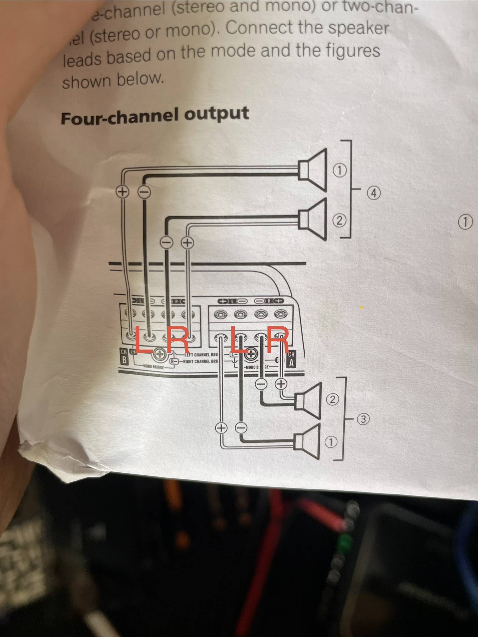

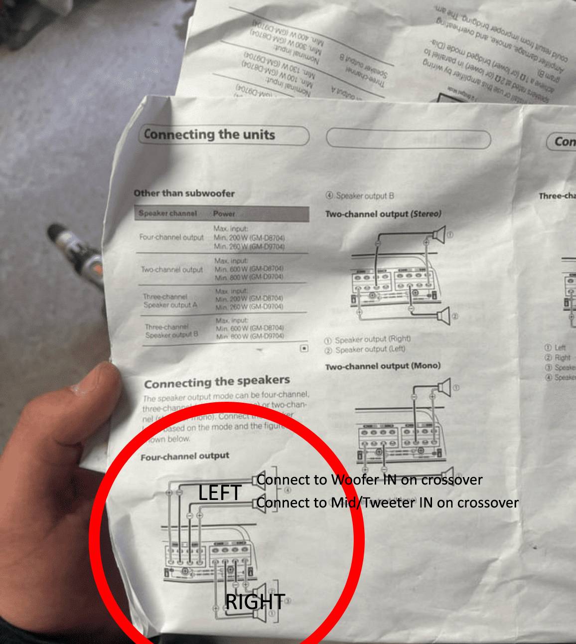

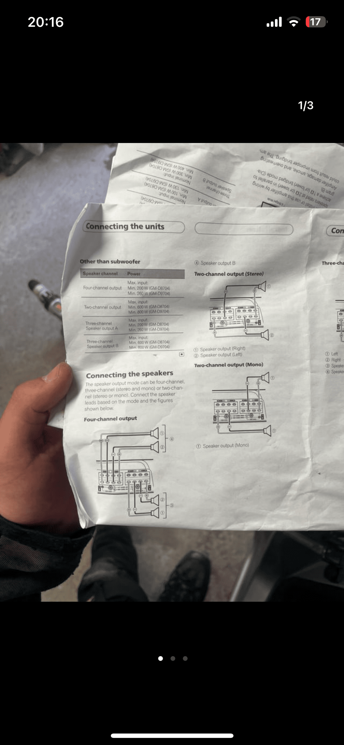

Yes... just make sure you do the same for the right channel.

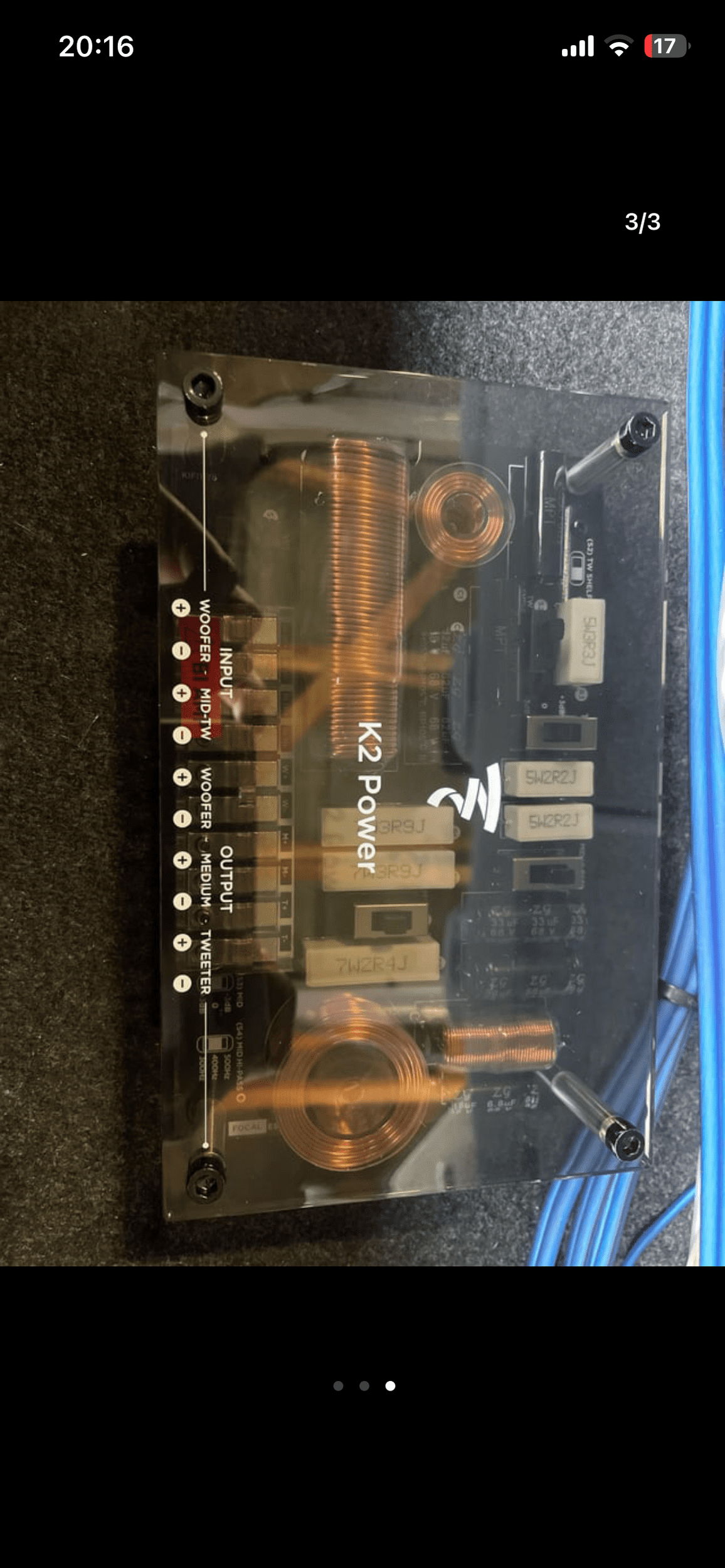

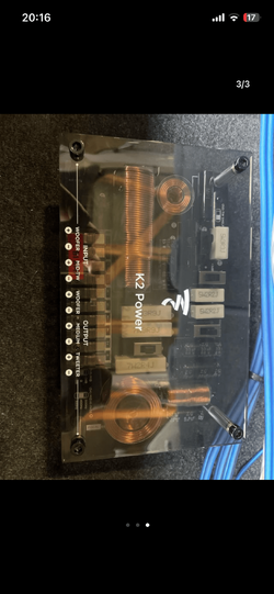

Thank you very much but does it matter how they already are market up left and right, the first picture didn’t show it clearly

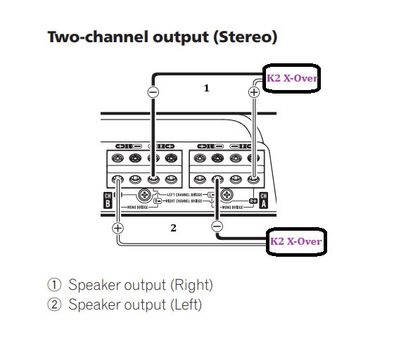

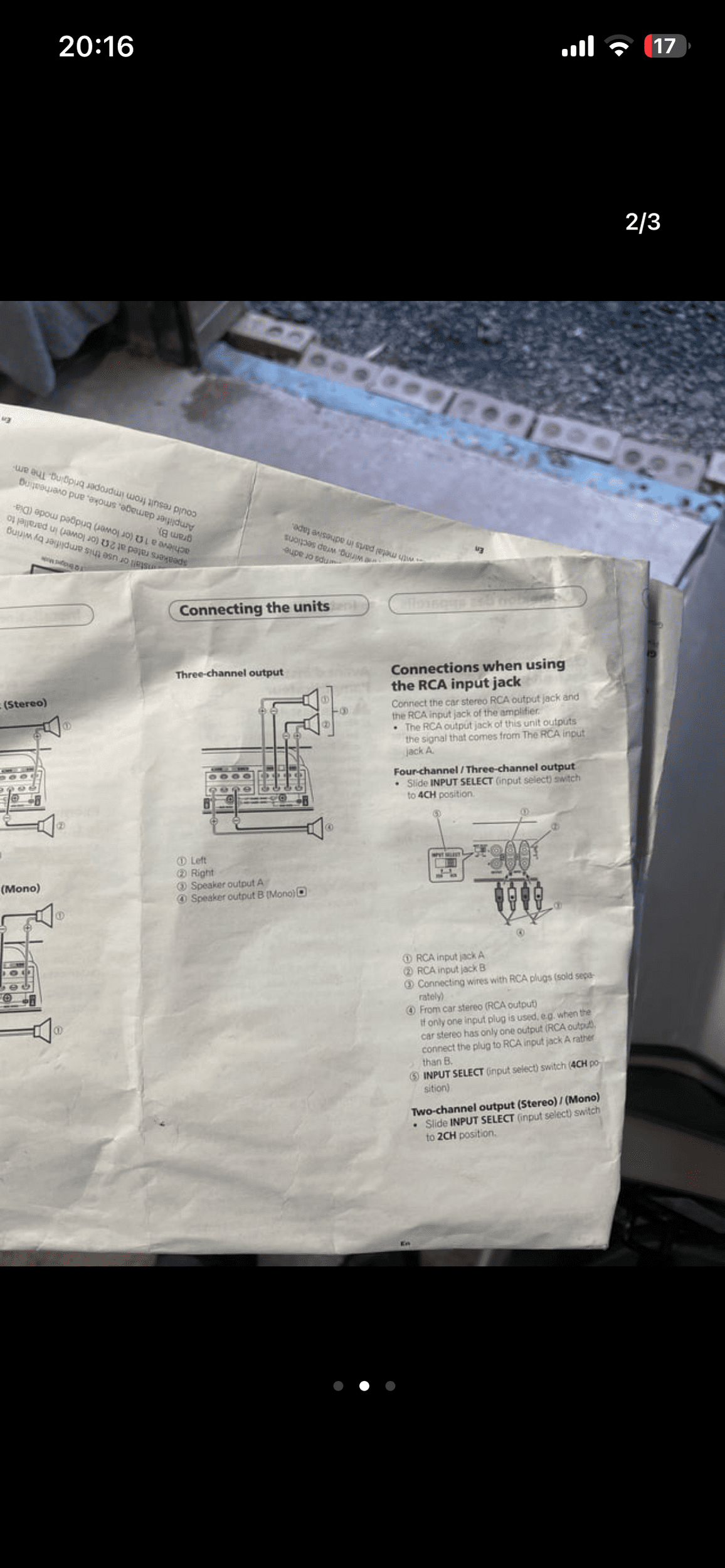

I'm going to suggest that you don't bi-wire/bi-amp at all.
There are times when this is a benefit, say when you're going active. I would bridge whichever 4-channel amp and run the crossovers using the normal input; you won't hear the difference in a car.
The reason Focal does this is for staggered multi-amp configurations where you're actually using two different amplifiers with different output power, say 150x2 for the midbass and 75x2 for the mid/tweeter setup.
You would benefit more from running the 4-channel amp in bridged mode and feeding the two sides a straight 300x2 instead; let the crossover distribute the power.
Seriously, this will provide you with a much better outcome.
Otherwise, you're just leaving power on the table.
Thanks man, so literally just loop the woofer input to the input of the mid and tweeter
Thank you very much
