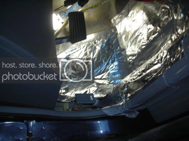

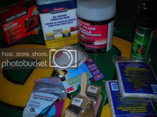

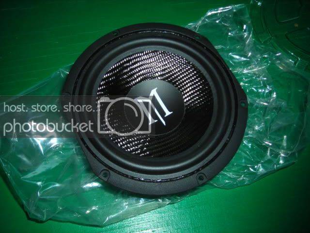

Ok, so my 2 sets of the Mpyre M65 came in so I decided to get started on my kick panels. Im looking for suggestions and recommendations because I dont have the slightest clue as to what im doing. But what the heck right? Projects are fun!
IM CURRENTLY IN THE MARKET FOR TWEETERS SO GIVE ME SOME SUGGESTIONS SO I CAN ORDER ASAP!

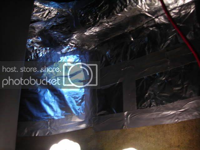

I just put the foil up today and Im going to lay the glass tomarrow. Ill have more pics tomarrow

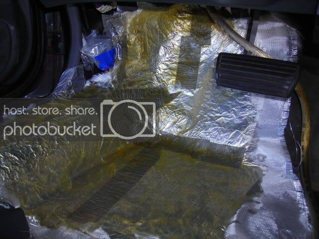

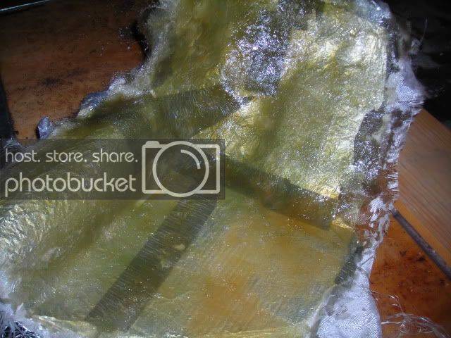

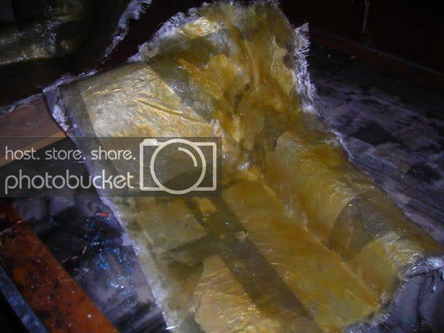

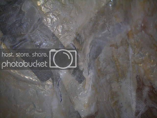

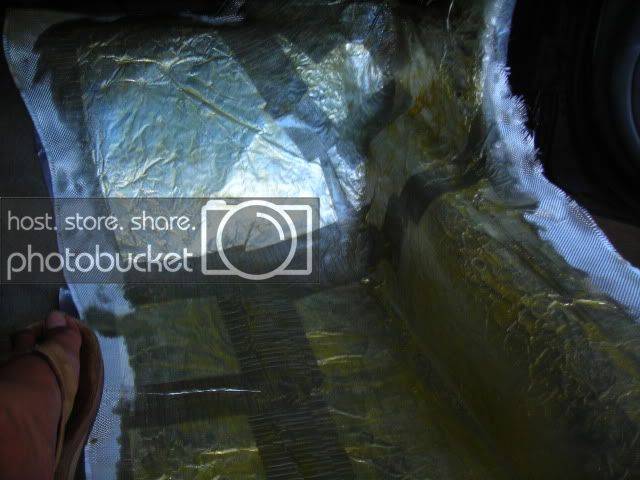

layed the glass and resin today. I used the cloth as opposed to the mat. I was wondering should i add another layer or glass to ensure toughness? I dont want to be kicking myself down the road
theirs just a single layer or cloth. You can see the thickness of it around the edges where it didnt get resin.
I think your just looking at the scrap around the edge that didnt get resin.

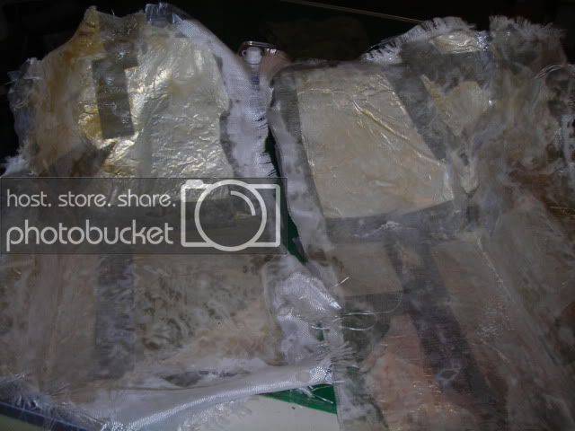

Ok the mold dried and i took them out and sanded out the air pockets and extrusions so its was perfectly smooth. I layed like 4 or 5 more layers to ensure toughness. note to self: wear jumpsuit when sanding.
Is the cloth portion of it actually part of the finished fiberglass product, or are you just suposed to use the cloth + resin as a mold and discard it after you lay fiberglass?
What are the steps to fiberglassing.. ?
Holy lord man, are you building kicks or sub enclosures? Those things are huge //content.invisioncic.com/y282845/emoticons/smile.gif.1ebc41e1811405b213edfc4622c41e27.gif
