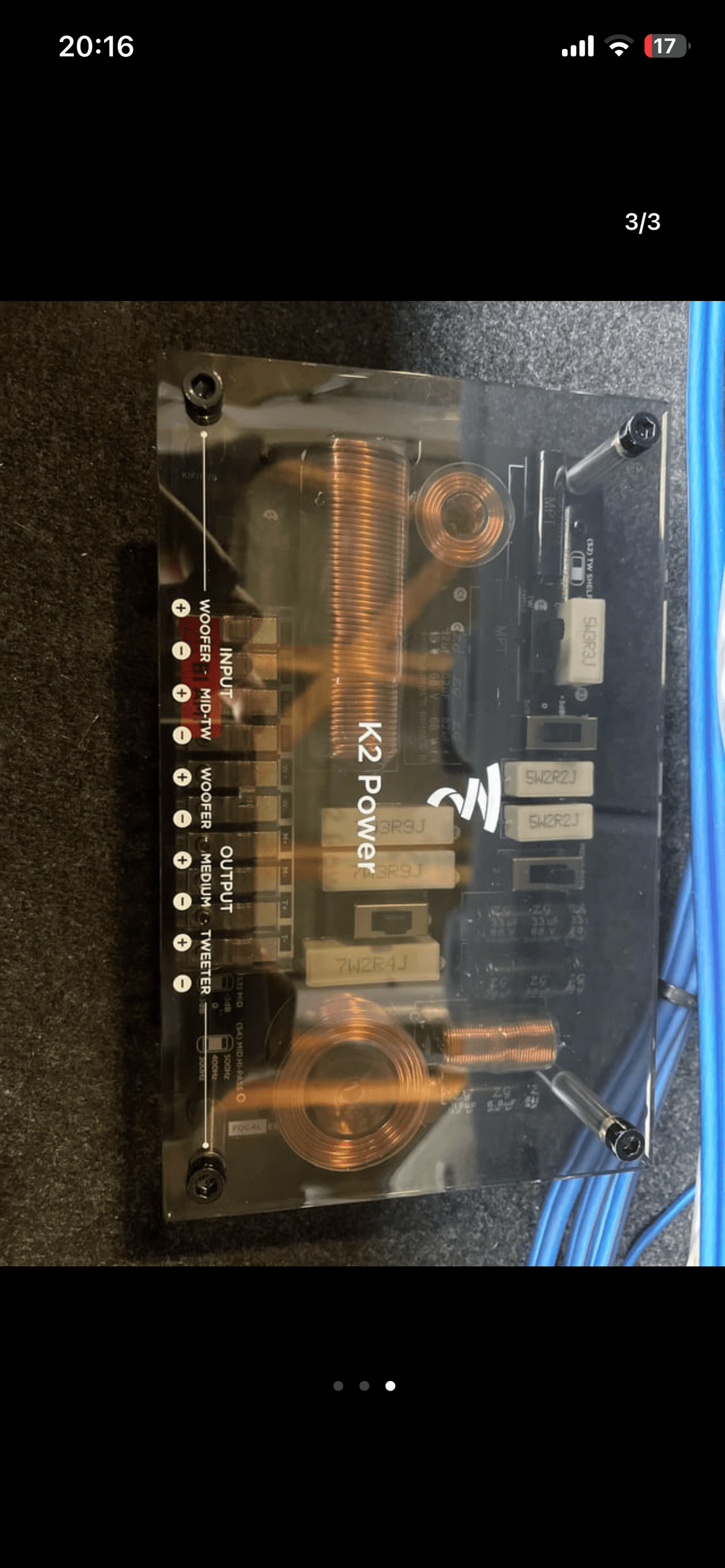

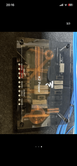

How would I Bi these with my 4 channel?
To bi-amp your speakers with a 4-channel amplifier, you'll need to follow a few steps based on the provided diagrams. Here's how to achieve that:
### Understanding Bi-Amping
Bi-amping involves using separate amplifiers or amplifier channels for different frequency ranges in a speaker system. Typically, this means using one channel for the lows (woofers) and another for the highs (tweeters).
### Steps for Bi-Amping with a 4-Channel Amp
1. Identify Speaker Connections:
- Confirm that your speakers are bi-amp capable. They should have separate terminals for the woofer and tweeter.
2. Wiring the Speakers:
- Connect the woofers to one pair of channels on your amplifier (e.g., Channel 1 and Channel 2).
- Connect the tweeters to the other pair of channels (e.g., Channel 3 and Channel 4).
3. Select Amplifier Mode:
- If your amplifier has a switch for selecting between 2-channel, 3-channel, and 4-channel modes, ensure it is set to the 4-channel mode for this configuration.
4. Input Connection:
- Use the appropriate RCA cables to connect your head unit's output to the amp's input. If your head unit has a dedicated output for front and rear speakers, utilize these outputs to connect to the respective channels you set up for woofers and tweeters.
5. Setting Levels:
- After physically connecting everything, start your vehicle and play some audio.
- Adjust the gain settings for the channels as necessary. Generally, you'll want to have lower gain on the tweeter channels compared to the woofer channels, but make adjustments based on your listening preferences.
6. Check Phase and Polarity:
- Ensure that the polarity is consistent for both the woofers and tweeters across all channels. This avoids phase cancellation and ensures optimal sound quality.
### Final Check
  • Make sure all connections are secure, and double-check for any short circuits.
  • Test with audio to ensure everything is functioning as expected.
If you have specific questions about wiring or settings, feel free to elaborate. Let’s get more members to share their experiences or provide assistance as well!
