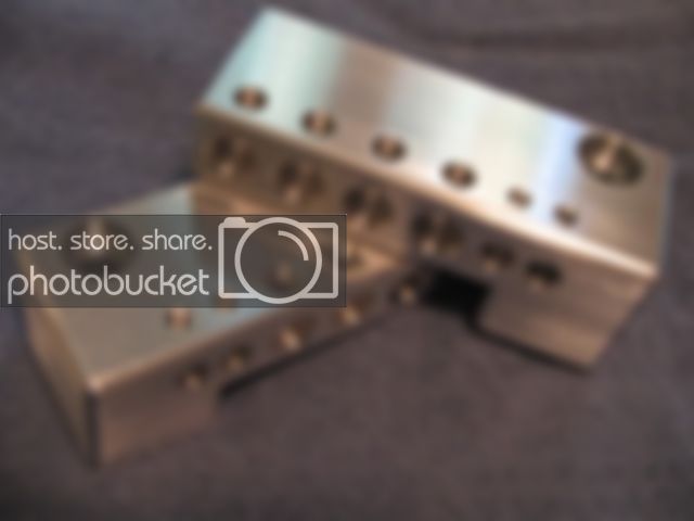

  • My new custom made terminals from ToolMaker are done and I can not wait

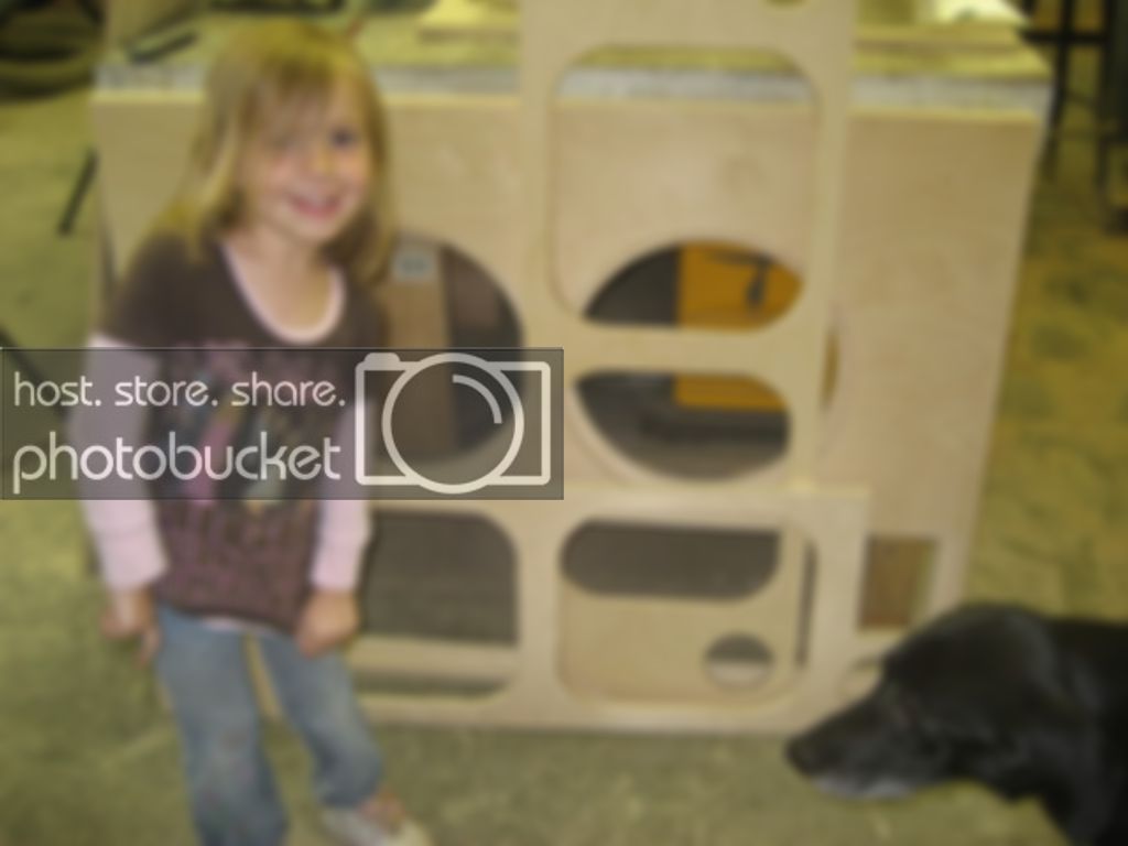

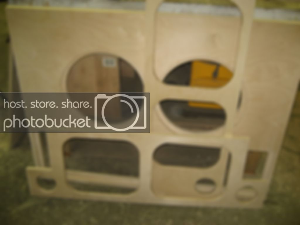

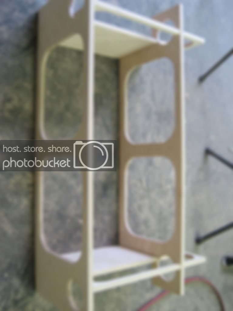

Then onto the box which will be my pride and joy. John at AE helped me run transfer function tests to find not only the transfer function but which configuration would be the loudest for sub and port displacement. After rigorous testing subs up, port up is the verdict. That way I can have maximum airspace and not worry about my port too close to the hatch. Also 43hz and 55hz were the peak frequencies. John helped me design up the box so I have ten cubes all below window line. Interchangeable ports, two are slots, and one is a set of 4 aeros. Today we made all the bracing necessary and the top two baffles. We used all 8 ply baltic birch, everything was cut on the CNC table. I then went over each part with a 1/8" round over and a circular sander. I will let the pics do the rest of the talking, and try and get a vid of the CNC table in action, man is that thing help a bit.
Terminals from Toolmaker

CNC starting on bracing
Finished
Any box builders dream

Some bracing together
Top over bracing

Awesome terminals, and that CNC is sweet, makes everything so much nicer. That's how John made my tweeter mounts for my Jimmy, using the CNC.
Wow, nice terminals...ToolMaker is a guy on here? I need something similar...
He may be on here but he is on a few other forums as well, if youd like his contact info hit me up.
