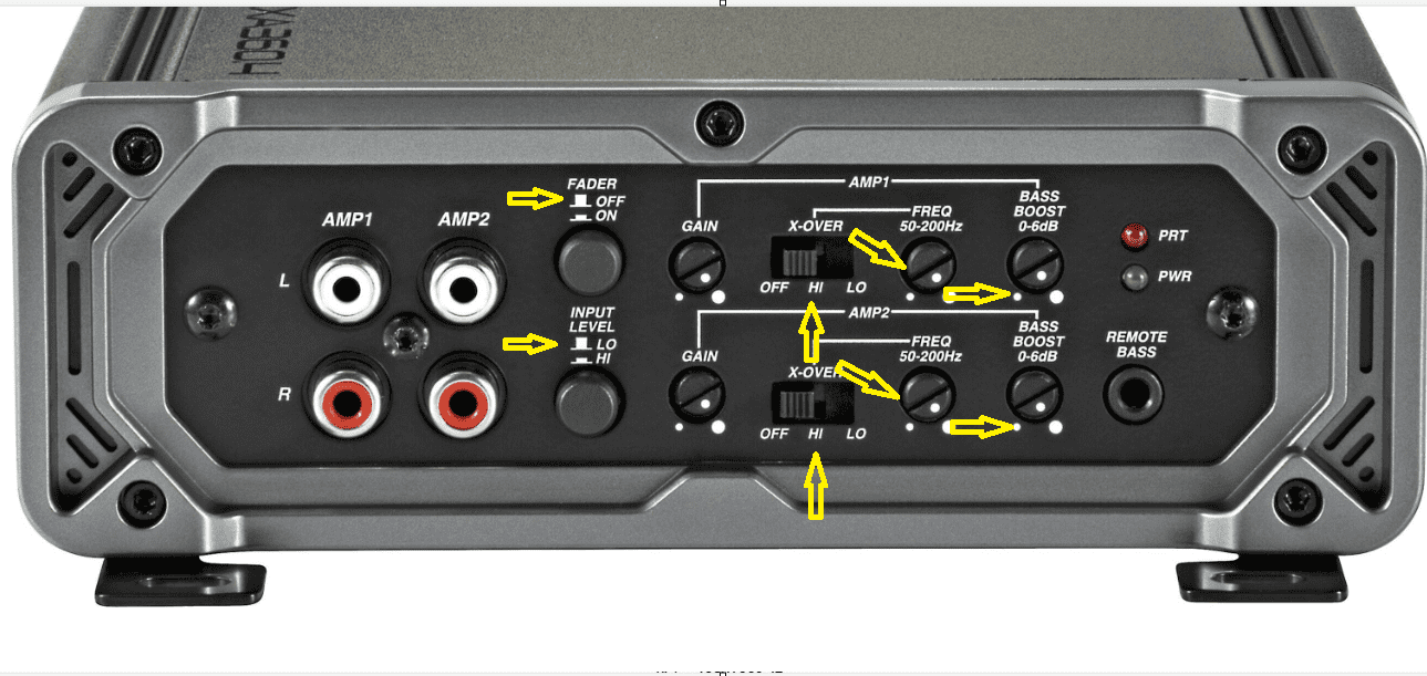

Option 1, Passive setup.
You get one of those 6-channel RCAs or use 3 sets of ones you already have and run it passively (using the crossovers you already have installed) as follows.
Front-R/L and rear- R/L RCAs to the four inputs on the Kicker amp. Red is right, the other is left, front and rear designation doesn't matter in this configuration, but you should still make a note which is which for the other option, running the system actively crossed, bypassing your installed crossovers.
The remaining RCAs on the pioneer HU are designated for use with a subwoofer. Run those to the low-level inputs on the subwoofer.
This is the easiest way to set up your system, as it is installed right now.
The 4 channels of the amp are now getting a signal, so you will set the kicker amps' crossovers to so you hook set the crossovers as follows:
And wire your two speaker leads from the amp to the L/R speaker leads as follows:
Run the subwoofer cahhnel outputs from the head unit, set the HU EQ filters as follows:
LP of 80Hz and a HP as low as you can unless the sub is ported and you know the tuning frquency of the port, then its's 1/2 octave below the tuning frequncy of the sub.
This IS the way to utilize the best sound, best ouput to the comps usinfg the supplied crossovers - and no Sony crossover at all.
You could also set the amplifiers crossovers to off and use the head unit to set the HP filters at 60-90Hz, depending on what sounds best, this is even a better way.

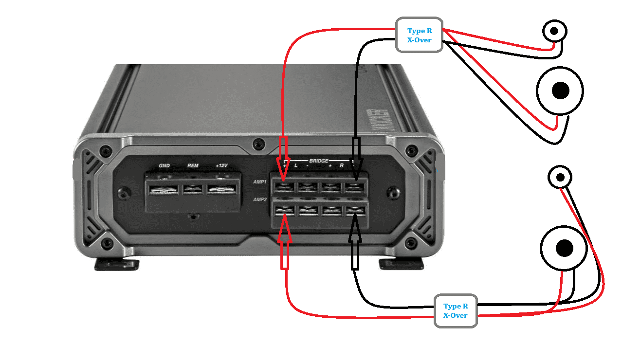

Now for the other option.
You do have the option to bypass the crossovers since they are mounted outside, where you can access the wires leading to the midbass and the tweeters, which allows you to bypass the crossovers altogether.
While this option requires the same head unit-to-amplifier connections, it does change all the settings.
In an active setup, you would designate one set of channels (say the front R/L channels from the HU to amp 1 L/R as the tweeter channels, set the crossovers in the head unit for the tweeters, run 20uf capacitors inline to the positive lead on the tweeters, and instead of bridging the amplifier, you would then ru n a new speaker lead to the crossover and instead of running the tweeter off the crossover lead, you would take that lead and splice the new wire lead from the amplifier and run the tweeters individually amplified as the HU designated F/R channels (there is a reason this is important asside from the crossover setting you will need to use in the HU).
I could not figure out the x-over points Alpine uses for those comps, but I am familiar with that tweeter, and I would set the HP filter using a Linkwitz-Riley, if it's available, otherwise whatever 24db the Pio offers, setting the HP filter, x-over point at 3.5k.
Then you take the remaining RCAs from the HU, the L/R rear channels, and run them to the respective L/R amp 2 inputs on the amplifier.
Then remove the lead going to your crossovers, remove the lead coming off the crossovers to the midbass drivers, and splice it into the wire going to your L/R midbass drivers in the doors. Set the head unit where you want the LP to cross over, use Linkwitz-Riley (or what's available) crossover type using a 24db slope at 3.5k for the LP filter on the 5.25 drivers.
And set the sub accordingly.
This is the optimal sounding setup.

Each driver is individually amplified, individually crossed, with minimal equipment in the middle; this is the best SQ way to set up your system.
The other advantage this provides you is the ability to control all four drivers independently, from the menus in the head unit, at your fingertips.
It also allows you the very important ability to time align your setup, just a much better option than just getting it "to play" something.
There is another option too, using the amp bridged solely to the 5.25" drivers and using a pair of the HUs speaker leads to power just the tweeters.

Let me ask you this: I am currently running the Type R 5 1/4"s at 65W RMS MAYBE because I am only using one side of the 4 channel amp.
I have more headroom in the speakers now that I have the Pioneer hooked directly to the amp. I think I am running into distortion because there is too much bass getting into the speakers - hence the need for a HPF crossover.
Let's say I am running the crossover at 125hz or 160hz or whatever with the maximum decibel dropoff.
If I am still getting distortion through those components as in vocals getting muddied and drowned out, etc ("What If" by Creed is a banger I use to tune with) HOW AM I EVER SUPPOSED TO RUN THOSE THINGS AT 100W RMS WHICH IS WHAT THEY ARE RATED?????? Clearly those little speakers aren't designed to handle bass frequencies at 100W RMS. BUT they are designed to handle SOMETHING at 100W RMS right??????
My point is these things SHOULD BE BEGGING FOR MORE at 65w RMS. 65w RMS SHOULD BE A WALK IN THE PARK FOR THESE SPEAKS RIGHT???????
