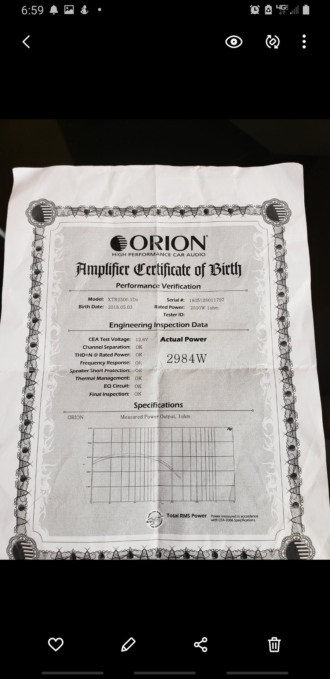

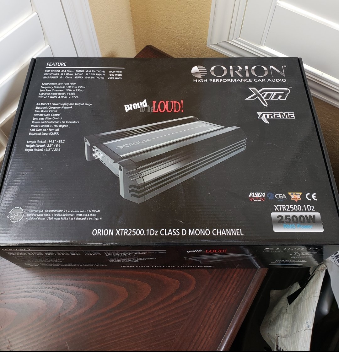

You’ll need a solid 2500 for sure. The Orion looks decent
I had one but sold it. Everybody told me that my Bug couldn't run it. It was over 2,980 on the birth sheet.
