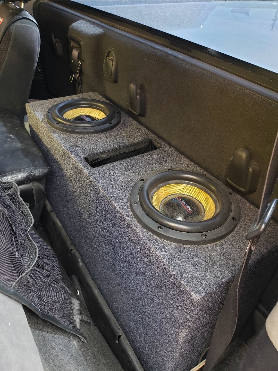

So, do you think the 4 VFL8's on a Smart 3K is worth the build? Or, is it not worth the time and money? I just thought that 4 good 8's on a 3K in a standard cab would be different.
It should hit pretty nice .. wired at 2 ohms. A pair of 10s in 4.0@32 htz on 1700 rms @ 2ohms Mono,just about destroyed my roof in my CRV when I ran it
I think so, the air space might be tight. Maybe, .75 for each sub. View attachment 25212

I'm not going to wall a standard cab truck. I can fit a 3.8 cubic foot box behind the seat without any modifications. That should be big enough for four 8's on a 3K.

4 good 8's in an easily removable box on a Smart 3K is enough for me.
I was not talking about doing a Wall. Especially four 8" subs.. Thats pretty retarded man. Im talking about removing that back useless panel to give you a little more of a FLAT area to work with for the enclosure to get it Flush with the back wall giving you a little more room behind the seats. Be a great Idea to deaden that back wall also while your at it. You can also get some height to work with to get closer to a well tuned enclosure
I think that I can just remove the clips on that back panel and get 4-4.5 cubes, which should be enough. I'm figuring .75 for each sub = 3 cubes. Speaker displacement at .10 x 4 = .40 cubes. So, 3.4 cubes plus whatever cubes the port needs. My installer wants to tune it to 32 hz. I was thinking 35 hz.
I think 35 would be ideal for those 8s myself. I would recommend Deadening that back wall.. From my experiences, the Vibration of that wall is a nasty outcome of noise
