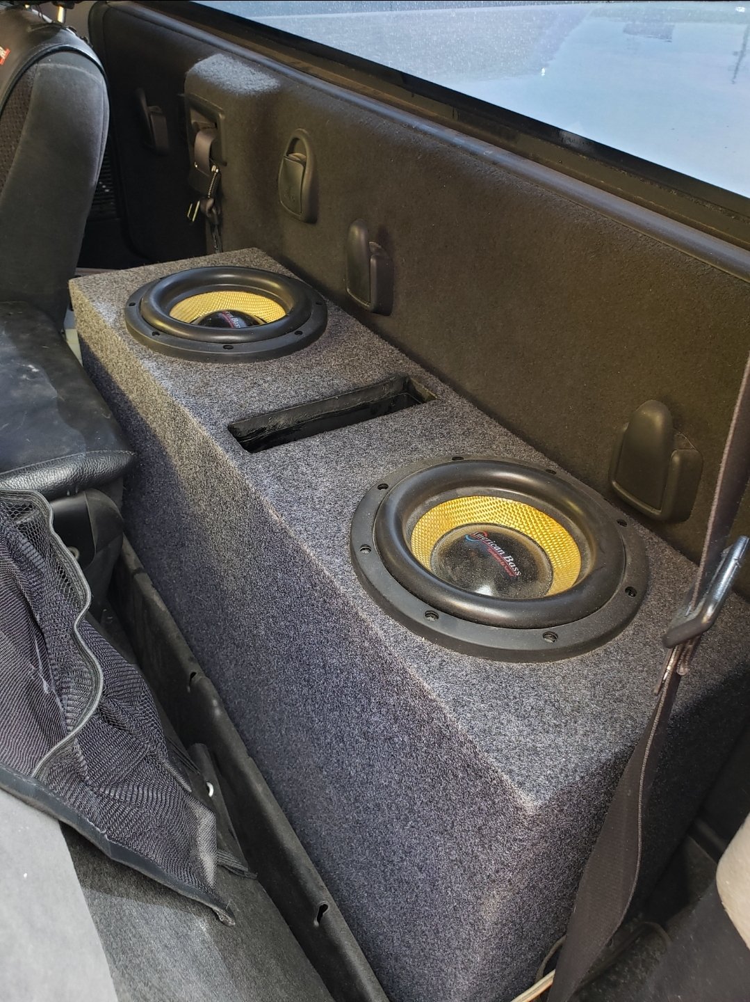

If you want to meter super high on a 40 hz test tone, 4 cubes at 40 hz is a good box, but that is way too peaky even on music for me. they will murder a 40 hz test tone though. You should build it both ways man. Test them out and post some vids.
For music mind you. I’m not talking about hitting numbers on test tones.
I'm currently running these behind the seat on a DD M80 (900 watts @ 1 ohm). VFL8's
My builder wants to build it tuned to 32hz. I thought that would be tuned too low for 8's.
If your going to throw that type of wattage at them, I’d definitely lower the box size some, and do a big *** port tuned in the low 30s. I don’t want to override your box builder here Bobby. Maybe he has done 200 boxes for these specific subs. I’ve done 3, and I’m not the one listening to them every day. I have the Dayton ultimax.
For some reason he wants me to go Korean for the bass amp. I don't to spend $550 on the Twisted Sounds 3.5K. I think the Smart3K is tge better choice. Otherwise, I will buy an Orion XTR2500.1dz. Any thoughts?
