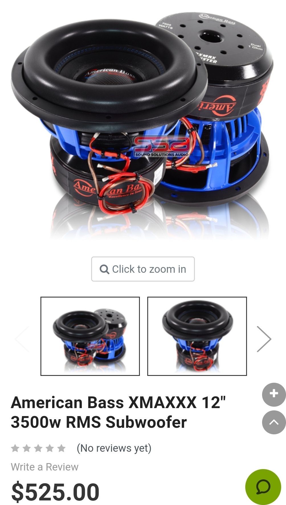

If you switch to a 12". 3,500 RMS.
Look at that nsv...The increase in motor depth On it or any similar 10” May present more challenges/limitations with a new enclosure than improved output result and you will still need a bigger enclosure. Consider Grabbing another 10w7 and switch to a Brazilian full bridge. You’ll still need electrical upgrade but not as much as two half bridge amps that will crush your Tacoma electrical. Or switch to two 1k rms 10’s in 3-3.5 cubes ported on a full bridge amp and it will blow that w7 10 away. Probably just about the same price since both scenarios are going to require a new enclosure, another/new amp, and new/additional subs.

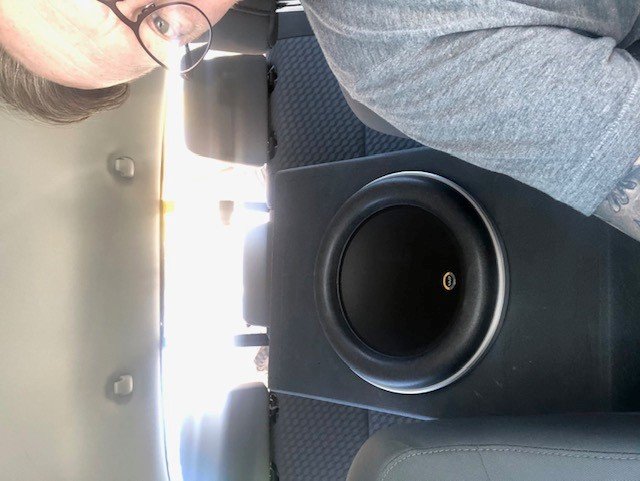

Yeah I'm well aware of the costs involved and what it takes to support a good system. Alternator, wiring, batteries, etc !!! I'm coming from a walled Tahoe with 2 18's lol....I guess I'm wanting to have my cake and eat it too. My enclosure is very good so I don't want to change that and sacrifice back seat space.
Yeah I'm well aware of the costs involved and what it takes to support a good system. Alternator, wiring, batteries, etc !!! I'm coming from a walled Tahoe with 2 18's lol....I guess I'm wanting to have my cake and eat it too. My enclosure is very good so I don't want to change that and sacrifice back seat space. View attachment 22182
Understand, all makes sense. Is that box sealed though? That’s going to make a significant difference going to ported
