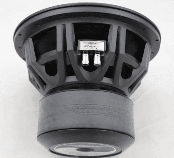

Is the big 3 upgrade necessary for an IDMax 12 and a 1000W mono amp?
ID max 12 on a 1000w mono budget amp? Not necessarily but I would personally if the amp wasn't so budget. Big 3... really? I don't run bs amps to expensive subs but that's my thing. A $400 dollar sub needs close to double that in electrical/amp to perform and that don't count the expense of the enclosure and other associated costs.
You want performance on some budget but some things cant be cheaped out on man...
I'd run a 1500w amp on one of these and be grinnin'. Something like a RF Power T-1500. Whether your after sq or whatever you'd have cone control. Either way a "Big 3" upgrade is a no brainer.
It would depend on the efficiency of the amplifier
Typically I would recommend yes
with 1000watts you may not need it immediately but maybe factor it in to your to do list
