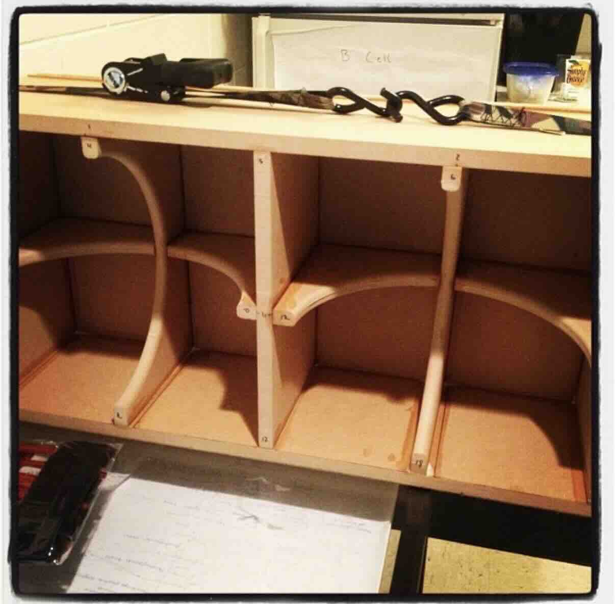

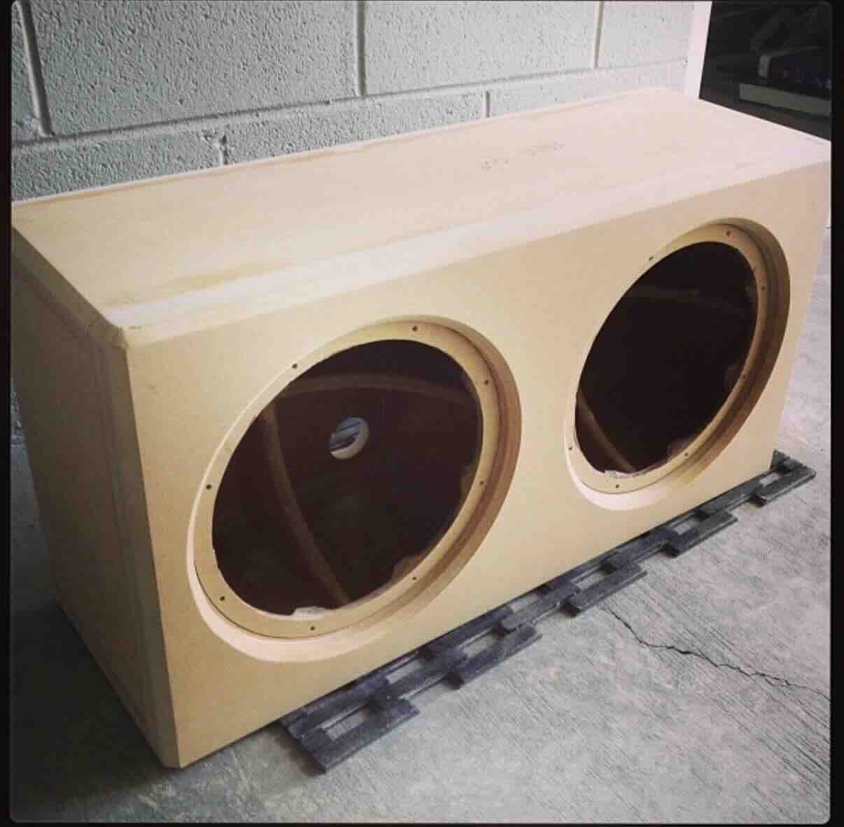

I was thinking getting 1/2" MDF and doubling up to get 1", because it's much easier to cut the with a router. Maybe use 3 layers for the face of the enclosure. My last build (see photos) I used 3/4", and I loved the sound, but I remember that 4'x8' huge board was a pain to work with.
