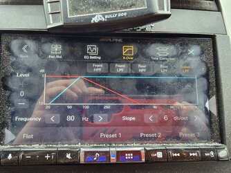

Hey guys! I have a question. My Alpine ILX-507 is confusing me with the slope for the subwoofer. When I go into crossover setting with the crossover flat, when I go to set the slope it now moves to the slopes do like in the provided picture. Please excuse the glare and dirty display. I've been trying to figure this out for two days. I was accustomed to the blue slope would move right to left as the slope was increased now it's left to right.

Red is low pass (subwoofer)
80hz low pass everything below 80hz will pass through anything above 80hz will roll off according to your slope
6db is 6db per octave
a 24 db slope will be 24db per octave
Blue is high pass everything above 80hz will pass through
Everything below 80hz will roll off according to your set slope
