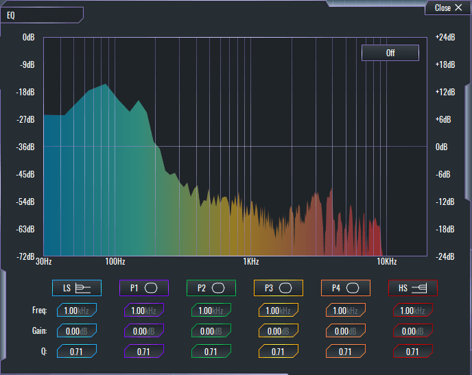

This is a kick drum
It's not difficult to reproduce that range with subs
But you can see how much info goes into the midbass region which is why proper alignment could play a factor
