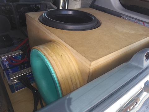

Kinda what I come up with as well. I figured the mechanical limits effect power handling more so than bandwidth... My inquiry stems from my experience with my new sundown 18" U series subwoofer. I am having trouble hitting that sweet spot of 28 to 32 Hz. Ive owned the D series, SA series, and the Z series... All of which seem to love those frequencies. I was thinking it was just the design of the driver with that steep surround and all. I have it in a 3.94 ft3 aero port box with a 6"single port at 28 in2 of port area. As it stands with displacement the enclosure is tuned to 30 Hz

single 6" aero?.. for an 18?
Id redesign and try an 8" aero next time... thats a hi-excursion sub and if you power it right it'll def hit port compression WAY too soon with a 6" imo.
My 30mm xmax 18 in 5.25ft3 or so uses a 10" and gets down tuned 34. (around 26"long)

In 4 cubes a 8" is about right for your application if you ask me.

Thanks a ton for your suggestion to my rather long query, I ll follow it and see how it works out. Thanks again
