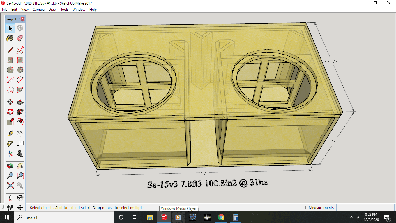

I'd even go so far as to guess that a pair of Xfl-15 would CRUSH a single 18 on your power. A Tahoe? 48"w x 26+"d?... 19" T?... I think 2 lower powered 15's would be your best bet.
That ride is the meat and potatoes of Bassheads.
I've helped /w/ a few. even a pair ol' tired Sa15 will still impress. Maybe not the "best" or world beating results everyone is after but it WILL utilize your power rather well if done right.
