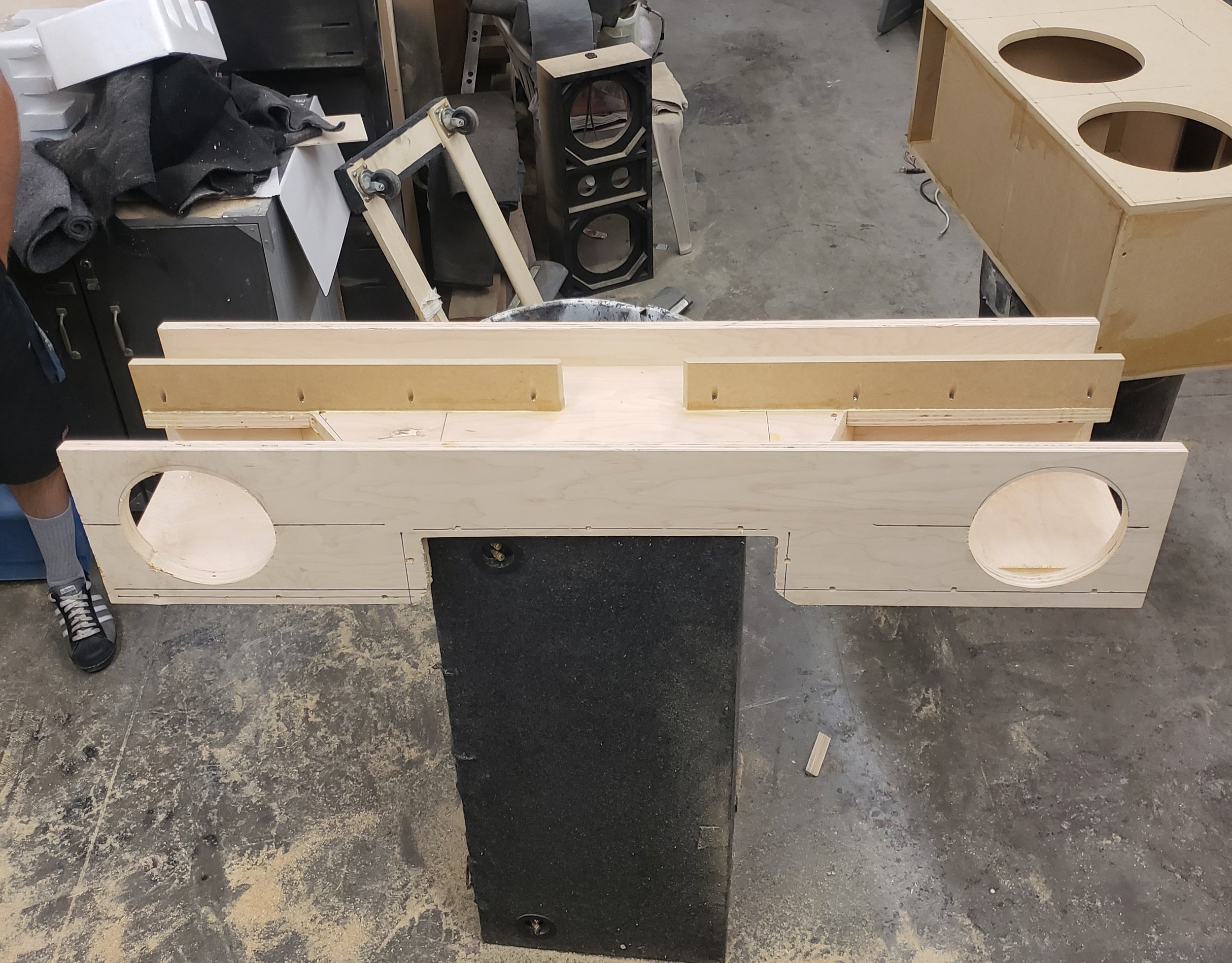

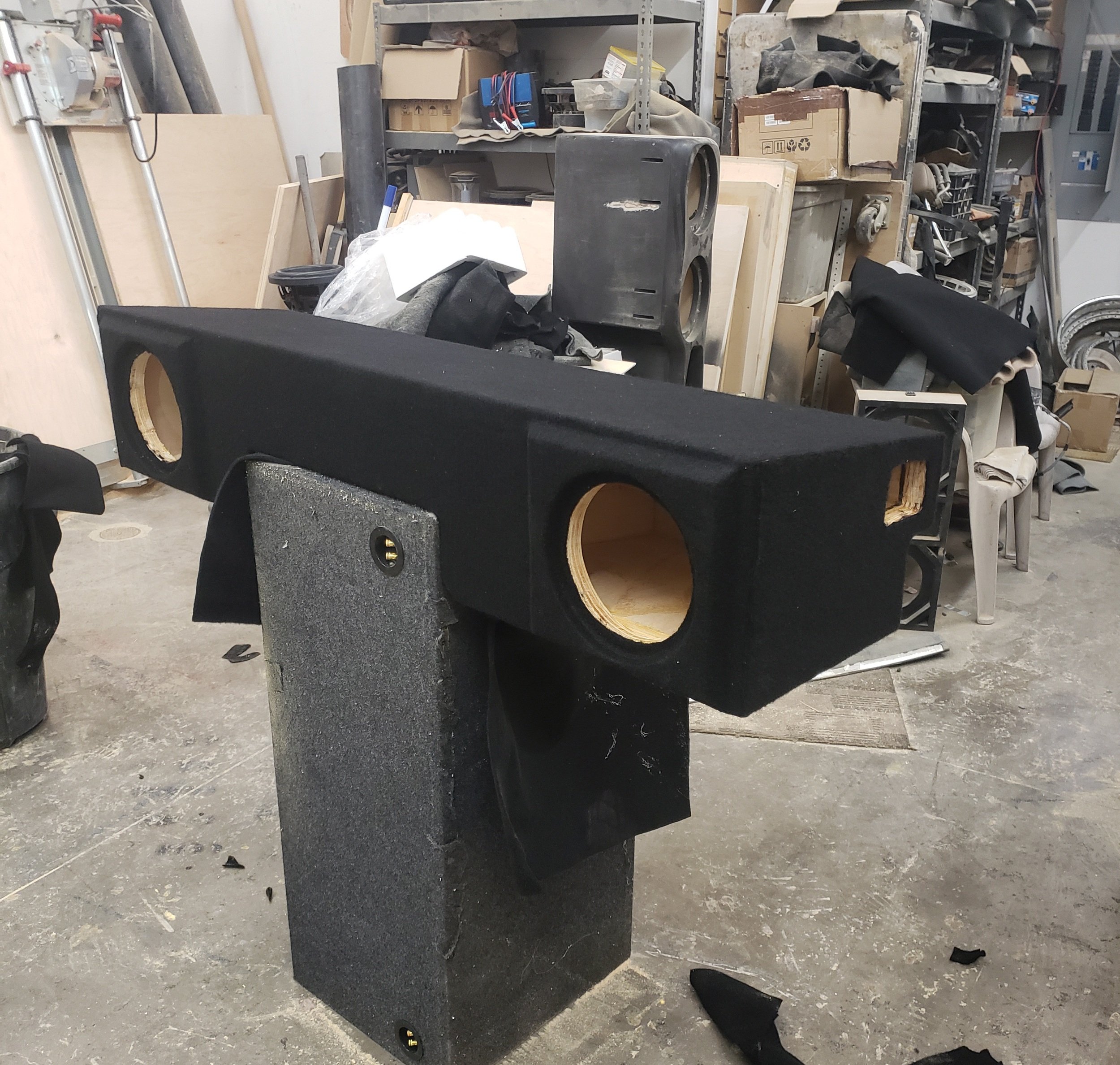

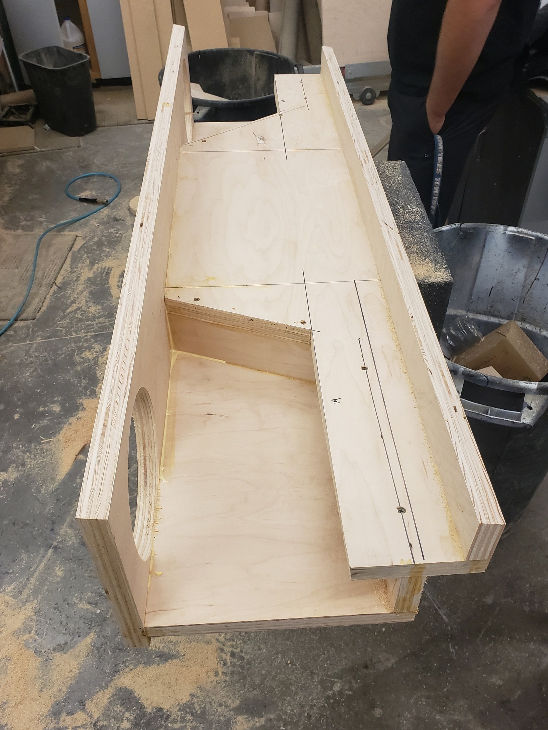

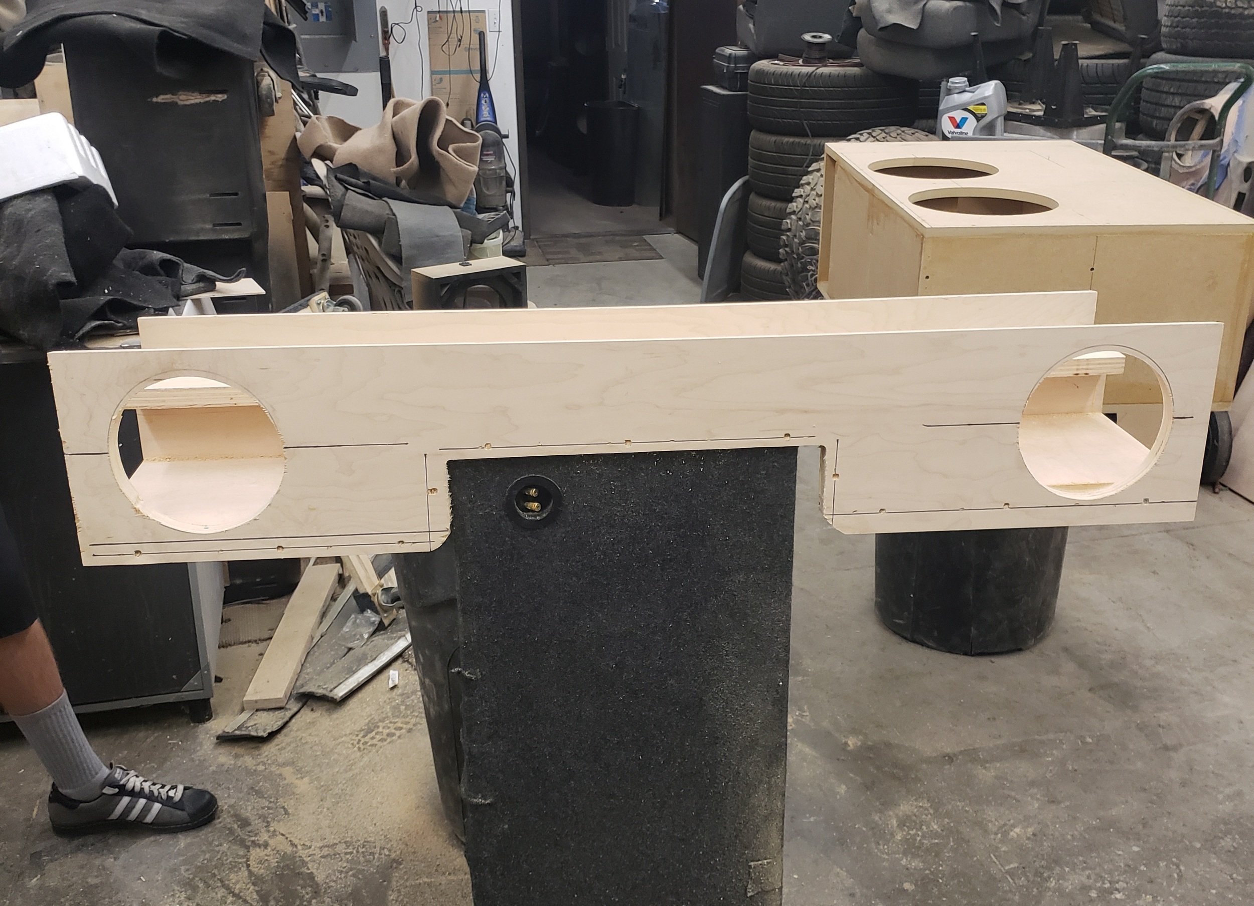

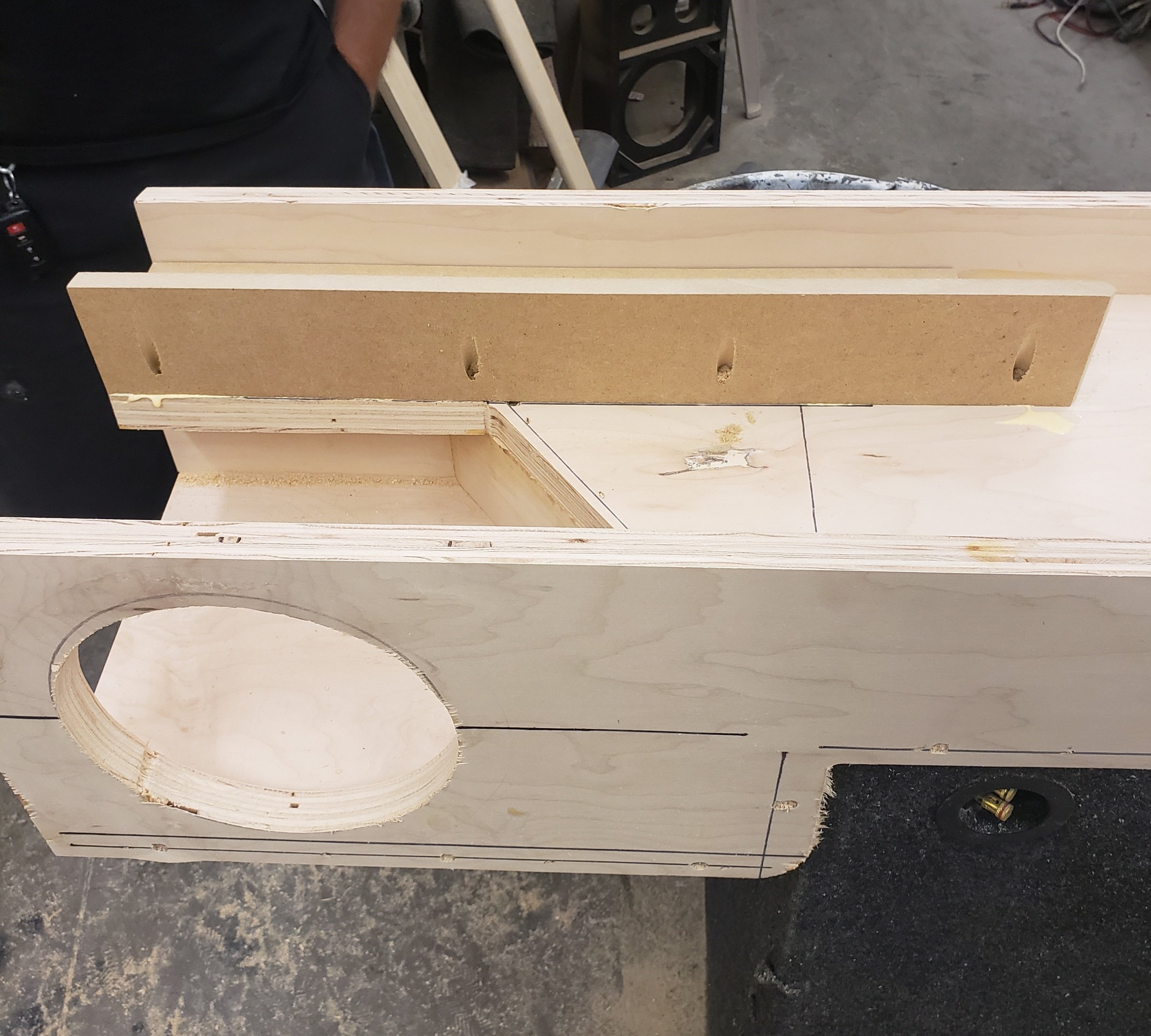

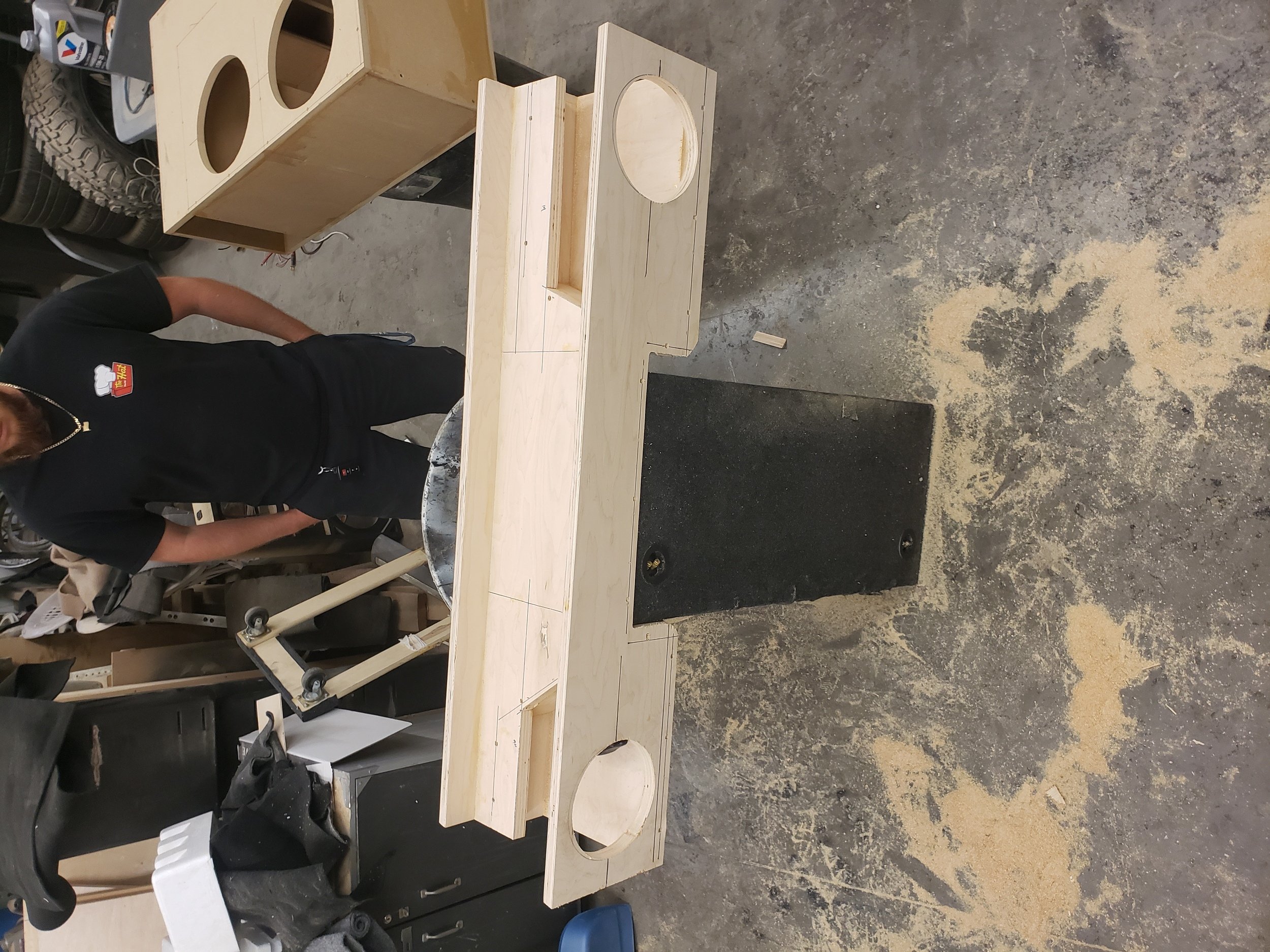

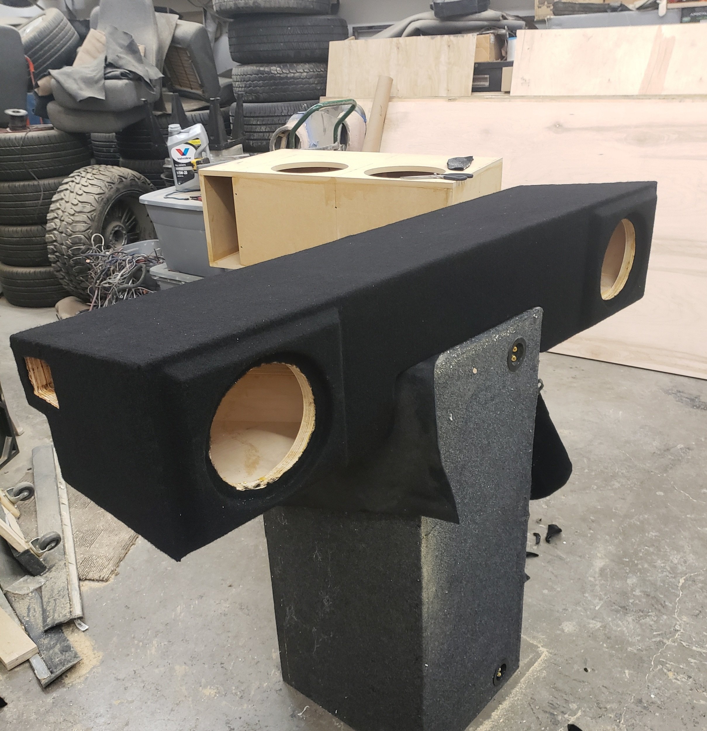

This is about as complicated an under seat ported box can get. This one was for two Sundown X8's. It ported out of both sides. My box builder built it in Vegas. He doesn't use computers. He's been at it since 1983 when he was 13. He built this box in about three hours. Pretty impressive. He used pvc for the aeroprt type ports.
