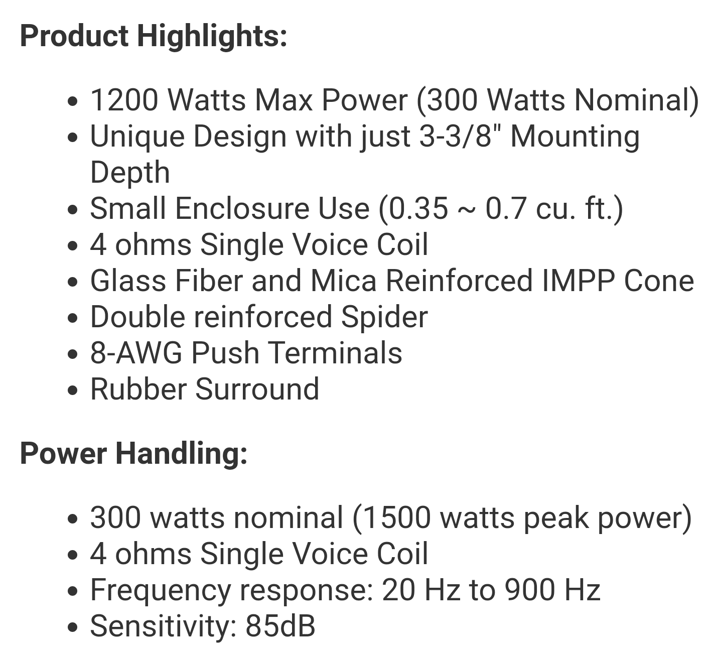

Just not sure how this would work in .9cu.ft
Guy over on DIY has a TS-Z10LS4 for $100
Maximum enclosure is .7, I’d be at .9. RMS is 400 I would be at 300. So wonder how it would sound
Should do good...the slightly larger box should let it play a touch lower and you'd never hear the difference between 300 and 400 watts anyways
