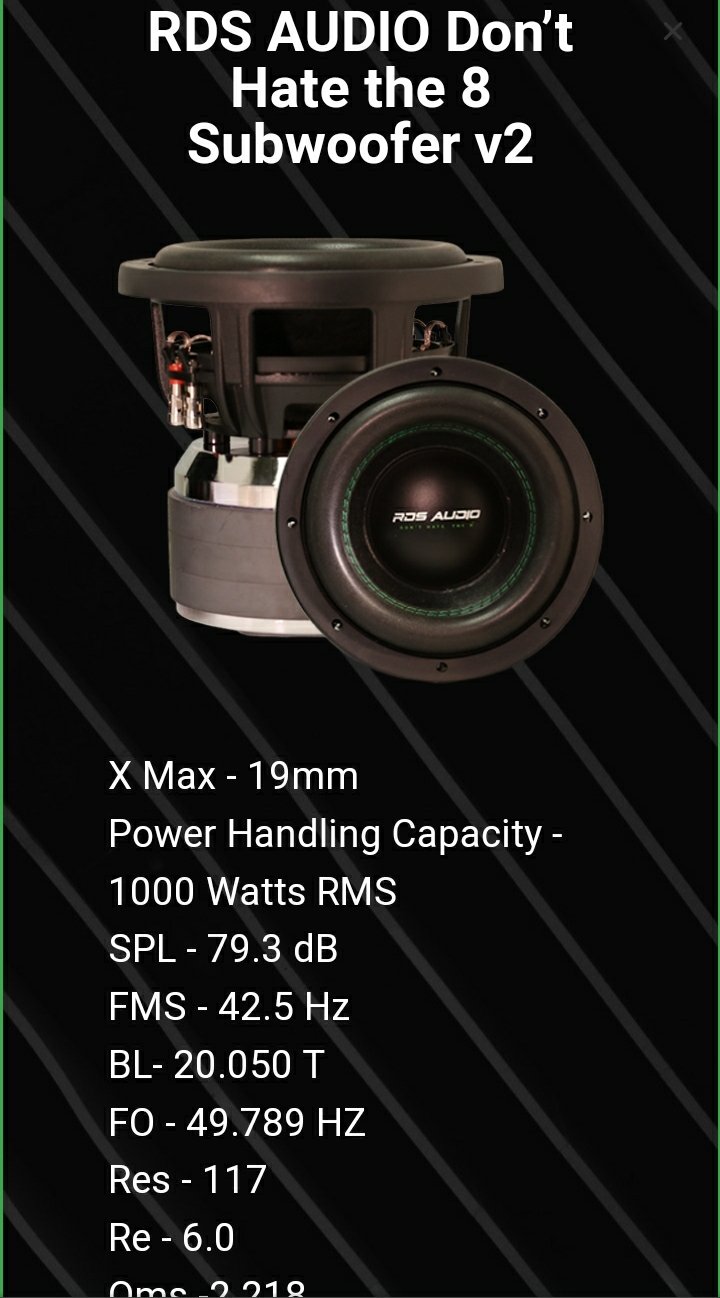

That RDS 8" sub looks nasty. I can't find the mounting depth anywhere.
