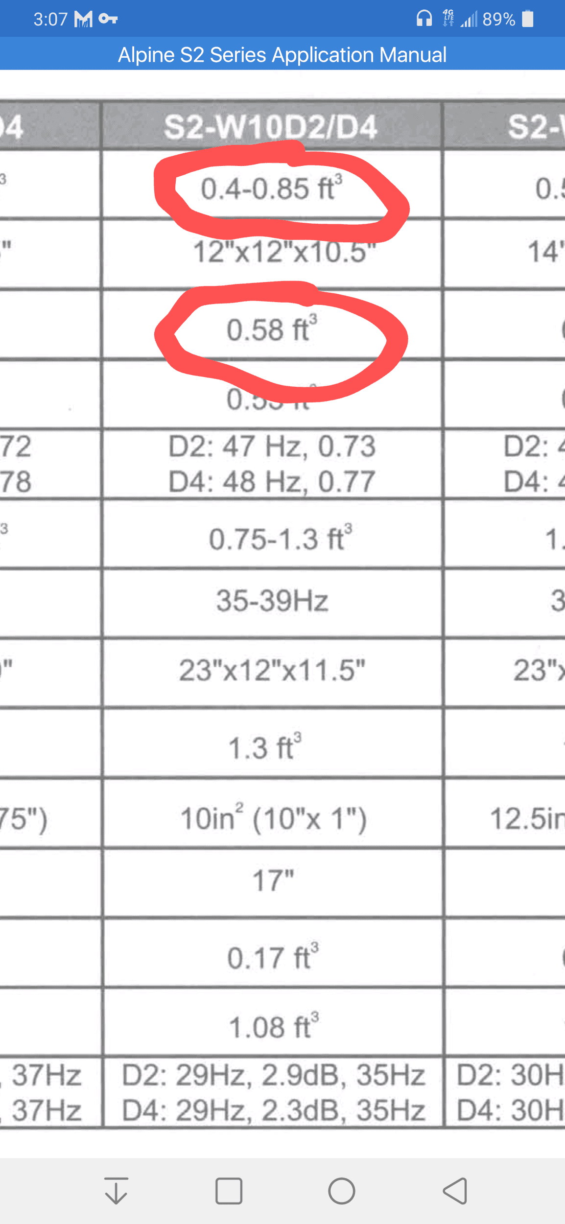

In that case, the Alpine subs that AnthonyO is selling are another great option. They are the Alpine S2-W10D4. The recommended sealed box per sub is 0.4-0.85 cubic feet. So with a sealed box of 1 to 1.5 cubic feet you can mount both subs in it. Being that you have an SUV, the bass will be amplified but with the control of a sealed box.
