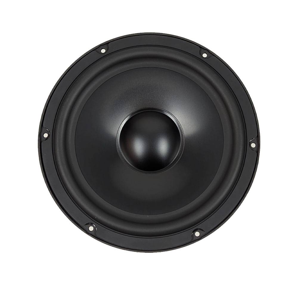

Hello. I have Toyota Camry 2021 with Lexus like rear seats that cannot fold and have metal back. I currently have
3 way active Gladen RS system with 8 inch midbass.
Mosconi pico 8/10
12inch Subwoofer in rear deck turned upsie down powered with seperate amp.
My SUB goes deep easy, down to 20hz, but is having difficulties go above 50Hz, so i need to rely on midbass in door to cover 50-80hy area well.
Problem:
My left midbass driver GLADEN HG-200-SG3 stopped working this week, so I would need to upgrade. link to current midbass https://www.gladen.com/images/glade...GA-200-SG/speaker_data_sheet_-_HG-200SG-3.pdf
I am searching for
-will outperform existing Gladen midbass
- shallow 8 inch midbass (Gladen is 67mm deep, not sure if i have any more space.),
-that can play deep and punchy, covers good 50Hz+ area and
- will be powered ok with mosconi pico (amp details below)
- is able to buy in europe for up to around 500 EUR
    • Output power @ 4Ω:
      4 x 50 Watts (channel: 1 - 4) 3-Ohm stable (not bridgeable!) (i use this for tweeter and midrange)
      4 x 90 Watts (Channel: 5 + 6 / 9 + 10) 2-Ohm stable / bridgeable
      4 x 50 Watts + 2 x 240 Watts (bridged channel 5 + 6 / 9 + 10)
Was looking at:
- https://www.esxaudio.de/english/qxe8.2w.html
- https://www.audiotec-fischer.de/.../compose/i7/ci7-w200fm-s3
Do you have any other recommendations? Thank you!

Unfortunately to expensive to order to EU. With shipping, customs, tax, you are quickly above 700 eur.
I would look at the helix Ci5 S200FM-D2
Over the ci7
The i5 has more power handling and lots more excursion, they are more of a dedicated midbass only playing up to around 500hz but given that you are running a 3way you should be fine
And bonus they are fairly priced at nonsolospeakers in austria
They also come in a 2 ohm version if needed
Agree.
Helix Ci5 for more of a front sub/midbass reinforcement type woofer, Ci7 if you need superb lower midrange above 350Hz with less emphasis on the 60-350Hz passband.
Hertz ML 1800.3 Mille Legend 180mm (7'') driver, very good as well, if you can make them fit,
