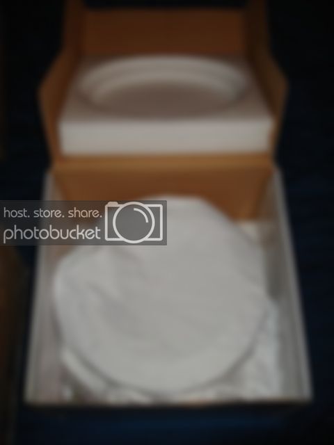

They Are Here!!!!!
I know people have seen all the prototype pics, but these are my subs dog gawn it.
Onto the Strip show
They make a cute couple lol.
and pretty shallow to boot.
Yes I know they aren't the best looking specially with the basket and all but they seem to be pretty nicely built and all. Bout 25lbs apiece.
Will have to see how they fit into the truck and all, probably won't be able to get to that until this weekend though. May have to whip up a small test enclosure just to try em out and see how they sound/break em in. Then when I get time, get a good start on designing and incorporating the other 3 boxes into the center console.
thanks guys. Really nice to finally have them in my hands for sure. Hopefully at least get a little box whipped up in the few hours after work this week. Will have to pick up some more speaker wire and such at some point though. Hopefully get them in and bumping by the weekend though. Will be a while before its permanent though //content.invisioncic.com/y282845/emoticons/frown.gif.a3531fa0534503350665a1e957861287.gif
Can't wait to hear them, its been a while since I have had subs, so will sure be nice.
