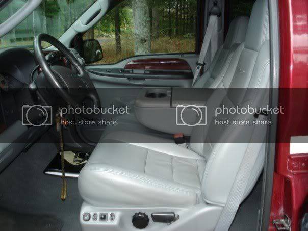

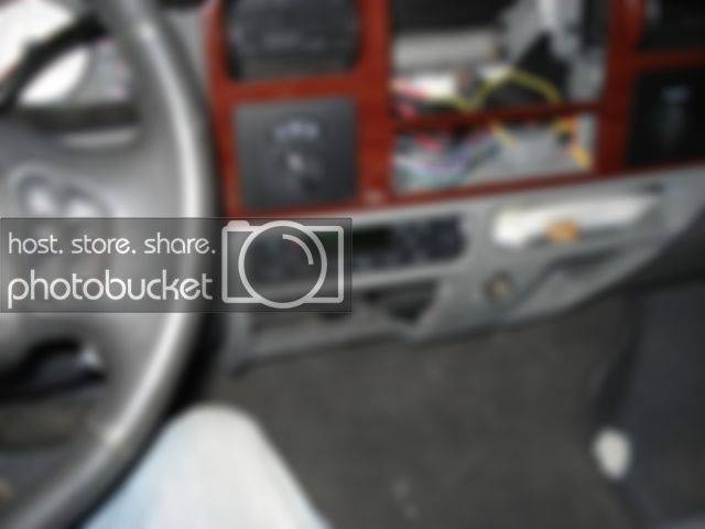

I know I will take some flak but I just got step 1 of 5 done in my install, and for me it was a big step. I decided a while back I wanted to run a computer in the truck and got all the components, and at the same time wanted to keep a standard HU to control the audio and radio and keep things simple. This required moving around a bunch of things in the dash to make room for the 10.4" screen and finding a home for the HU. I'll let the pictures speak for themselves, and hopefully the rest of the progress will come along a bit quicker.
Here is how everything looked before I started messing with it.

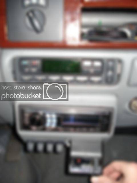

Here is how it looks now...
I am going to have to take it out again to finish up a bunch of wiring and may do some touch up, but for now it works and gives me some tunes again and the open space in the dash to put the 10.4" screen and other stuff.

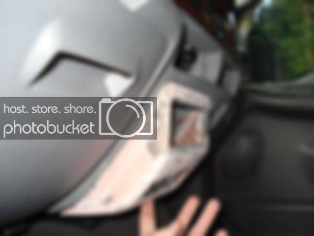

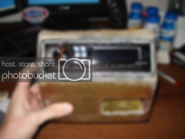

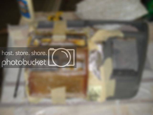

I had made the rough shape out of some cardboard hot glued together and then wrapped in aluminum foil to get the basic shape, then covered it in a layer of FG, then I added in the single din trim ring (trimmed down.) After that I added 2 more layers of fiberglass mat. I think it ended up being about 4 or 5 layers all in total.
All components in and getting close to finishing up the structure and moving on to sanding and getting it ready to finish.The black plastic on the left is for the factory upfitter switches, and the hole on the right is a place to put the trailer brake controller.
The form out of the mold wasn't completely perfect, mostly on the sides, so I wrapped the factory dash piece in aluminum foil got the new piece located and temporarily mounted, then dribbled some resin in around the edges to pick up the true shape of the dash.
Skip ahead to some bondo and lots of sanding, and its starting to look like its going to come out half way decent. Not too bad for my first time ever touching fiberglass.

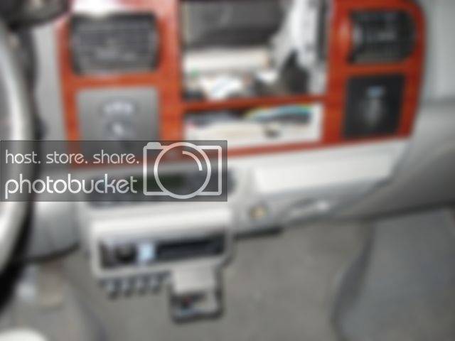

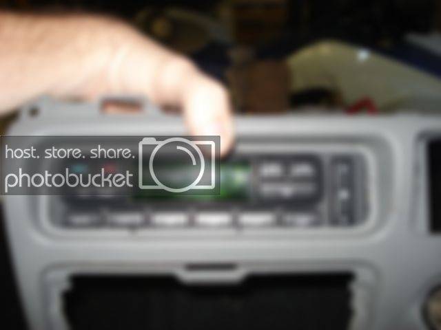

Next step was to move the heater controls from up in the dash to the lower cubby spot. This wasn't too hard since the controls were digital and the wiring harness would stretch to the new spot. Took a bit of dremel work to get enough room and pull it out far enough to be easily visible.
Fine product doesn't look too bad, I most certainly could have finished it a bit better and I may do some more filling/sanding on some spots but from a distance and without them being pointed out its not disgusting.

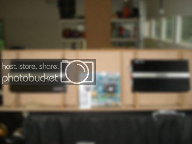

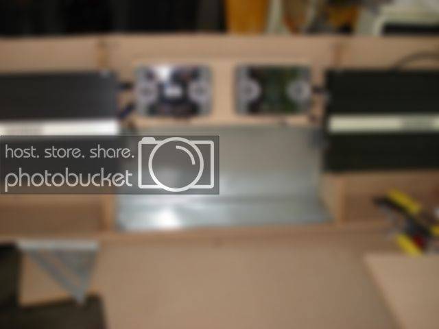

Next step is going to be the amp rack, I am the first steps built and the design pretty much complete. Nothing fancy but pretty much zero room to work with and I want it to look somewhat decent, and getting 2 amps 2 massive crossovers and the computer parts along the back wall is proving to be a little tricky.

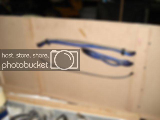

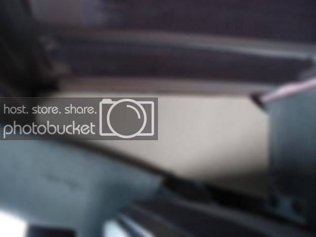

These used to stick out 1" on the bottom, but after some massaging with the dremel they are an even 3/4" all around

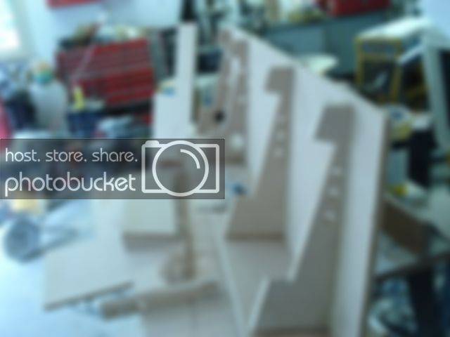

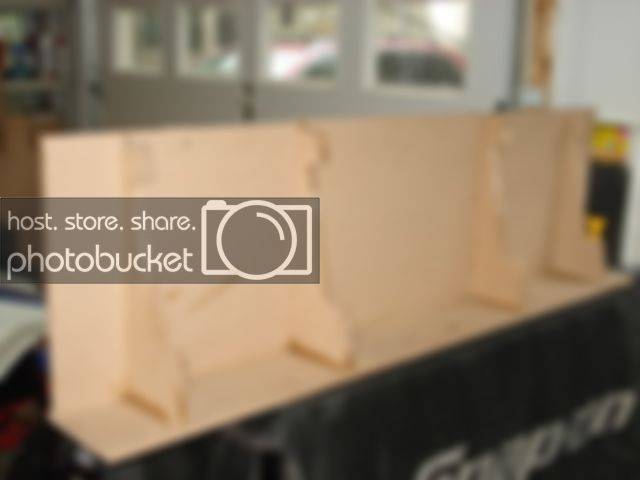

This is the back wall for the amp rack, the 3/4" runners will keep it spaced out from the back wall of the truck to avoid the cab vents.
I really wish there was more room back here
Now it finally starts to look like something.

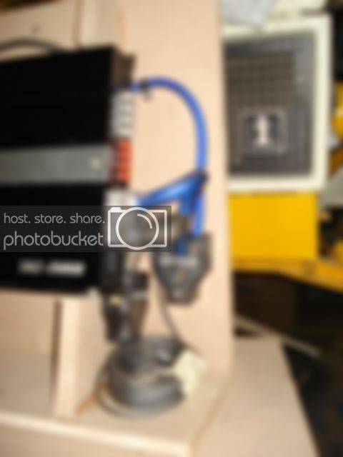

Glad I was using Kicker 1/0 cause I'm not sure another wire would be flexible enough to make these bends.

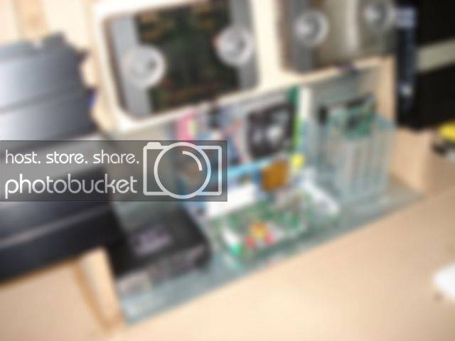

Fishing some of the wires around behind the computer area, trying to keep things as clean as I can.
Now all I need to do is finish up the wiring, still need to by a few pieces of wire to get it all finished up, and get the computer components all mounted up. After that just finish the cover panel that will flush everything in and carpet it. Then I can move onto running the rest of the wires in the truck.

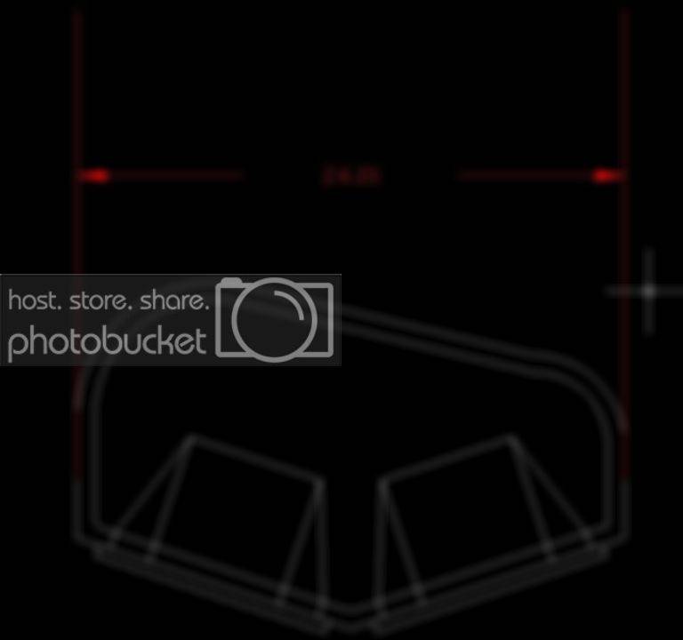

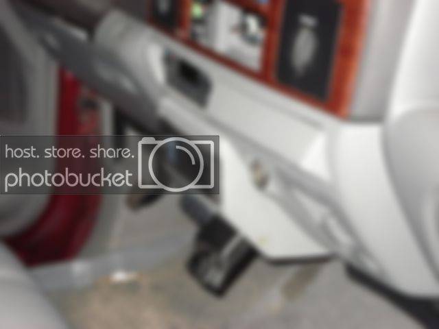

Should hold 2 12" mags sealed off in between the front seats replacing the center jump seat. while keeping the console/seatback above it. If this doesn't work out I may switch to some IDQ10's or a single 12. Toying with the idea of a single 15" aimed directly at the back seats for the fun of it but I doubt I will. Or attempt 4 of the new SI BM's along the back wall, going to need to fiberglass the back and floor to get the mounting depth and move the amps and computer to under the rear seat.
Other ideas I toyed with, 3 tens, but takes up pretty much 100% of the ****** tunnel area.

not to bash your work but that dash attachment you made looks crooked, is that just the pics or is it a little crooked?
I'm pretty sure its just the pic, but I am gonna double check it with a level and tape measure. It's looking like a built up one side with a bit too much bondo/glass and it didn't sit in perfectly. I ended up rushing when I attached the glass piece to the dash panel //content.invisioncic.com/y282845/emoticons/mad.gif.c18f003ab0ef8a0d9c27ca78d77a6392.gif Don't worry about the bashing or criticism, I'm sure there will be more, least I can do is try and make it better from the comments. Hopefully practice makes perfect lol.
EDIT: Just looked back again and now I remember whats up with it. I couldn't get the trim ring to snap in right, didn't wanna break it, but I got it snapped in good now. Its sticking out a little on the right hand side that clip didn't wanna go in. You can see it sticking out in the upper right corner on the last pic. Dang it lol

kool, yeah nothing against your work it is very nice for a first time glass job. Just looked a little crooked but good to hear you got it fixed and keep up the nice work. BTW nice truck
