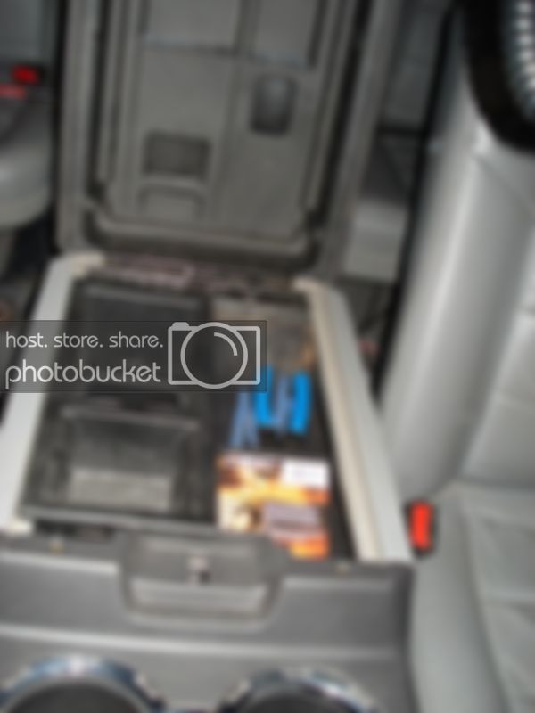

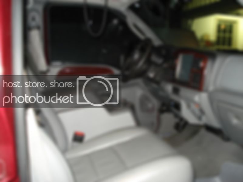

Nothing out of the ordinary except maybe a little tall (perfect height for an arm rest IMO)
Sadly the amazing amount of storage these consoles have had to be given up, but still enough. The back wall was carpeted but I had to remove it, will be carpeted again (one of those little details to yet finish)

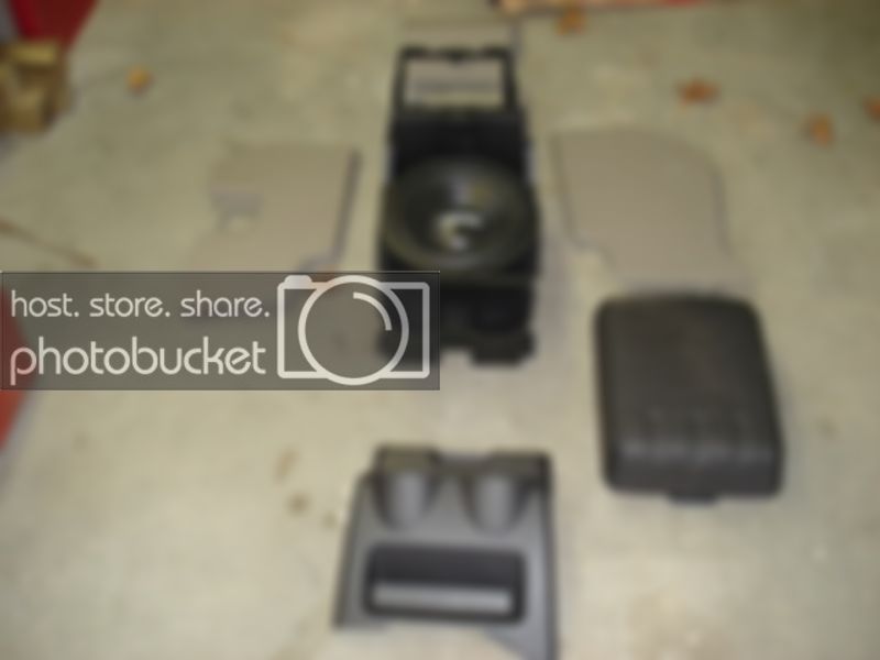

The console actually disassembles quite easily which I was shocked by

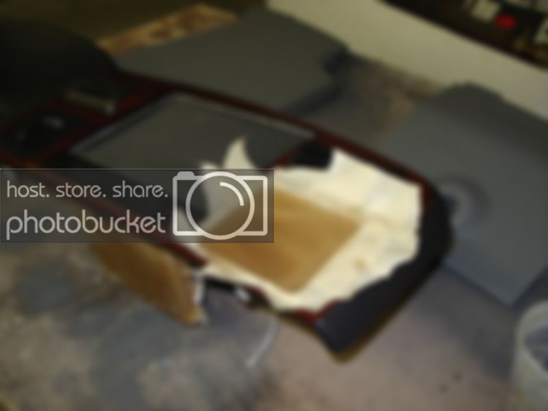

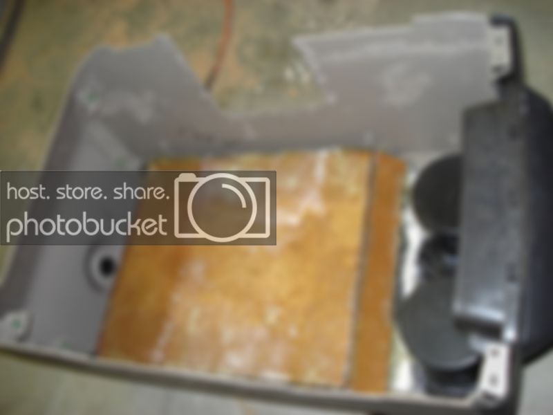

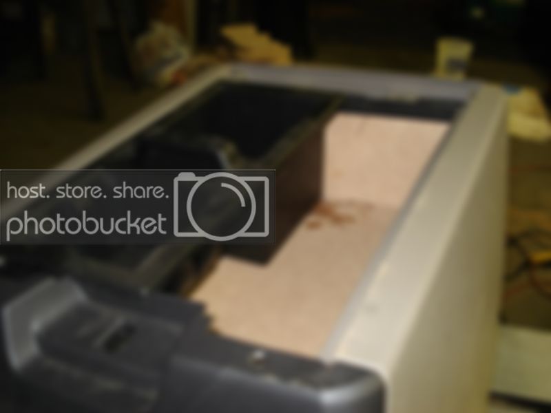

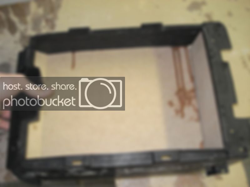

I don't have too many pictures of the work on the top storage portion. But what I found was that the bulk of the console (storage container) is in 2 pieces, so I took the top portion and ended up cutting it down by about 2 inches on the sides. From there I cut some 1/4" MDF to make a new floor and used fiberglass to join the two. This gave me about 4" of storage inside and maintained the latch for the cover and mounting points and such.
Now here is the remaining space I was left to work with. I did a bit of trimming to the sides and such to get rid of some excess.

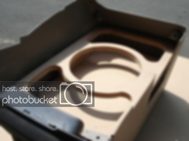

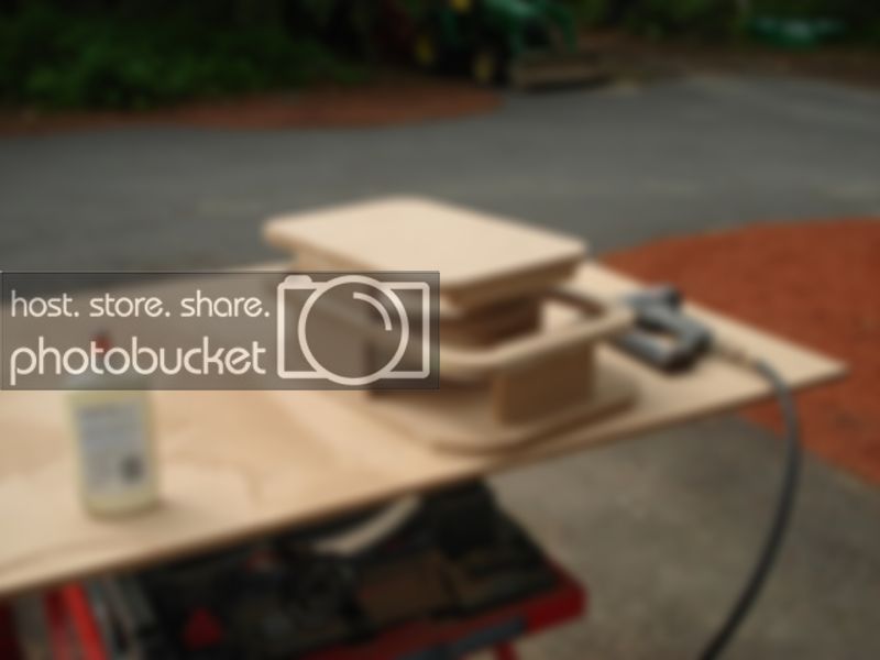

Now for the actually box itself. I figured I needed about 3 levels inside (top, middle/brace and a bottom) The middle piece is mostly for shaping the fiberglass to conform as tightly as possible to the inside of the enclosure and adds some bracing to stiffen it all up.

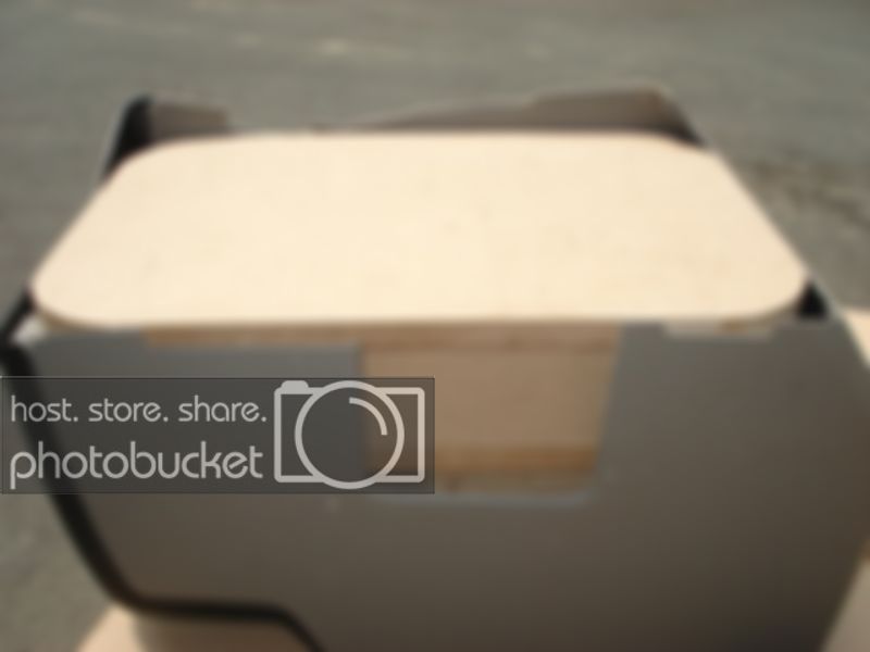

Here is the final frame work with some extra cleats and blocks to space things out properly before getting wrapped in cloth.
fits nicely into the console

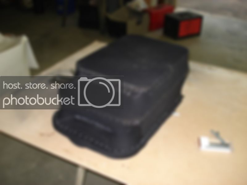

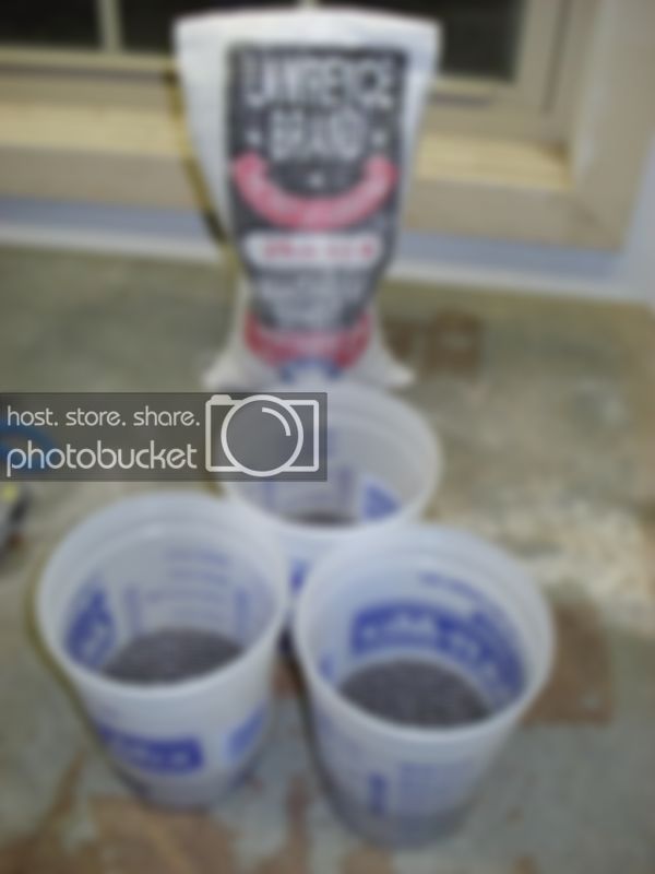

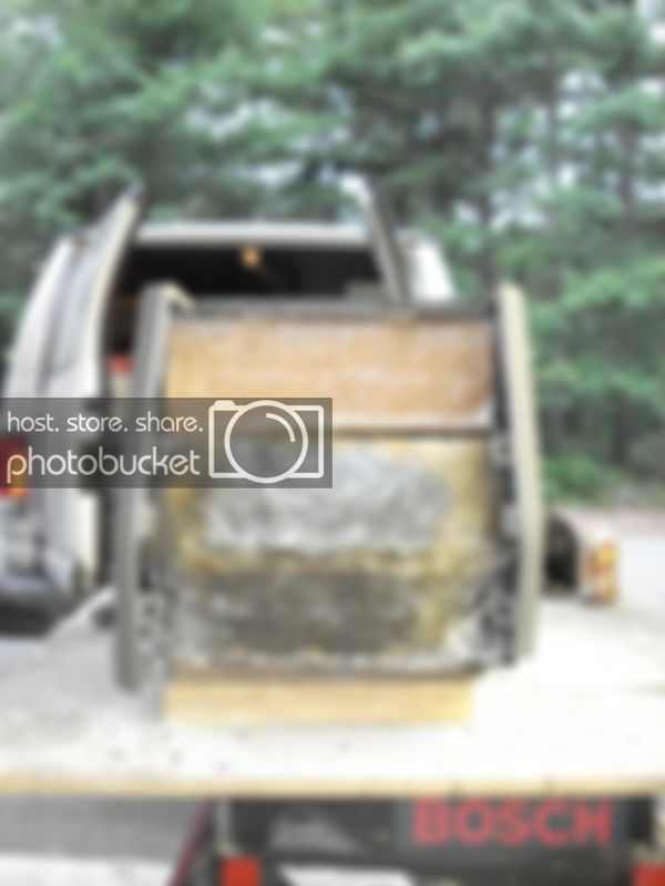

Much of this entire project is about experimenting and seeing what I can do. Since I didn't want the enclosure to sound hollow or just get beat up by the pounding of the sub I wanted it to be extra strong and have as much mass as I could possible get (much of the reason MDF is used normally) So I took the suggestion of another guy of adding some lead shot into the layers of fiberglass. I don't know how much it improved but I added a solid 5-7lbs to the enclosure and only increased the wall thickness but about an 1/8"

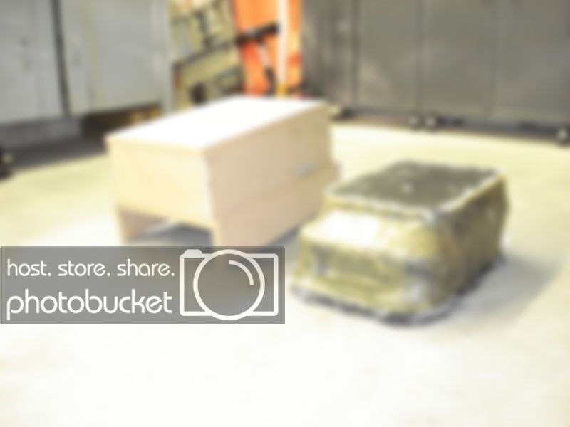

Here is the finished product against the temporary box it was replacing
I think I did pretty good since the fiberglass box weighted within 3 pounds of the larger MDF box, fiberglass box came out to be 24lbs.
Here is a view from the backside to see how it all stacks up inside the console.

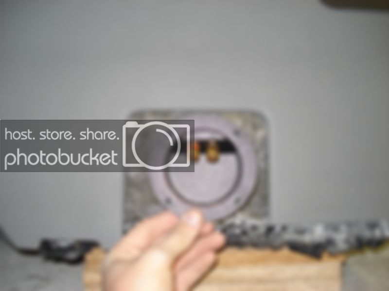

This little factor opening is going to get filled nicely with this speaker terminal and some carpet

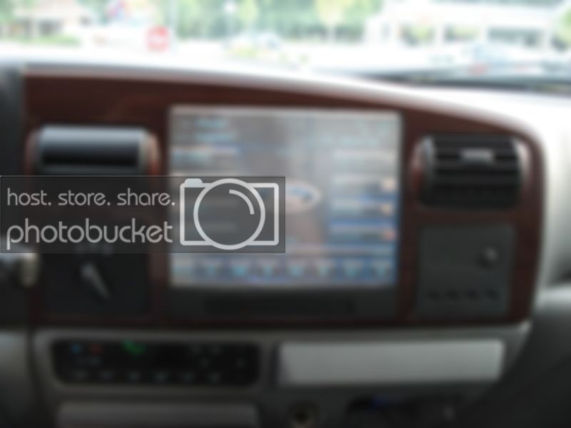

Also I finally filled the hole I had in the dash for the longest time. Again with some fiberglass (my new favorite material lol)
Started by taping it all off and making a mold for some resin and 2 layers of matt

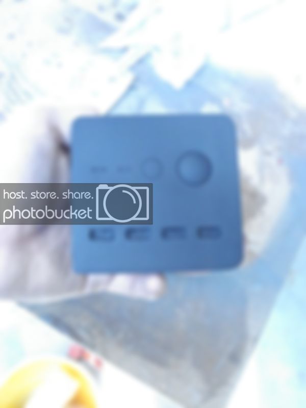

I guess I don't have any construction pictures but I cut in the switch panel (wires got extended with some CAT 5) and cut in the USB 4-port hub. Little bondo, little paint and lots of sanding later and here is what I got
Its not quite perfect but that gives me something to work on in the future (maybe ditching the wood grain) it sure beats a hole in the dash with wires and a hub falling out, and having to pull down to back seat to turn the computer on.
