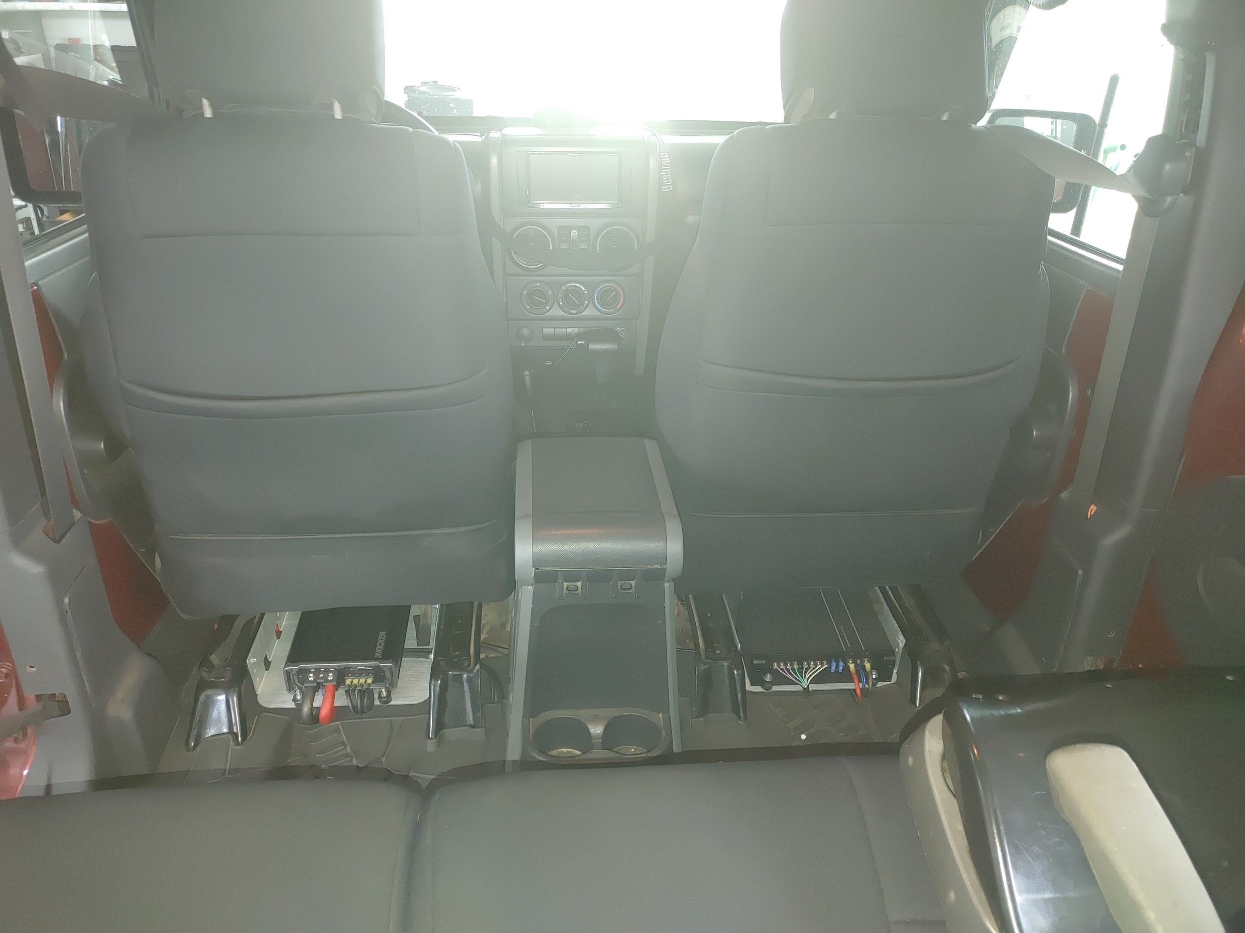

Ive been thinking about this and the shop that initially installed the big 3 and alternator did wire it differently than what i found on xs powers website.. He ran the alt/engine ground to the battery instead of the chassis and the battery ground is ran to the frame of the jeep, not the tub metal like where my amps are grounded.. Should i ground my engine/alt ground and the battery ground to the factory firewall grounds? My amps are grounded to factory ground points on the tub near the amps. Ill attach picsView attachment 32310View attachment 32311View attachment 32312View attachment 32313View attachment 32314

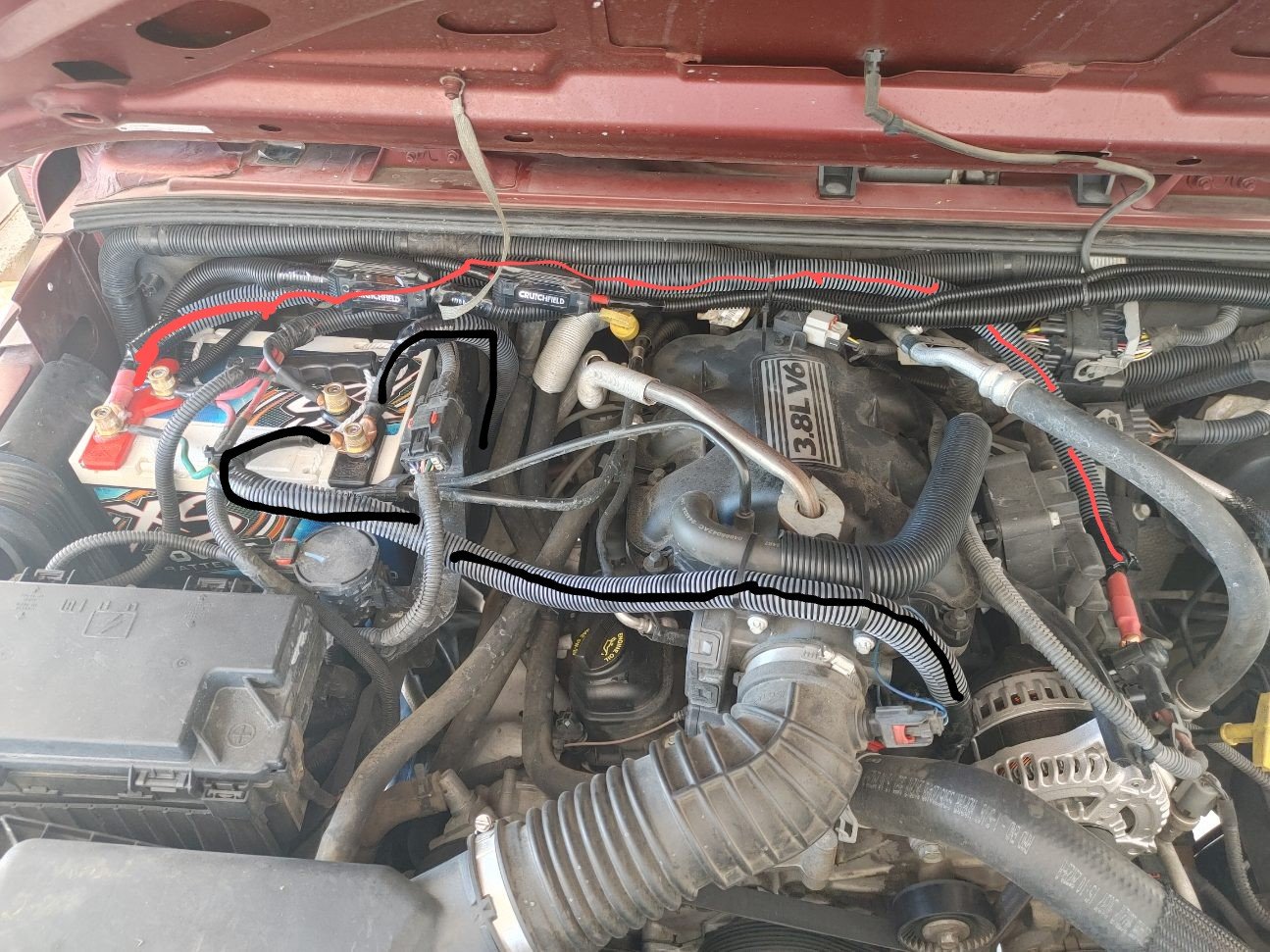

I thought after looking at your first drawing the Big 3 didnt look correct and then again after looking at your Engine bay highlighted drawing. The BIG 3 isnt done correctly

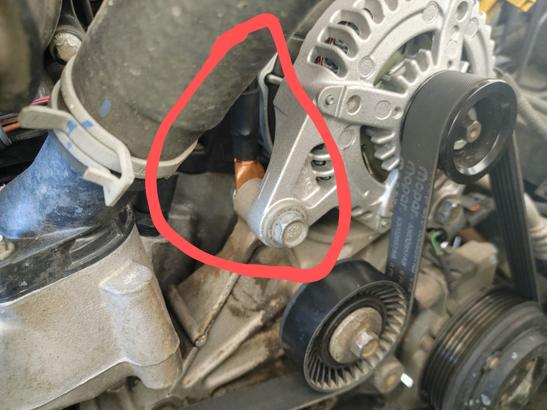

That Ground wire to that Alt. Casing isnt the greatest spot for the Big 3. Needs be on an Engine Mount or lower portion where motor meets frame..

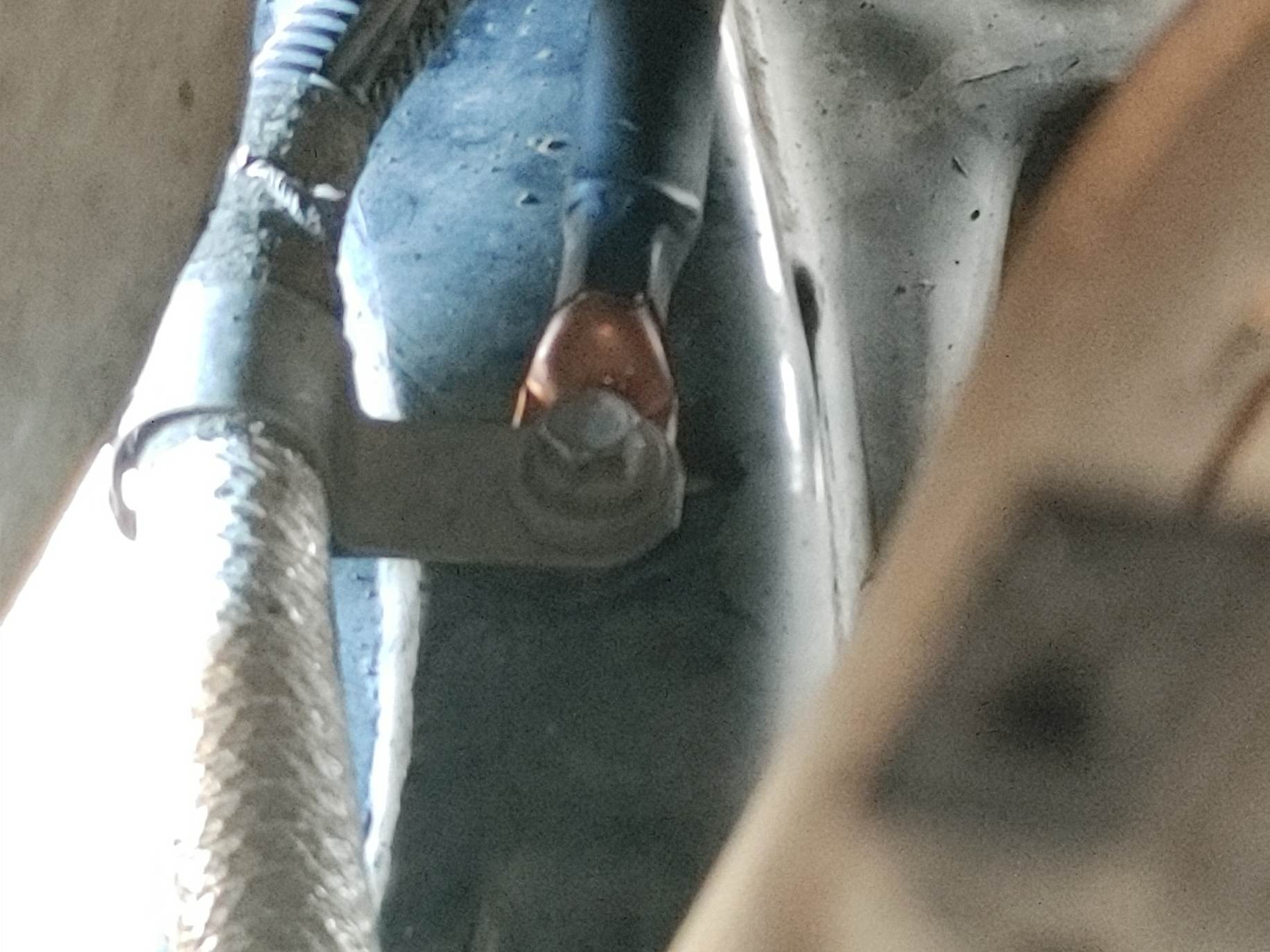

That ground to that Frame work??= Grind that Biche" down to Metal and place a Clean metal washer to frame then put those two ground wires back on there.

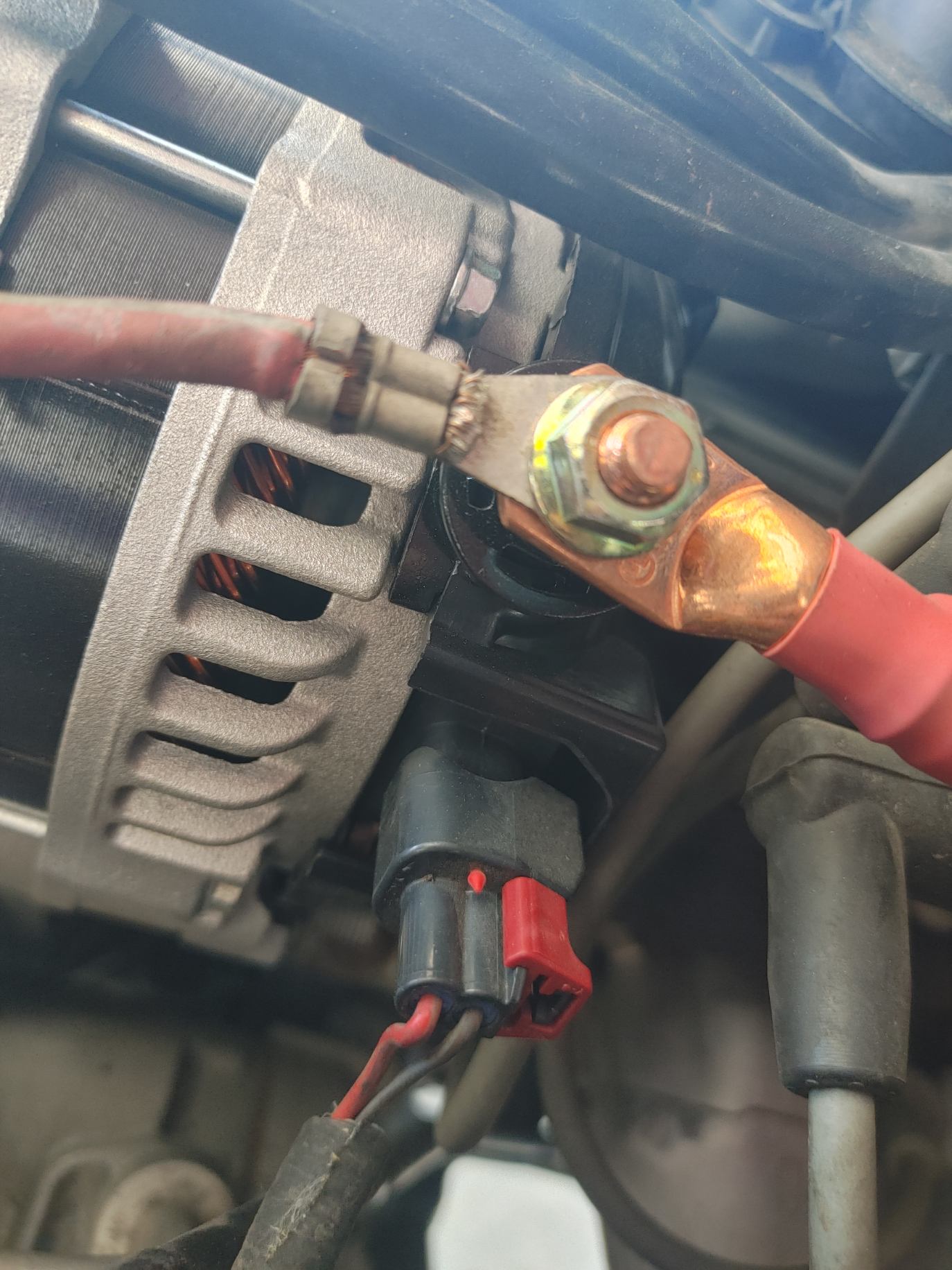

Alternator Poss wire Looks Fine

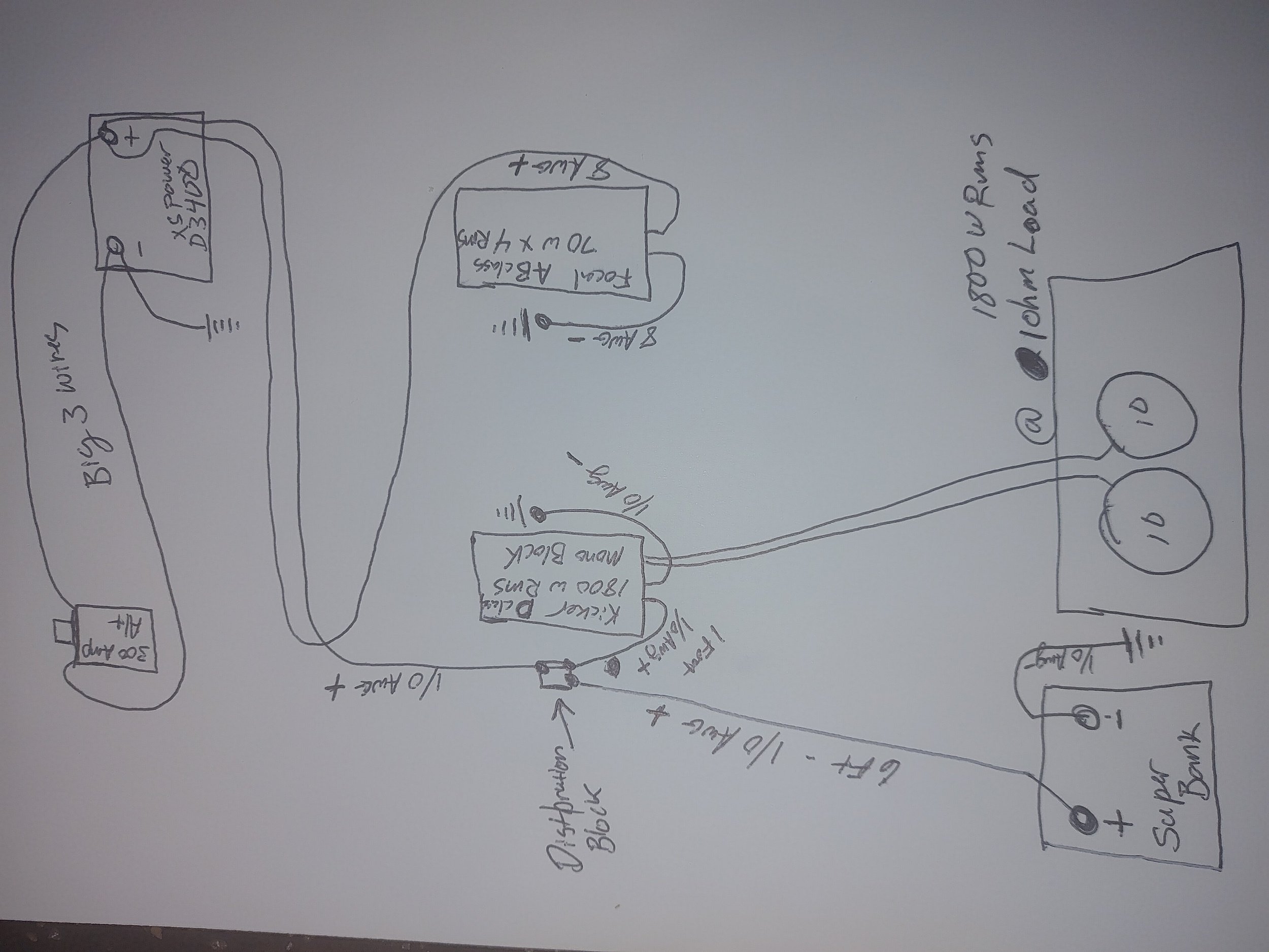

I have a drawing I will include that shows how I was planning to wire in a super bank. If i need both I will place the AGM right beside the super Bank and run a separate strand of 1/0 to a smd distribution block.View attachment 32292
