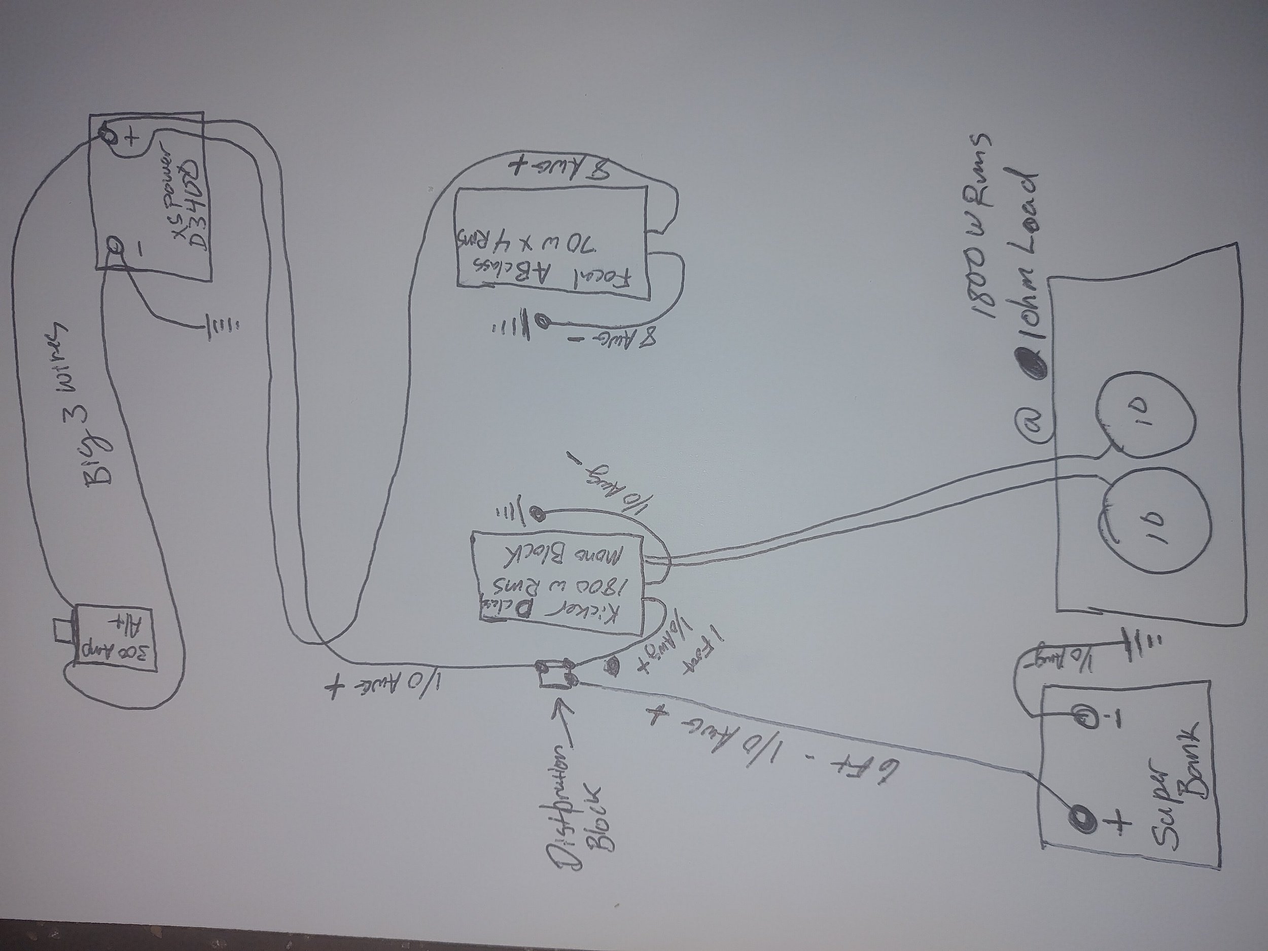

My headlights constantly flicker with the bass when I have the volume over three-quarters of the way up. I have and 08 Jeep Wrangler daily driver and a sound quality setup.
My electrical system consist of a JS alternator rated at 300 amps although it only load tests 250😠, Big 3 kit, and xs power d 3400 agm under the hood. I'm running a kicker class d 1800 watt monoblock at a 1 ohm load and a focal class ab 280 watt 4 channel at a 4 ohm load.
So do you think I should add a superBank or an AGM?
Or maybe even both? I'm getting conflicting answers from everyone.
If the super bank or AGM or both are your recommended solution, how do I wire it and do I need fuses on both?
I have a drawing I will include that shows how I was planning to wire in a super bank. If i need both I will place the AGM right beside the super Bank and run a separate strand of 1/0 to a smd distribution block.

If you have an alt putting out 250 with an XS power battery running 1800 watts and your getting light dim then I think you might have a bigger problem.
I'm running the same wattage with my stock alt(150) and an agm and I don't have any dim.
Does it have halogen lights?
You have all the preventive measures taken care of, so I think your battery may be on it's way out. Not long ago I had the same issue. Shuriken crapped out and on it's way out, it killed the Odyssey starting battery. Now I have 1 conventional battery, and no dimming. I am currently at 2400 watts rms total system power.
I know all of them are good except i have not double checked the one from the battery to the frame. We did run an extra cable to the body on the jeep when i was troubleshooting and that didnt improve the dimming.
You need more conductivity between the battery and the amp. If you relocate your current battery next to the amp, I bet it will solve your problem.
@Kickstand what are his bigger problems? That sounds like a vague way to say you don't know what the problem is if your guess doesn't help.
@1aespinoza will probably agree with me after he reads my post as usual.
That isnt really possible without redoing everything. There is only 13 ft of 1/0 premium ofc between the battery and the monoblock and it is pulling 175 amps.. I thought 1/0 was overkill? Actually i thought everything i done was overkill.. Why im so disappointed to be having trouble.
