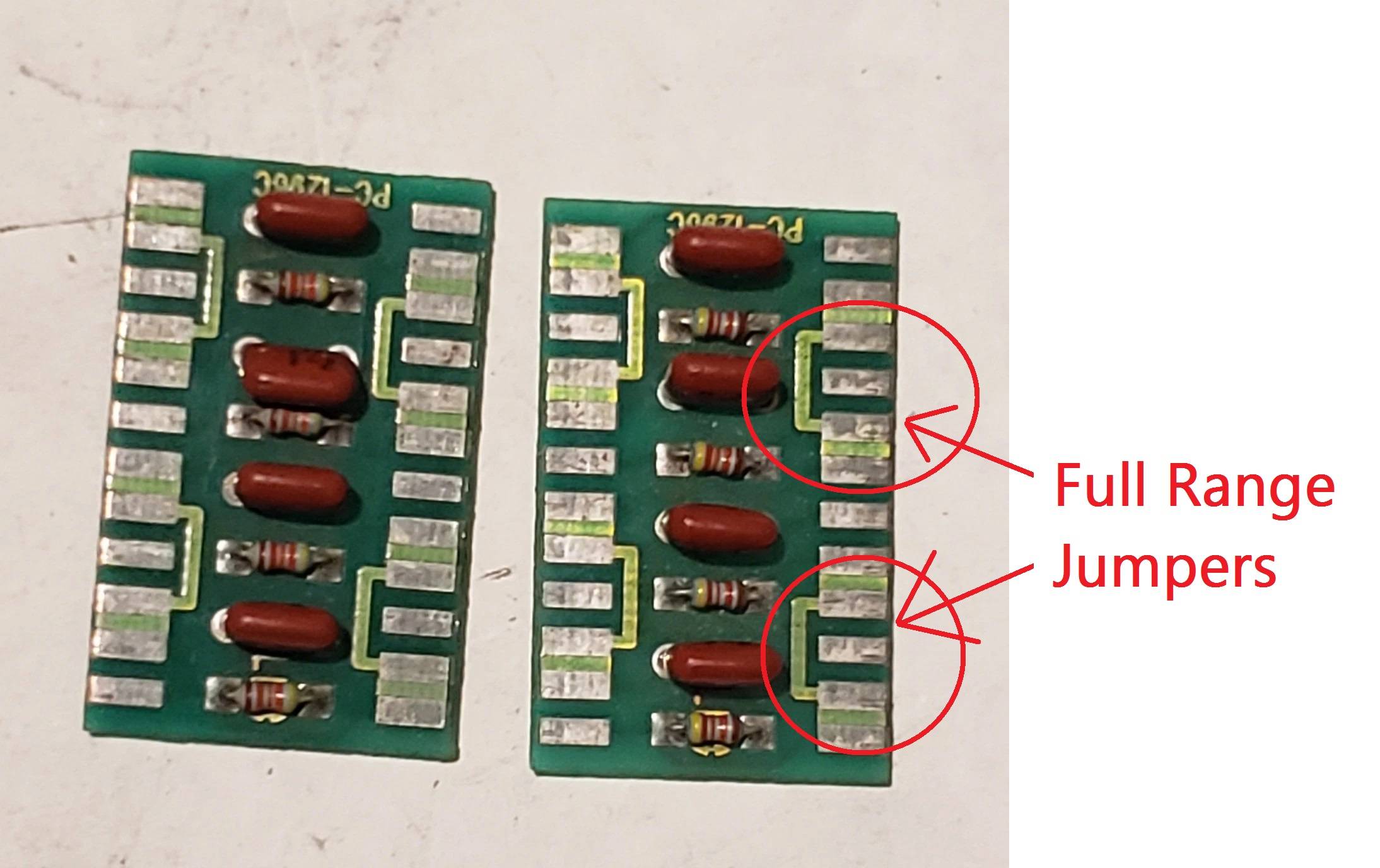

Image I took from an Ebay listing and edited to show the full range jumpers on the back side of an X Card. One side of the card you have High Pass and Low Pass, you flip it vertically for whichever you want to use. Alternatively you flip the card backwards and use the other side for the Full Range jumpers and it bypasses the filter resistors / caps. If your card has the jumpers like this below, you should be able to plug it in backwards to access full range.

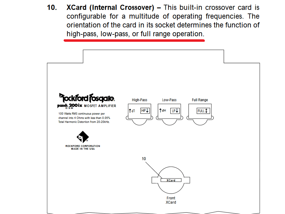

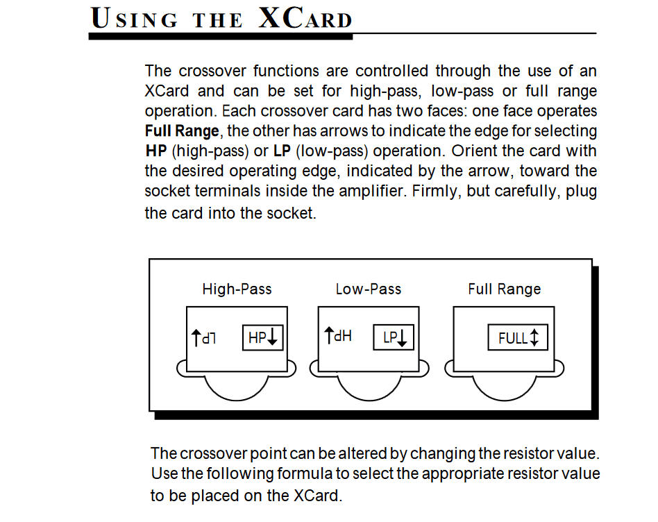

Also, page from the manual for the 60 iX and is the same for the 240x4. I understand there may be a language barrier, but maybe a photo translate app will help. Those X cards should be full range capable if using the second face of them.
