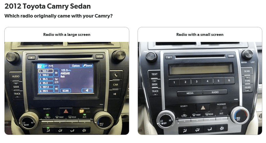

My daughter has a hybrid Camry, and we recently serviced her car. Because she knew I would be commandeering the audio portion of her purchase, she made a "sound" choice, then gave me a budget. :)
That said, which of these two non-premium head units does your Camry have?
Keep in mind, PAC, iData, Meastro, all make (fairly plug-and-play) harnesses/interfaces for most any headunit you might upgrade to.
These interfaces allow you to reatin100% stearing wheel, infotainment functionality.
Nice to see that it has a CD player, they stopped equipment Toyota's with CD players in 2020.
You can use the factory HU; it's not a deal breaker by any means.
Anyhoo, we ended up installing a 6.8" Kenwood head unit as she wanted front/rear cameras installed.

Thank you for your input. Mine is the model with the larger screen. Budget is around $2,500. I was very much into car audio in my early 20’s but that was 25+ years ago and things have changed drastically. I’m not a professional, but am am fairly mechanically inclined. Looking at adding amp, door speakers, rear dash speakers, and 2 subs. Not sure about whether to even use the front dash speaker locations. Any thoughts or input are appreciated.
