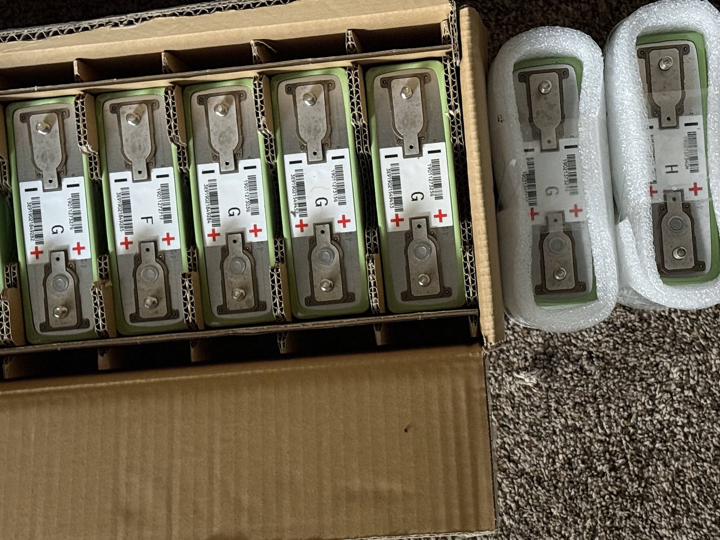

Featured How should I wire these together.I need help

It’s for a Stetson 8k 2ohm amp.
Those are capacitors, correct? I'm guessing you're trying to wire them to your cars amp? You would wire all the positives together and the negatives together, which is called parallel wiring. Using copper bars would be ideal, but that is expensive. Therefore, you might want to check out brass bars.

Cool they guy who build my box told me it’s a certain way that you have to wire them he wanted to charge me 150 do it

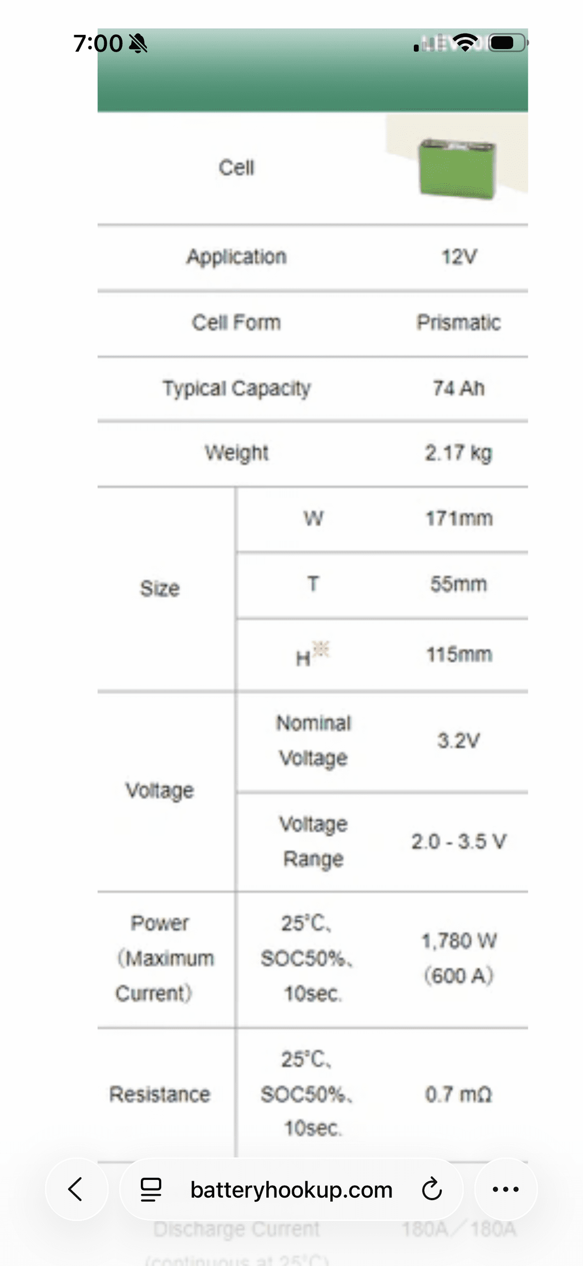

Aren't those 3.2 volt cells?
Wouldn't you need 4 cells in series to make a nominal 12.8v bank
Then you parallel each bank for added reserve?
I'm still learning the cells thing 🤷‍♂️
Those are Lithium(?) cells, not capacitors.
These in the video are batteries, but all the same, cells/batteries, same - same, parallel or series, it explains which is which and why.
I think this is how they are wired up to attain the desired voltage.
But I count 7, and you only want 4 to get to roughly 12.8V.
That is if they are all at 3.2v.
It might be wise to look into this further; it might be prudent to pay someone after all.
You have to check each one, make sure each cell is charged before connecting, and closely match 4 of them, etc.
Done incorrectly, you could be blowing $hit up and not in a firecracker sort of way, more like an M80 sort of way.
I see 8 cells, there's another one to the left
Correction: If there are 8 cells, then you could wire them in a series-parallel connection for 12.8V.
And I would assume some sort of BMS too.
I'm not thinking this is exactly a first-timeer "let's experiment - see what happens" kind of deal, may want to PAY THE MAN TO PLAY!
Jk, but definitely do some more research. $150.00 is a bit of cash; fires and explosions are a lot of cash.
