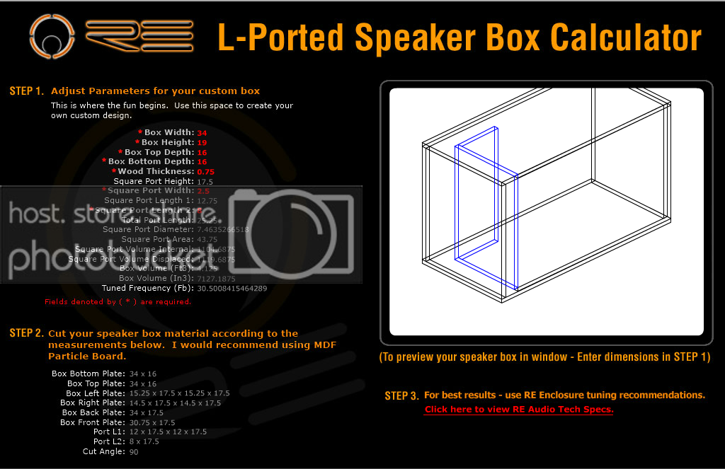

And another thing, that RE Box calculator says for the side cuts, 15.25 x 12 x 15.25 x 12.. Why twice?
If thats whats recommended, then ill do it, you guys no more than me lol
Any yeah i think i noticed an increase in spl when i turned my box over faced up from a normal upright, but that was probably because the woofer was sitting so close to the tail gate

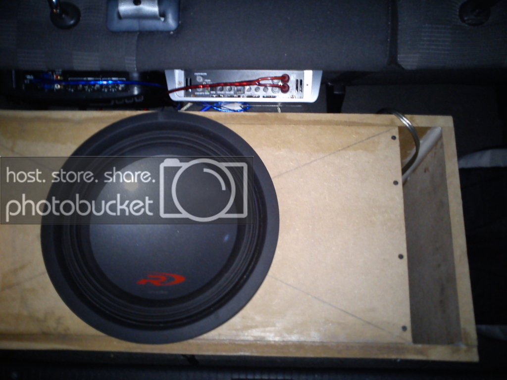

I have a hatchback and since the RE box calculator is all im familiar with itl have to be a simple design on that, so its gonna be sub up & port up. Im just hoping the extra capacity inside this box will give a nice difference. Currently running in a box that was 2.0 ft^3 @32 hz before displacement, and the new will be 2.5ft^3 and whatever hz it needs to be that after subs in its at 32hz (still dont know how to work it out and cant find much on google)

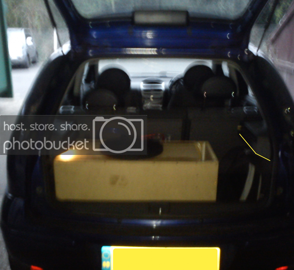

Heres my current set up and space restrictions, sorry for the bad quality
So ive got about half inch i can squeeze between the amps, so il have a little more room to mount the sub, thats currently a 12" sub on a 12" high piece.
decided another 4ohm sub running both at 1 ohm is what i want to do, so as soon as i know what to do with the box i can go purchase it and get going.
I can get a maximum of 37" side to side, and i think it was 34" between where the subs can be mounted to avoid them hitting the plastic bits (i marked one in yellow)
Can i use the same port as the one in the OP or will it have to be completely different? like port in the middle or what ever
So you can either make box 37" wide but less tall, or 34" and taller. If you go 34" wide, how tall and deep can you go maximum? You can always mount the amps on the left and right side of the box below those plastic bumps if you make the box 34" wide.

Btw, just to be clear the box will be like in the OP with both 1&2 subs, and then just flipped up so that the subs facing up.

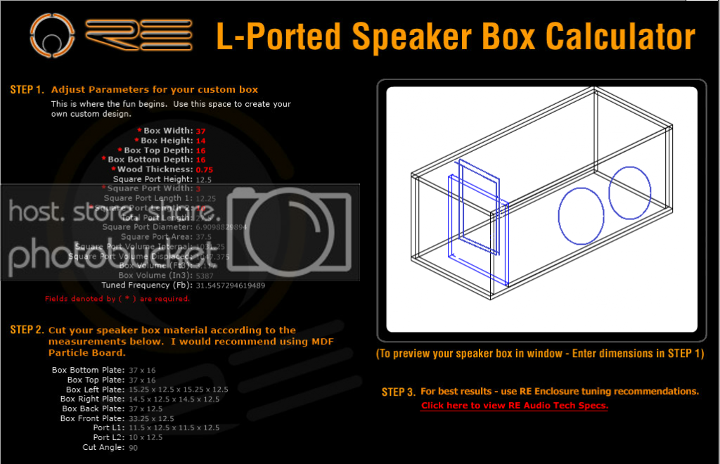

this is what i can do @ 37 inches wide
When coming up with the 34" wide box i think i realised how much more room i can potentially have but im gonna need to double check this all over tomorow when ive relaxed a bit lol, i just really wanna get this build going.
Potentially can have this, but i know for a fact the amps will have to be mounted on the sides of the box
So a lot more volume than the 37", im just worried about the port only being 2.5". However if i bump it to 3" the second wall has to be 18" and thats not gonna fit the in the way like the 1st pic (how either will be with the second wall like that)
