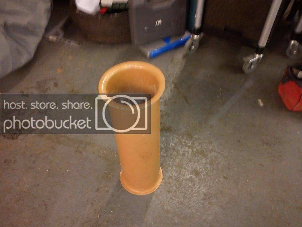

Right, ive made a port with two flares, but im not sure whether theyre flared enough and its the best i could do with the bowl i was using.
Hopefully you guys think that looks ok, i will be painting it tomorow if so. (Edit: The cut out for the port is already in place leaving barely any room for more of a flare, i guess its staying as is, should have waited to get some advice but i wasnt thinking lol)
I have a coupler to join two peices so once i know the port length i will cut it into two and im ready to go

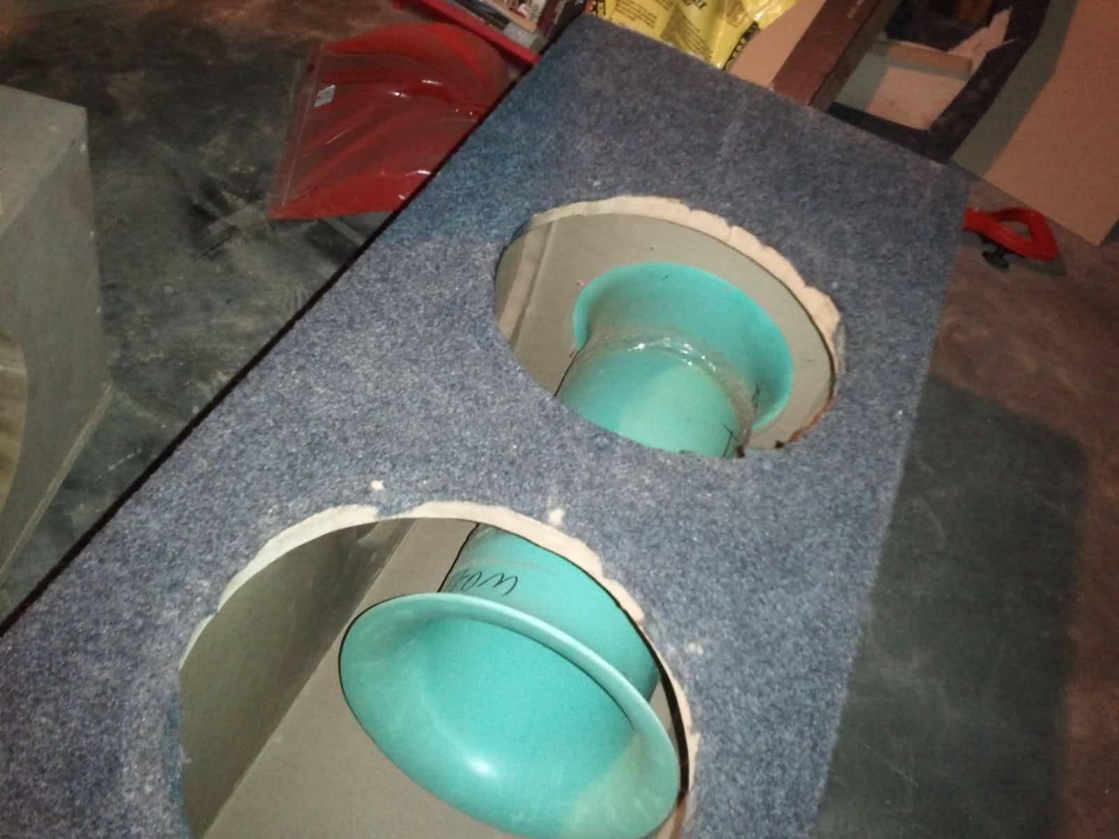

I went with 15.5" port giving me 34hz after displacement, heres how it looks.
As you can see the flare sticks out a bit and its going to have to stay like that, im just going to use the strongest sealant i can find to seal around (see 2nd pic) and it should keep it in place..
Can i get any opinions?
Looks great, did you put the baffle on and fire up the Type Rs yet?

That looks very nice for a first box! I'd have liked to see a bit more flare, but anything is better than nothing.
Its actually my second, and the 1st one was pretty bad lol. but thanks anyway
I know i really wished i spent more time on the flare, its just the only metal bowl i had would only flare it as far as that or the pipe would start collapsing in, needed a bowl with a smaller base. Would have been nice to flare more and screw it in flush.
