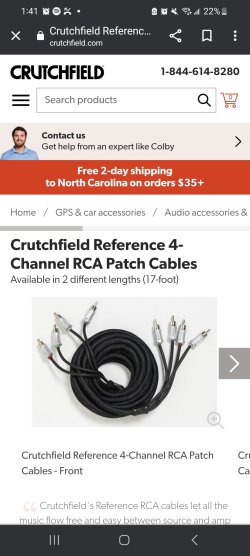

I'm using cruthfield brand 4 ch rca cables, they seem pretty high quality, also, does the same thing with a different pair of rcas ran outside the car. I've pulled it out almost every time I've messed with it, moved it around, moved the wires around. No change.
I hope you have their cheap cables, which are shielded. There is a tendency with RCAs to go unshielded with their higher end cables, which of course is bad juju.
these are the rcas I'm using from them. I don't see why they wouldn't be shielded.

Goes between the HU and amp. You'll need 2 of them.
