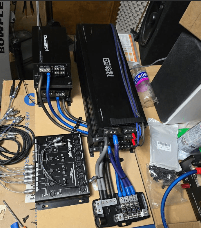

I'm building a budget 13-channel test bench using one of these (well actually it's 150x4 big brother), but 80x4 watt - $69.00!
The other 8 channels will be powered by 2 of these 150x4 class A/B at $136.00 (got mine on sale for $116.00 ea)

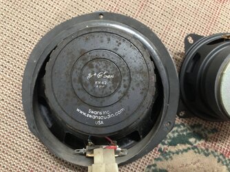

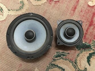

I ended up installing jbl stage 2 45F (4ohm speakers) inte the dashboard
Anyway i realized my old speakers was Swans Audio made in USA. I’am not sure wether this brand does really exist?
