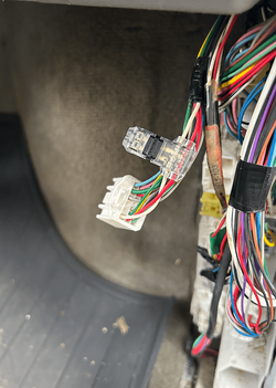

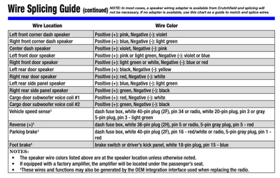

Hello, Im trying to tab into a speaker signal on a toyota sienna 2013 LE (non-JBL- 6 speakers). I found the plug down by the driver door but I can't figure out which wire has the signal for the life of me. I only find conflicting information out there. Not even the crutchfield sheet seems to be correct. I stuck some needles hooked up to a speaker in there trying to see if I get a signal but I don't. How can I figure out which wire has the signal?
Thank you!!

Left Front Speaker (+/-): pink - violet +,- (radio, white 10 pin plug, pins 2 - 6)
Right Front Speaker (+/-): lt. green - blue +,- (radio, white 10 pin plug, pins 1 - 5)
Left Rear Speaker (+/-): black - yellow +,- (radio, white 6 pin plug, pins 2 - 6)
Right Rear Speaker (+/-): red - white +,- (radio, white 6 pin plug, pins 1 - 3)
Center Channel (+/-): violet - pink +,- (amplifier under passenger seat, white 10 pin plug, pins 3 - 9)
Subwoofer (+/-): black (2) red - white (1); green - +,- (amplifier under passenger seat, white 10 pin
plug, pins 8-7; 4-10)
Use a volt meter on A/C as described above. Good luck.

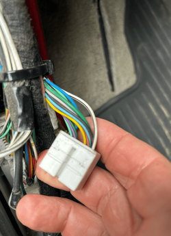

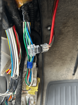

Thank you guys so much. I finally figured it out. I got my bass back! -- Stoked!!!
LF LG+/B-
RF W+/R-
