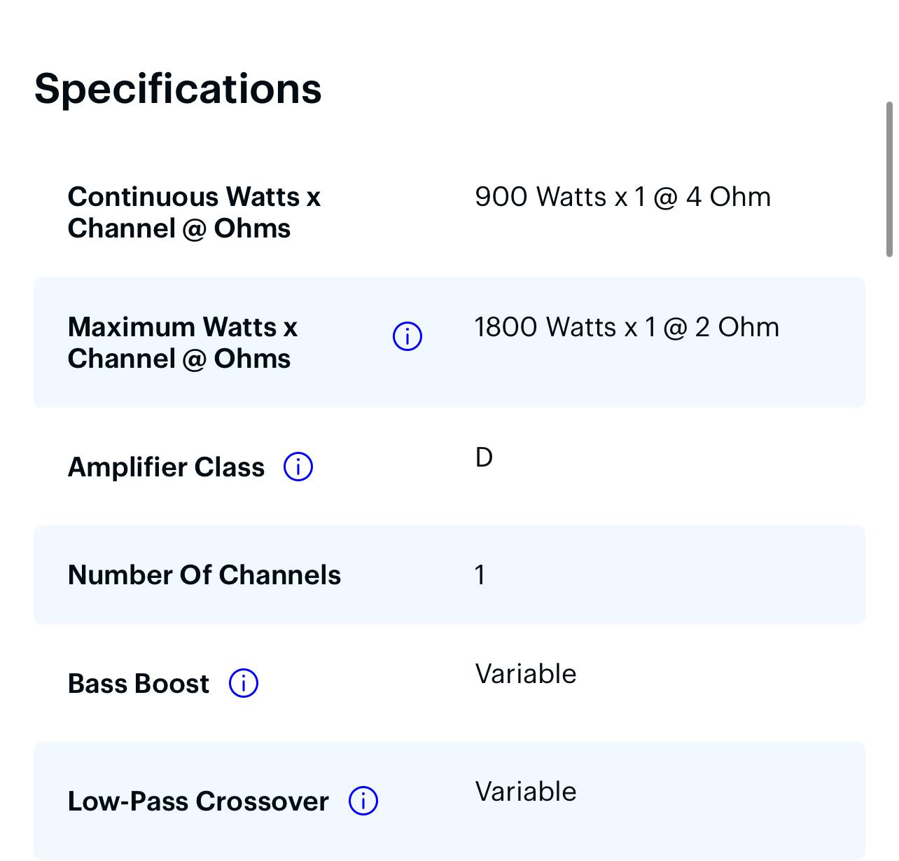

Ok so if I scrap this amp and donate it to charity will the following do!?!! Heading to Best Buy since I have the total tech membership which allows me to return delinquent audio equipment should that issue arise :alien::sick:
Specifications​
Alpine Class D MONO 1800W (is also on sale for $400 - Open to suggestions as always doesn’t necessarily have to be big brand name etc etc although I do miss the OG Alpine Gear we used to have back in the day IYKYK V12 etc lol
  • Continuous Watts x Channel @ Ohms
    900 Watts x 1 @ 4 Ohm
    Maximum Watts x Channel @ Ohms
    1800 Watts x 1 @ 2 Ohm
    Amplifier Class
    D
    Number Of Channels
    Bass Boost
    Variable
    Low-Pass Crossover
    Variable
Specifications​
    Amplifier Class
    D
    Number Of Channels
    Bass Boost
    Variable
    Low-Pass Crossover
    Variable
