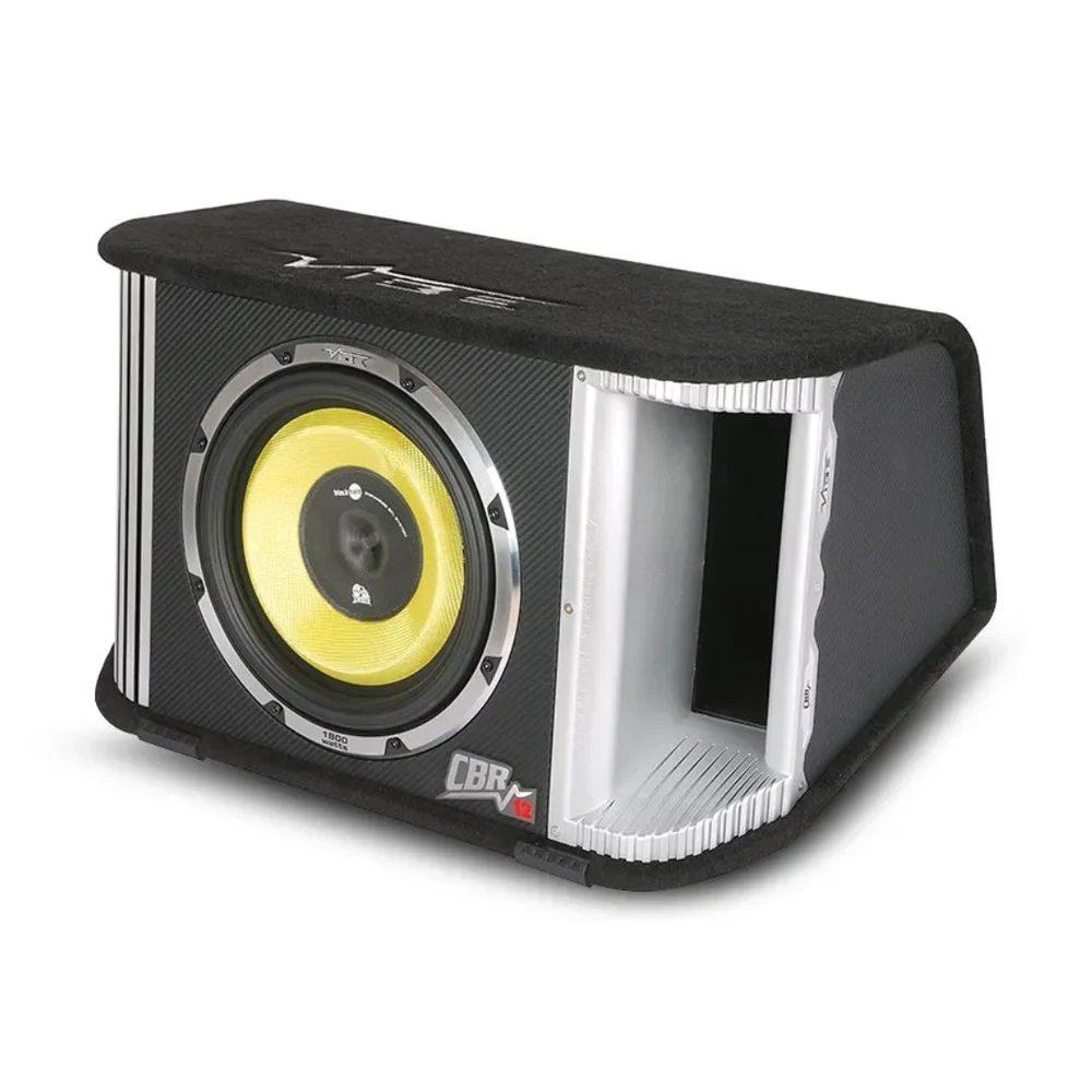

Ok so i have brought an EDGE Car Audio EDP122SPL-E3 12 inch. I will be sticking it in my old vibe active enclosure. The sub is rated at 3000watt peak and 1500 watt rms. I will be using the Blaupunkt class d 5000 watt amp. Now it does not provide 5000 watts as it has been on a dyno. At 2 ohms it gives 1070 watts rms with a current draw of 129.4. I am still on the stock electrical system and the alternator is only 70 amps. The joys of a 36 year old car. When the bass kicks in my headlights dim. What do i need to do to fix this please. I have looked for an uprated alternator and can't find one. Many thanks attached a picture of the enclosure i will use
