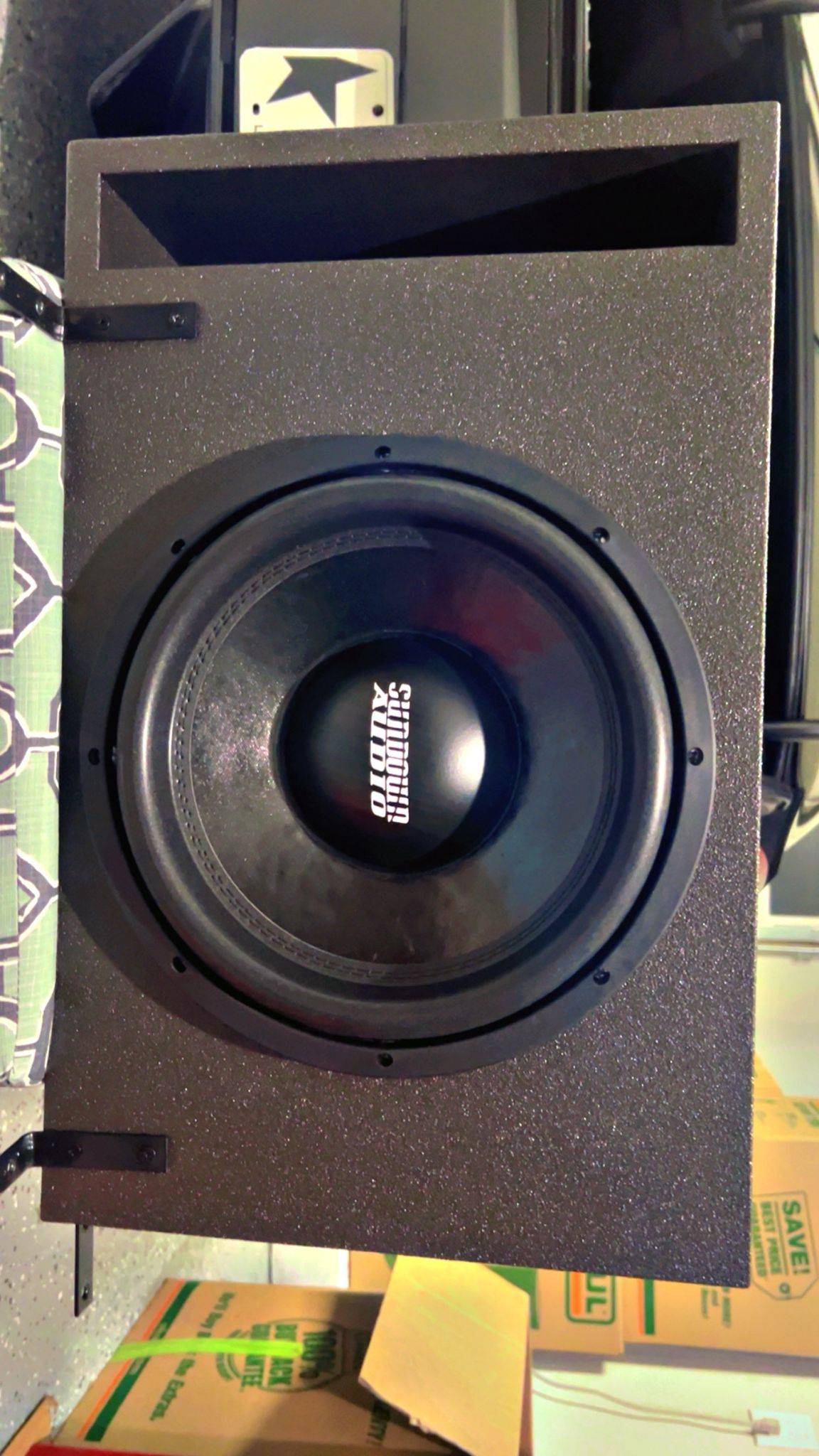

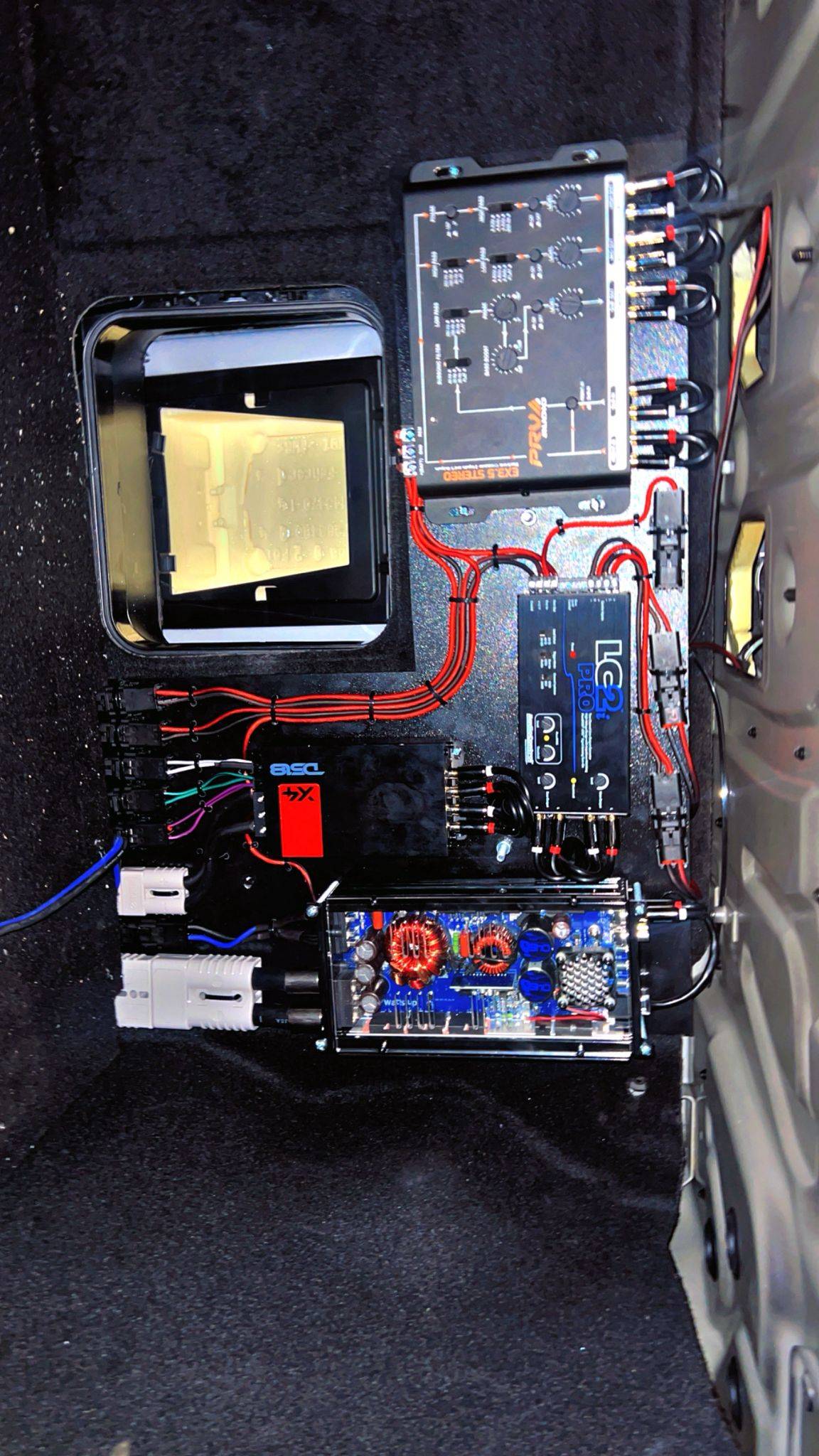

Hey everyone, I’m new here and hoping someone can shed some light on this setup.
I had someone start the install, but unfortunately the work was not done properly and resulted in some damage to the vehicle (I’ll leave it at that 😅).
I’ve attached a few photos for reference. I’m just trying to understand what I may be doing wrong, or what I should be doing so I can move forward the right way from here - the sub does not sound near to how it should be and the bass knob D4S does nothing wither way to the level of the bass, the mid range sound ok, all stock speakers are still in place including the factory amp and under seat woofers... Any guidance would be greatly appreciated! (y)
12" SUNDOWN CLASSIC SUB PORTED ENCLOSURE
INFINITY REFERENCE MIDS 407F 4"
DOWN4SOUND MM1000 (MINI MAXX) – 1000W RMS (SUB)
DS18 X 2-Channel Ultra Compact Class D Amplifier 2 × 140 Watts RMS @ 4-ohm (MID)
LC2I PRO
PRV EX 3.5 CROSSOVER
(D4S) digital voltmeter / temperature / clip indicator with a remote bass knob

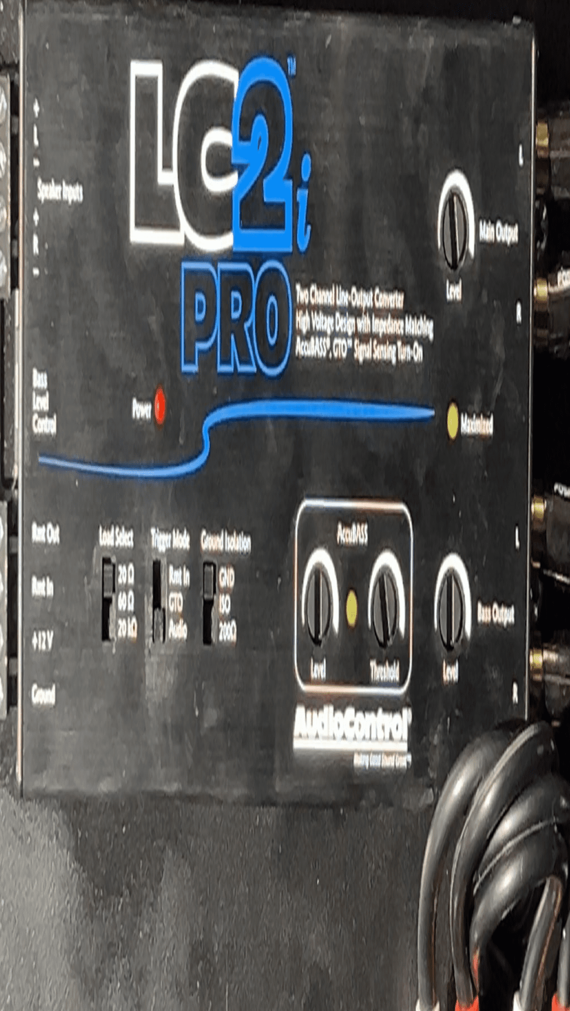

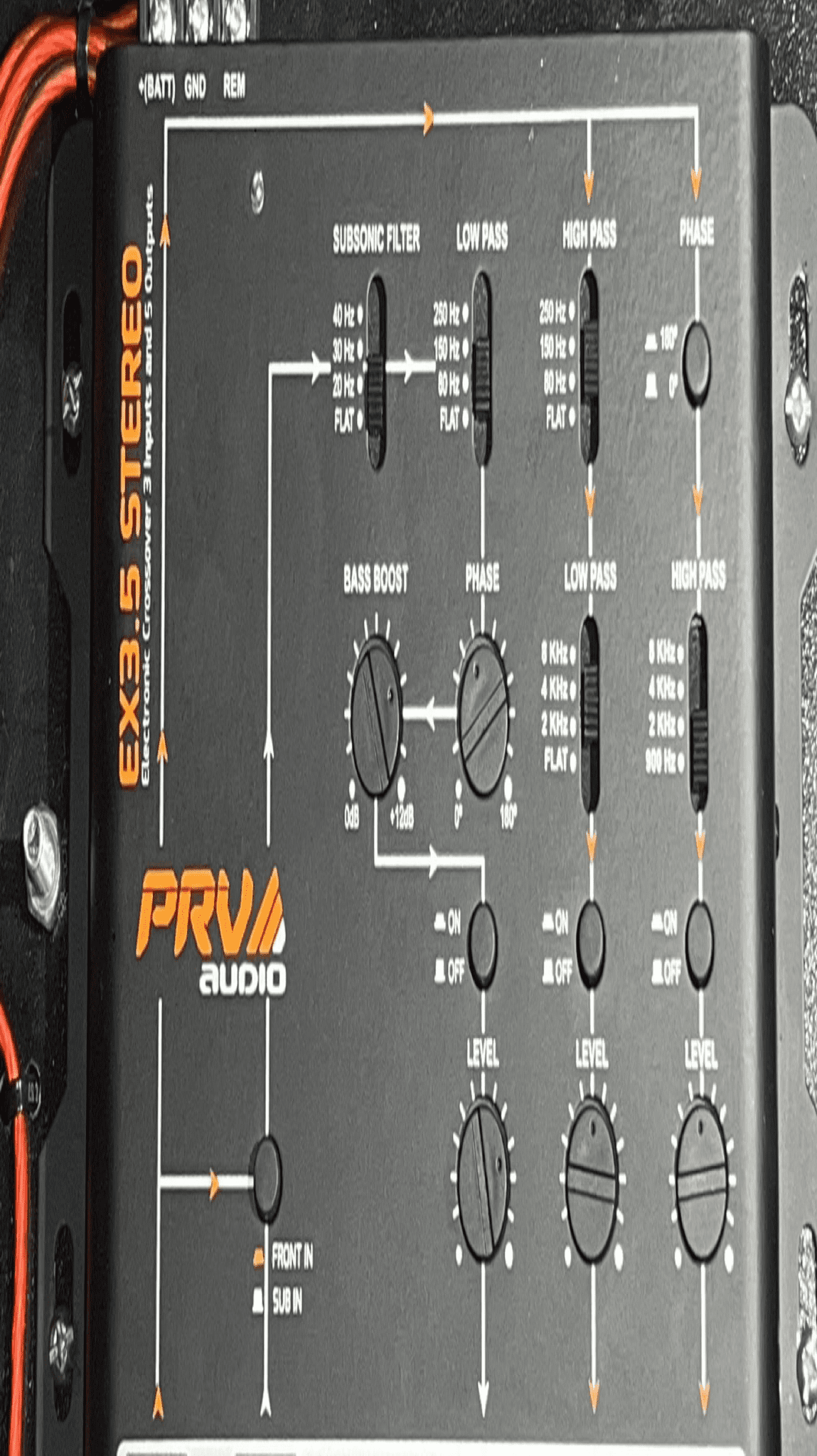

Connected the Sub + Played around with the LC2 controls & PRV Crossover - Not sure if its the size of the box that's the issue or the fine tuning/possible wiring to the sub box thats the issue?? I don't have experience using either (old school lol )

Was the system tuned at all after the install?

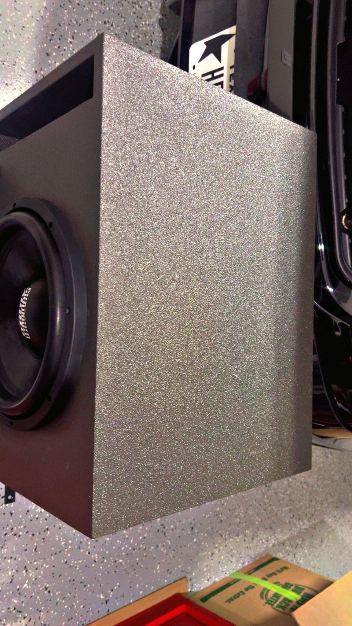

Do you know what the cubic feet of the enclosure is after sub and port displacement, or what the enclosure is tuned to?
Everything looks legit, even the box looks like a 1.75ft³. I say the sub is still stiff so you gotta give it a few hours of play time till it breaks in and gives you that boom you are craving. If the bassknob is not doing anything then there is an install/setup issue. If working, it should at least fully silence the sub.
This is one of those things where I can't really troubleshoot it unless It's in front of me.
Try taking it to a shop and have them take a peek. They might charge a 30 min troubleshooting fee, but they should be able to figure it out pretty quick.
it could be bad turning, bad connections, bad amp, bad RCA's, bad radio, bad DSP, etc...

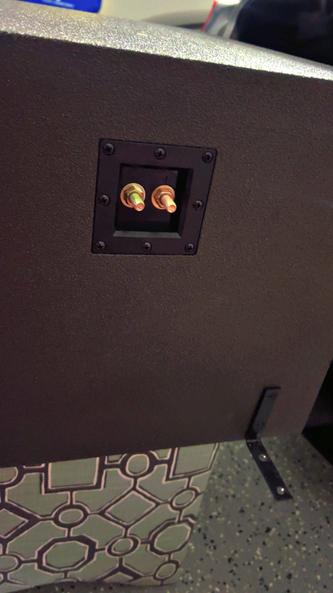

Your 2 channel Amp, how is the Sub(s) wired? single or dual voice coil, series or parallel wired? 4 ohm amp wired Par will -2 ohm, Series wiring will +8 ohm. Both will sound a little different from stock.
Thanks for the reply.
The sub is powered by a Down4Sound MM1000 mono amp (not the 2-channel)
The 2-channel DS18 amp is only running the mid-range speakers, not the sub.
The sub is wired directly to the mono amp at 4-ohm, so there’s no series or parallel wiring involved on the sub side.

Can you post clearer pics of your crossover unit. At least we can tell you if something obviously wrong with basic settings, then virtually troubleshoot from there.
As said, can be pretty difficult to do without being there, but does look like a fairly clean install.
How are you getting signal to the subwoofer? I'm assuming from factory speaker wire
Did you tap into the front speakers or rear speakers?
Front speakers typically have full range signal and will have more bass

Thanks! - Here you go, hopefully clear enough

I went to a local car audio shop for help and ended up spending about $200, but I didn’t leave with much confidence in the outcome. The installer mainly adjusted settings without clearly explaining what was being changed, and ultimately suggested that the issue was simply the subwoofer itself, recommending a JL Audio W7 as the solution.
Since those adjustments, the front mids now sound strained and almost like they’re about to distort or pop at moderate volume. I was told this could be due to the type of music I’m playing, but this behavior wasn’t present before and didn’t occur with the factory setup.
At this point, I’m trying to understand whether this is a tuning, crossover, gain-staging, or signal issue rather than a hardware problem. I’d really appreciate some guidance on what to check or correct next so I can get the system properly dialed in.
