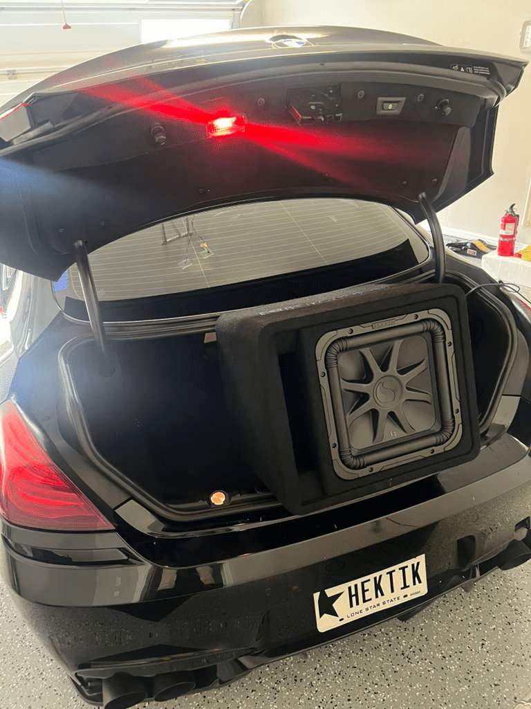

@supernov4 Hey Boss! I'm still here didn't fall off the bandwagon - SO... I adjusted everything ready to wire the SUB etc. Encountered a kicker with the bloody kicker ughhhhh didn't even think about this before, so now we have several issues LOL to say the least! I can remove the floor board maybe however everything would be exposed battery wires terminals etc and it might squeeze in?? What do you think?!! (*note the fire extinguisher which I now keep in the car since the delinquent installer messed up so many wires and god knows what else!) SIDE NOTE - when I fade the speakers front to rear from the head unit front fade hits the factory tweeters in the dash just under the windshield and not the actual MID's - So again not sure what was delinquently done here but doesn't seem right... anyways seems like we have bigger issues unless I revert back to the Sundown and return the Kicker lol. First world problems at their finest right here :)

Wait you can't get the kicker in your trunk? 🤣
I mean you can try the sundown and hope the coil wasn't over heated and bubbled
Hopefully there was just an error when you measured it with multimeter
Just be sure to have amp gain down
Slowly raise the lc2 sub level keep eye on maximize light that's your distortion / clip light in most cases very slight blinking may be ok but if you can avoid that even better
If you feel like ur not getting 800 watts
Then move to the amp gain keep an eye on amp clip light when you slowly raise amp gain you might be able to squeeze few more watts
As for the fading front and back with mids
When you fade to front your stock tweeters should play
If you fade to back and your new mids come in that means they probably tapped your rear speakers for the lc2
If that's the case I'm not sure your rear speakers wires have the sub bass you would need for the 12
Bit hard for me to say forsure
I just know in most cases the front speakers typically have more bass but it could be different with various cars

Hey! I will update you soon as I manage to shove this kicker in somehow! lol attempting as we speak removing some panels I just need a lil more space, the trunk opening is super compact.
Sub is in fired everything up and I have no idea what’s going on, my factory subs sound better! There is some issue with the settings and everyone has a different theory going on here lol. It’s running but like just you can hardly hear it. I am so frustrated it shouldn’t be this complicated 😂
