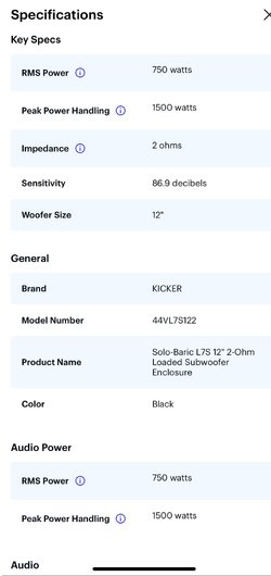

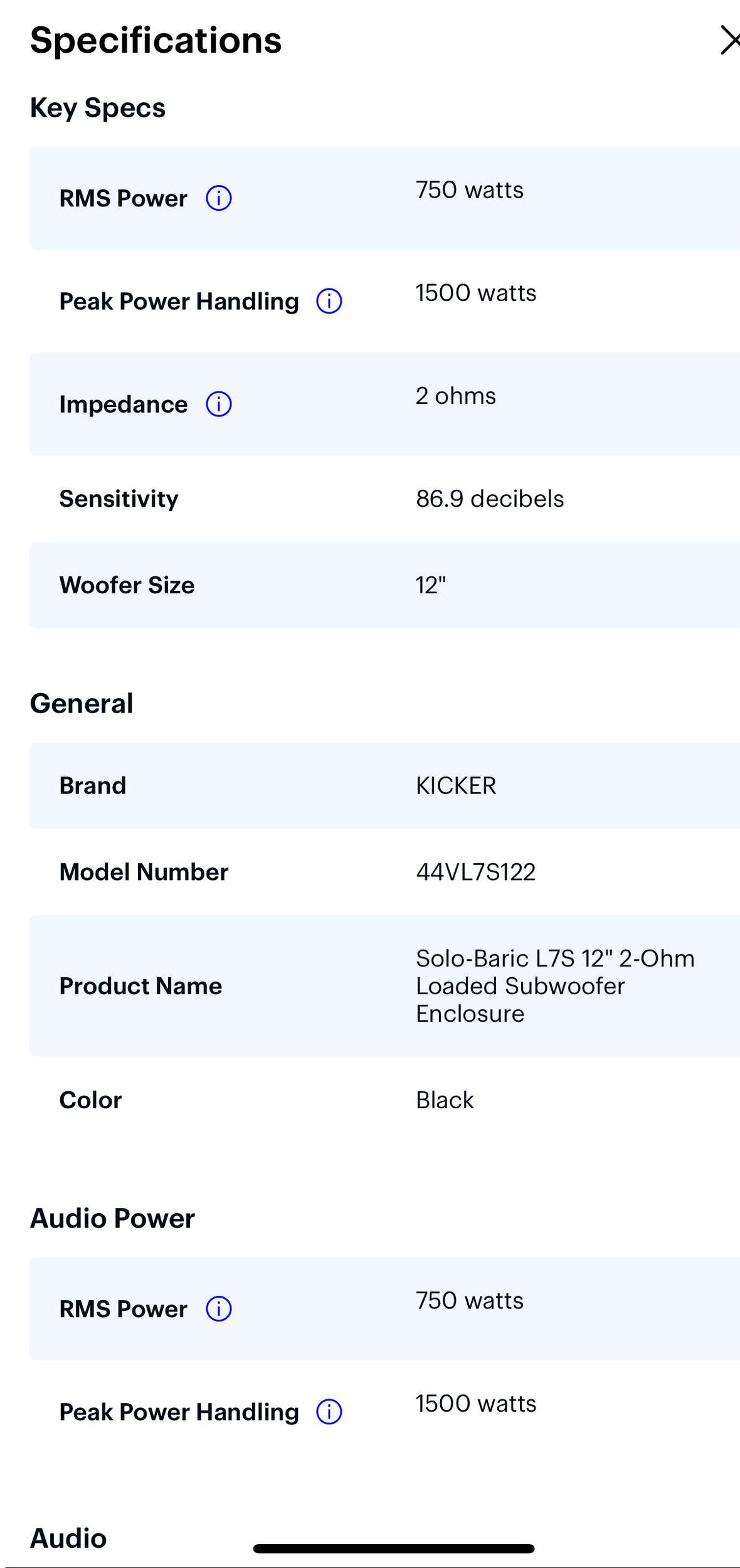

Here are the specs straight out of the box FYI -
Specifications​
  • Key Specs​
    RMS Power
    750 watts
    Peak Power Handling
    1500 watts
    Impedance
    2 ohms
    Sensitivity
    86.9 decibels
    Woofer Size
    12"
  • General​
    Brand
    KICKER
    Model Number
    44VL7S122
    Product Name
    Solo-Baric L7S 12" 2-Ohm Loaded Subwoofer Enclosure
    Color
    Black
  • Audio Power​
    RMS Power
    750 watts
    Peak Power Handling
    1500 watts

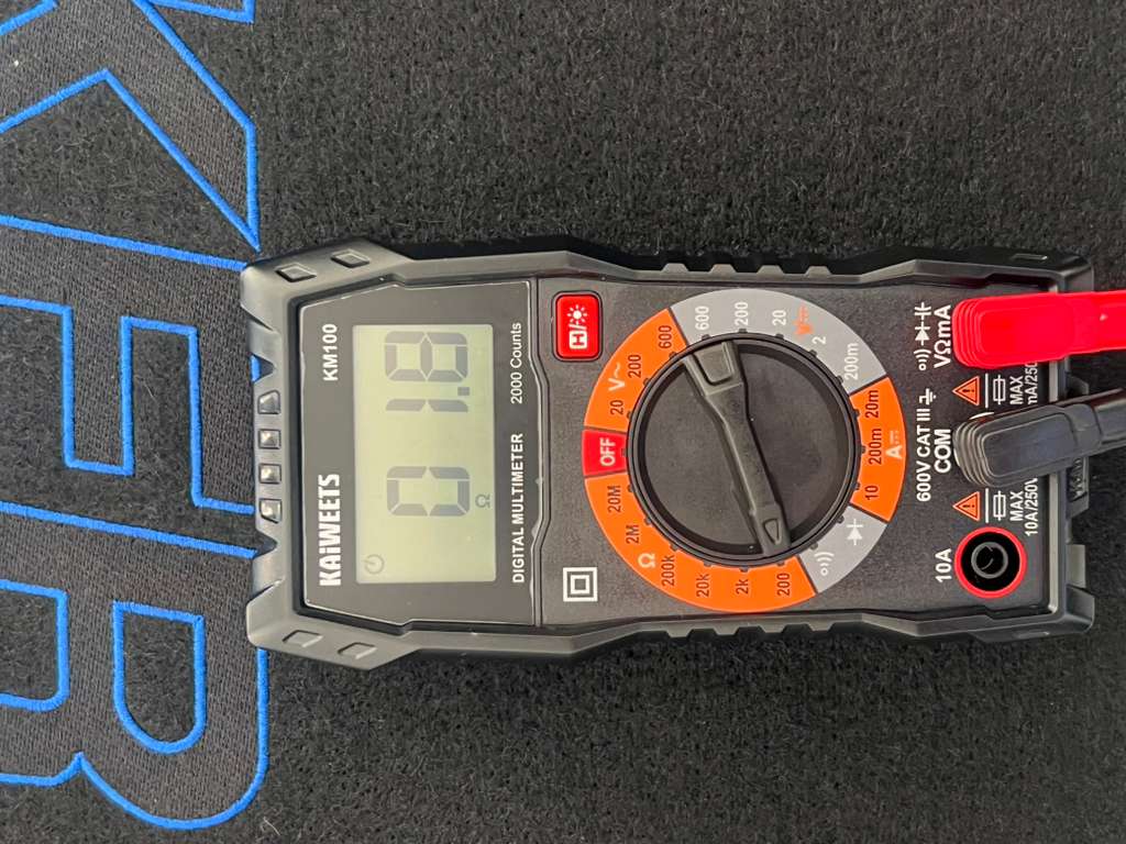

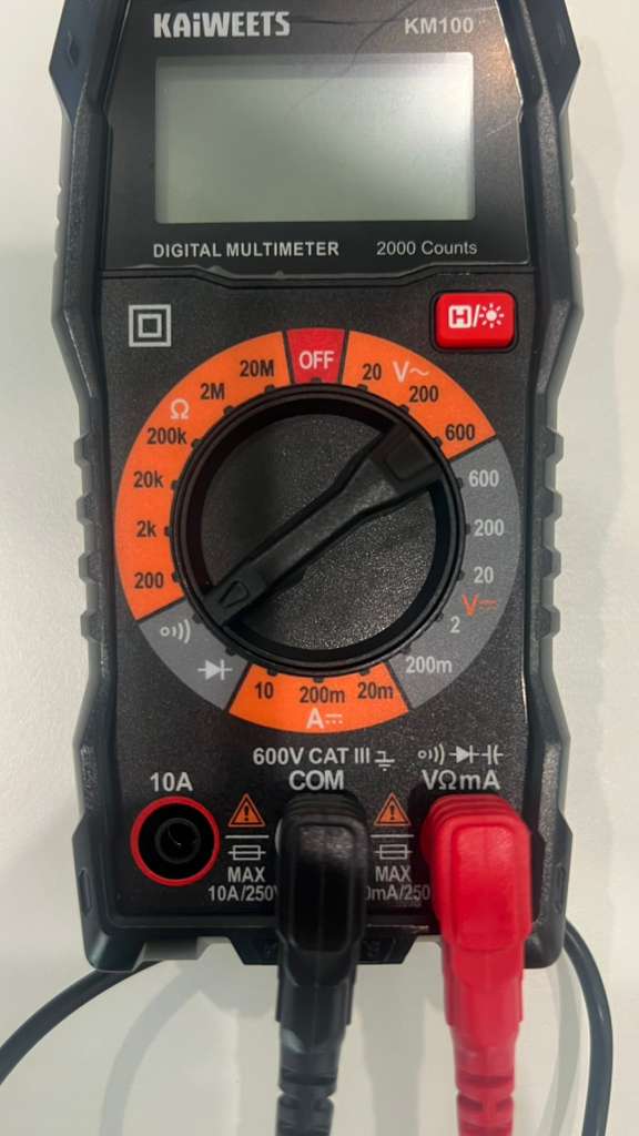

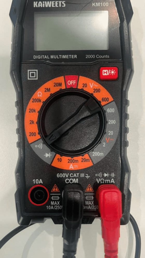

LOL nice - so for future in case I have to use this delinquent multimeter what is the correct setting? I am pretty sure the sub should not be shot the meter is prob not even on the correct setting which should be set to 0 Ohms to start and as you can see there is no corresponding spot on the dial! although if it is RIP the thing was annoying the shit out of me anyways lol - lets see hopefully Mr Kicker Baric will come thru. Thanks for walking me through this setup, will get there soon :/

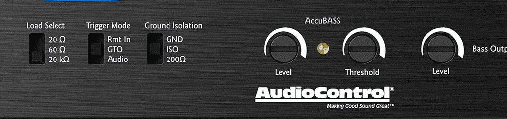

Perfect! So the following LC2 to confirm should be set at what exact settings IE - LOAD/TRIGGER/GROUND
If you were getting signal with no buzzing the switches on the left were fine as they were
If you hear buzzing or alternator whine
You can play with your ground switch
The accubass is a feature you can use
If the bass stops getting louder as ur raising volume
If your headunit doesn't cap the bass at louder volumes it can be used as a bass boost if you want
But for initial set up you can leave them both turned down
I linked the video from 5star it's a good explanation
The bass output level you will find the set level as you follow my instructions
Starting low and raising while listening
Also if the sub is in your trunk if the woofer is facing forward spin it around to face the back of car
In most cases that will sound better and louder
But that will be trial and error which ever way you like best

It's not delinquent 😂 it did it's job and told you the issue
On the section with ohm symbol just put it on 200
I am calling everything in front of me in sight "Deliquent" LOL my wife is like stop! She don't understand the drama I have created. She knows I have had 100's of setups back in the day, when everything was simple lol
@supernov4 Ok so the reading looks proper on the kicker! When I did attempt to measure the sundown it was all over the place (I might open the box and test it later for what it is anyways - wondering if they actually sent me a defective sub, I hardly heard any bass just hard treble lol)
