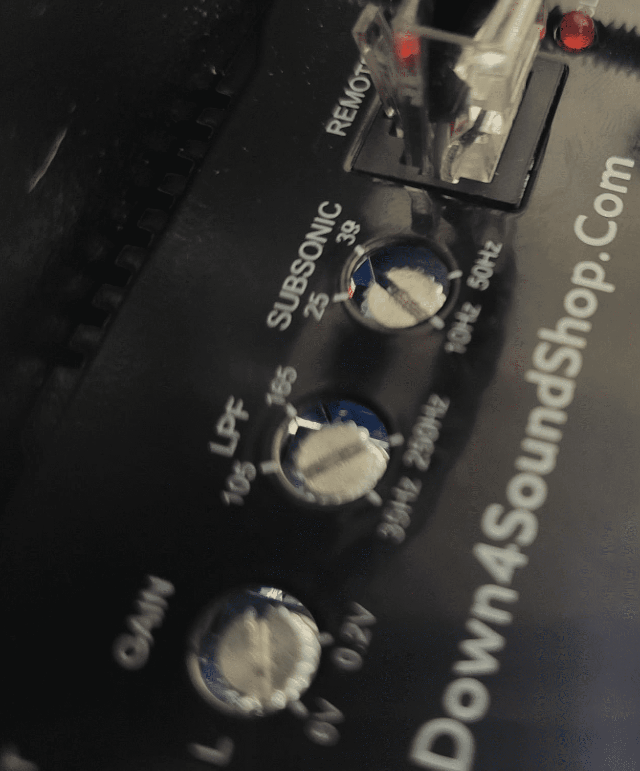

Can you also post a picture of your amplifier gain levels
Attached GAIN settings. This is the clearest I am going to be able to get due to where it is unfortunately placed.

Hard to tell if amp gain is at zero or at 2 o'clock?

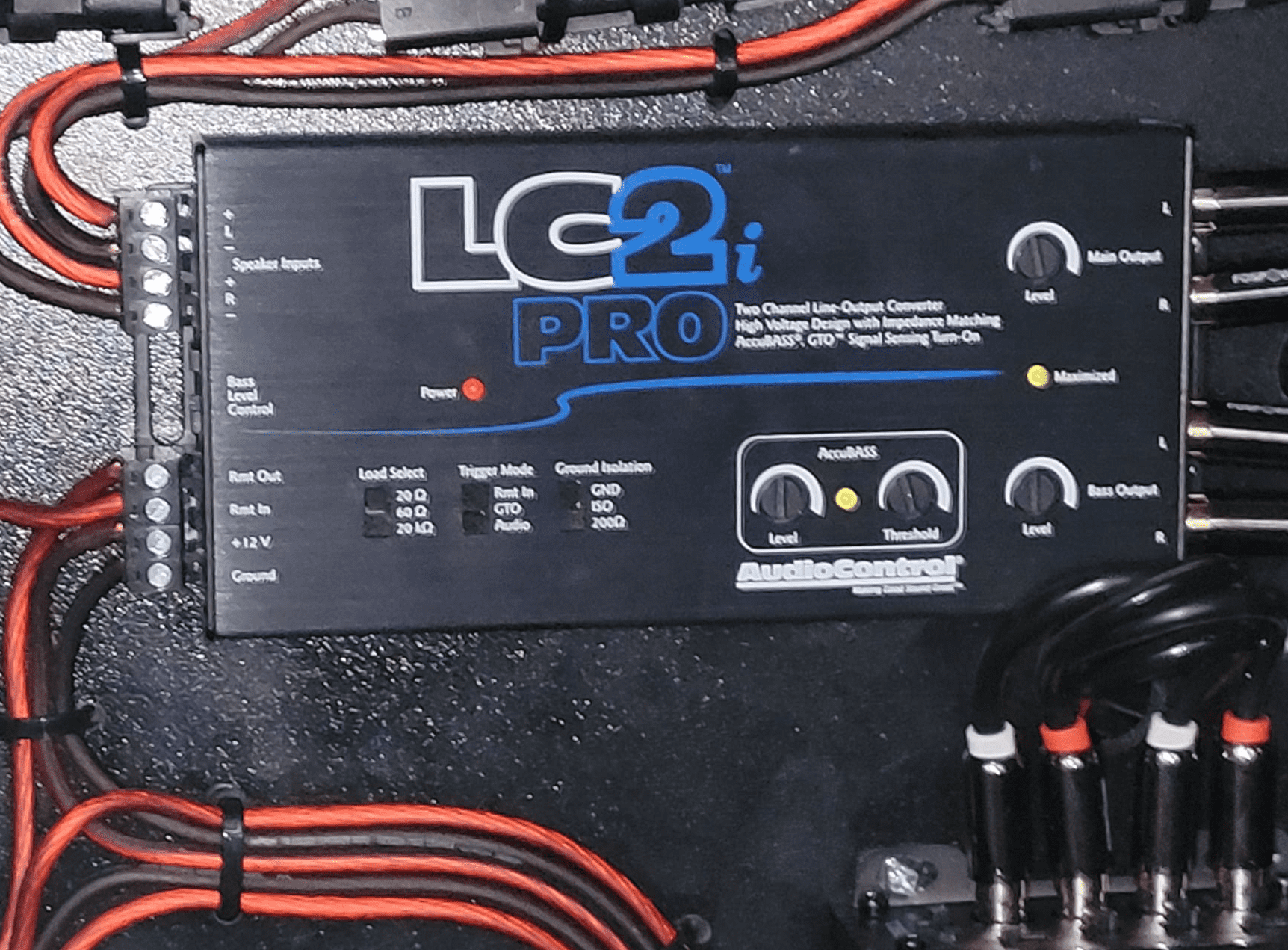

Either way my opinion for the sub section

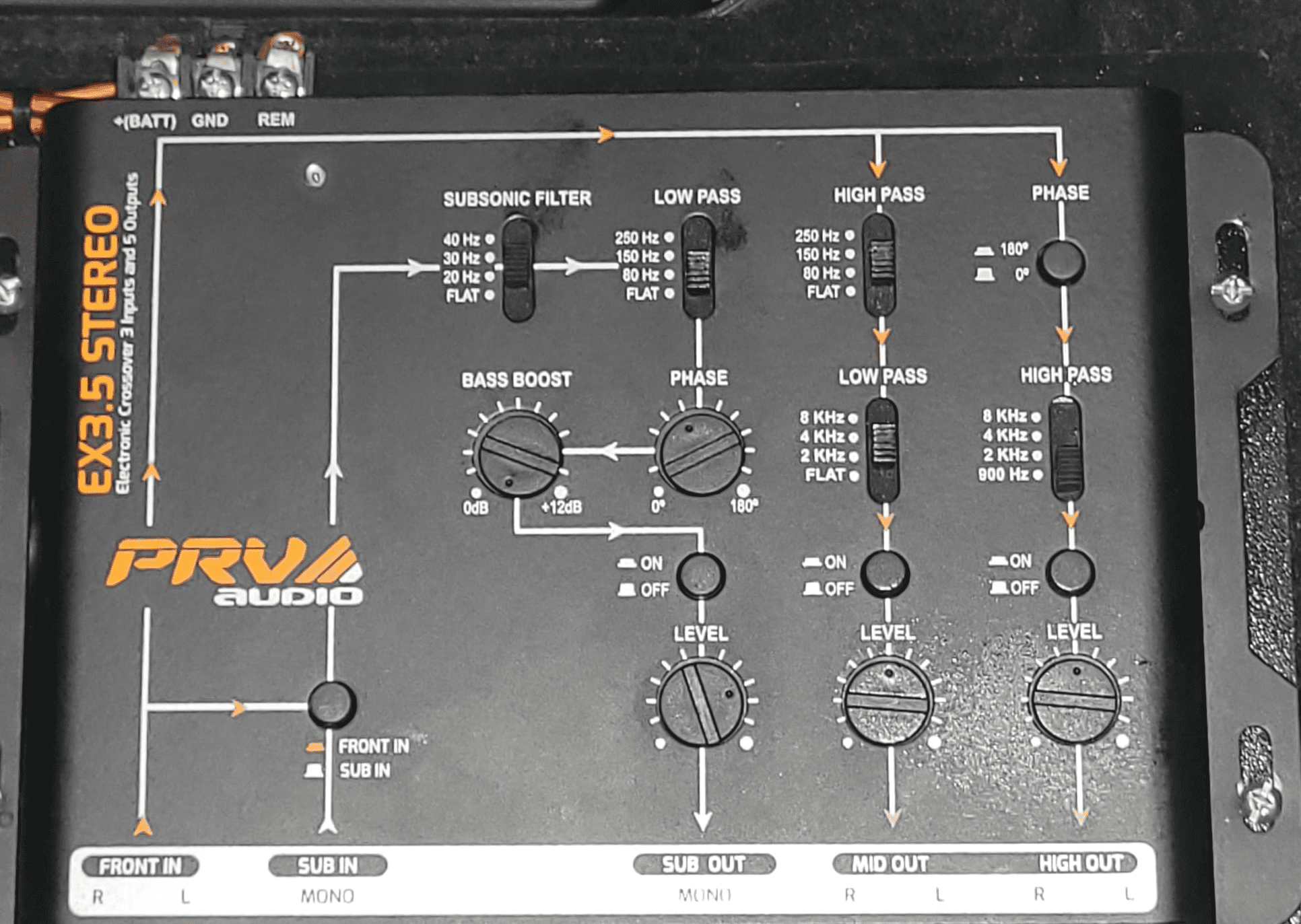

I would eliminate using the prv crossover for the subwoofer
You can run the rca sub out from the lc2 into the input on mono amp
set low pass on amp to around 80 or 90hz
Turn gain on amp all the way down
Turn headunit to around 3/4 or the max level before your factory speakers start sounding bad
Then slowly raise sub level on the lc2 section to output around 5.5 to 6v as your amp is 6v input
You can measure the voltage with a multimeter on the rca end while playing a low frequency sine tone
Without a multimeter I would probably guess the level would need to be set around 1 o'clock as the lc2 is a 9.5v output but can't confirm 100%

If you want to keep the sub on prv that's fine just turn crossover on amp all the way up

Thanks for the response and being so detailed! I need to confirm which wire he tapped into I will have to figure it out, as for the crossover on amp.. you advised to turn it all the way up if I can keeping the LC (I don t see crossover it’s only the three outputs to adjust as per the pic I posted) so the gain I will put all the way down. What do you think of the accubass? Should that be zero on the LC uni. Thanks again hopefully wil figure this out not giving up yet lol
On the amp you will see
Gain
Low pass
Subsonic
Since your lc2 and prv are 9v or more output you won't need to gain any voltage on the amp as they can put out the 6v you need to run the amp at full power
The amp gain is used when let's say your headunit only puts out 3v you need to gain 3v so you would turn gain up to compensate accordingly
The low pass is your crossover
Normally you would set it to +/- 80hz low pass but since you are using the prv crossover i would set it as high as it can go as you will only be getting the 80hz from the prv crossover setting anyway
Plus using 2 crossovers on the same speaker in same frequency can mess with the slopes etc etc etc
The subsonic filter you can set it to 20hz I guess
It's mostly just to protect the woofer from getting subsonic frequencies and damaging the woofer since it's ported
As for the accubass I believe that is to compensate for the factory systems that automatically lower the bass when you put volume high
You will need to get the woofer sounding right, before you investigate if you need that
I also just noticed on your prv 1 pic shows bass boost is up and another pic it's all the way down
If it's up turn it all the way down for now
You shouldn't need that
If it's lacking low end it could be like I mentioned before that you aren't getting low frequencies from the speaker wire they tapped which is why maybe someone tried boosting bass
Albeit you can use it but often not needed
I'm about to lose my mind on this stupid PRV CROSSOVER useless - nothing makes sense! What a delinquent piece of equipment lol, I was told to ensure the "PRV piece of shit output level" should be adjusted to 50%-60% and where that is on the unit only GOD knows and CHINA. Also was told to turn the HPF - OFF, again where that is on the unit?? I am just not having it clearly, trying to stay calm. @supernov4 - I am going to go with your recommendation and just burn the PRV which seems useless at this point to my life. Appreciate the input everyone, will keep going until sorted one way or another :(

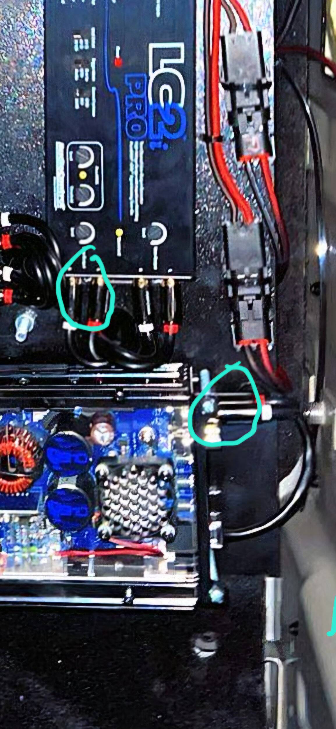

If you want to try bypassing the prv
Unplugg those rcas in green circles
Then run a spare rca from green circle to green circle
Turn knob labeled gain on mono amp down
Turn lc2 bass level all the way down
Turn head unit as loud as you like before the speakers start sounding bad
Then slowly start to raise the lc2 bass level up to bring the subwoofer in to where it sounds balanced to you
