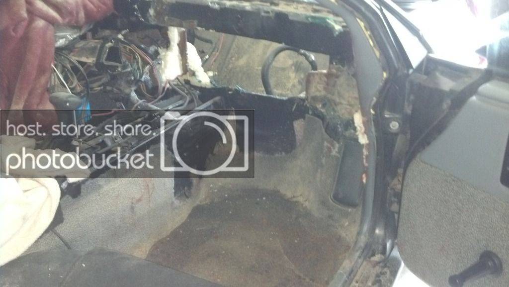

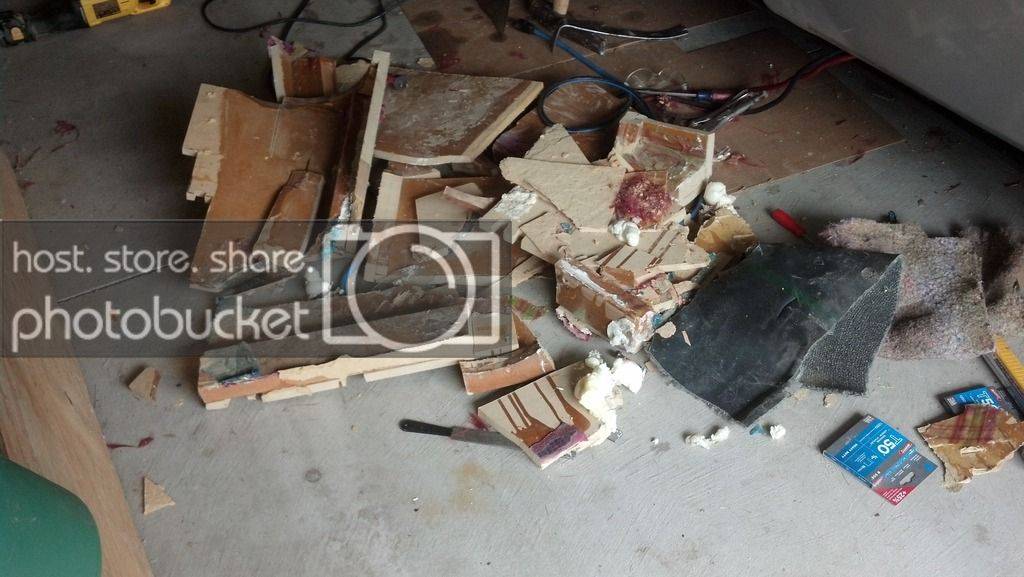

Got the baffle all tore out:

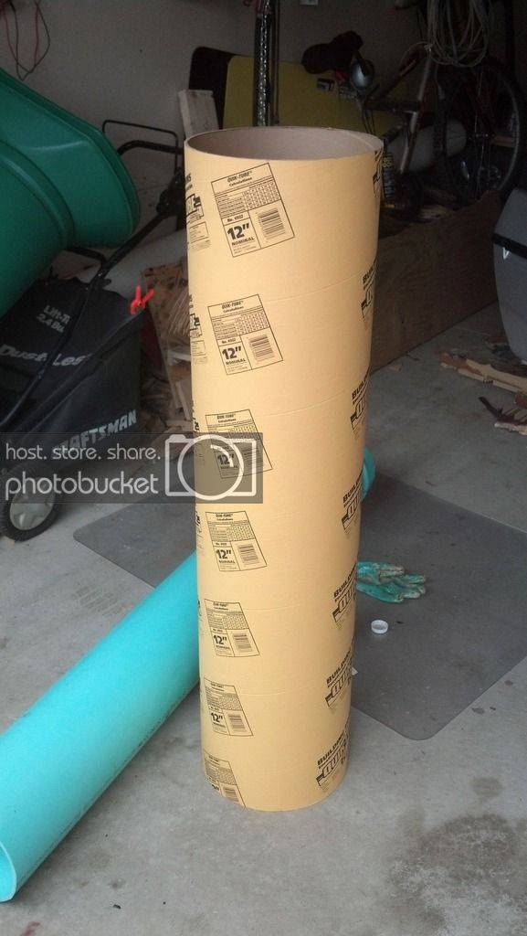

Also got my new port //content.invisioncic.com/y282845/emoticons/smile.gif.1ebc41e1811405b213edfc4622c41e27.gif
Inner diameter of the tube is about 11.5"
Using exactly 40" of it for the port
Box will be roughly 6 cubes. That brings tuning somewhere near 31hz
Will plot the box on winisd after I get T/S specs for the Z's, which will be a while
