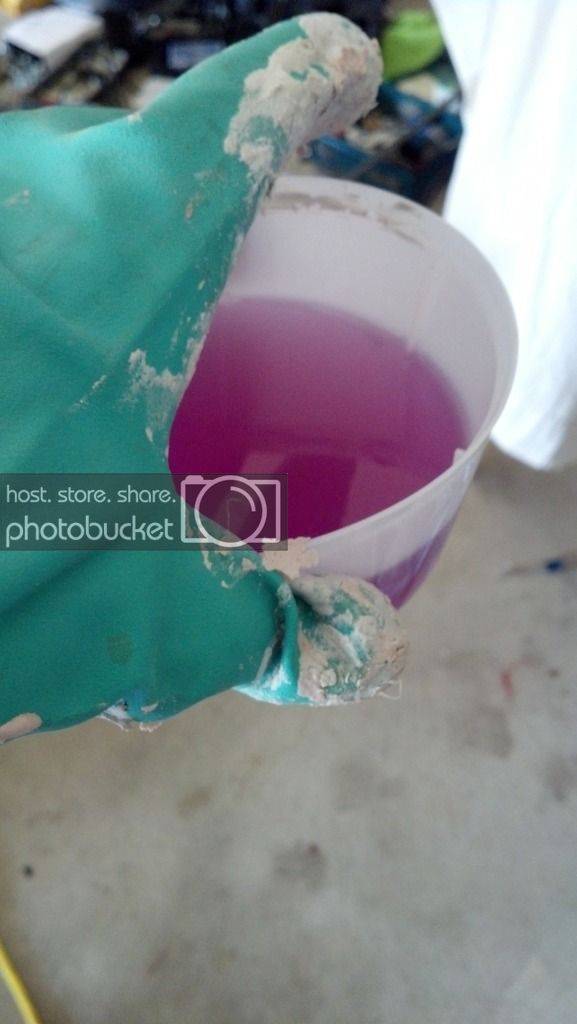

Started using the US composites polyester resin today. Turns out it's purple, which is kinda cool imo.

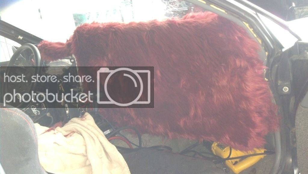

Finished sealing up the baffle and started on the floor. Next step is to carpet the baffle with furrr when this coat of resin cures
hows quality sound wise? do you feel more pressure on chest? how the hell do you keep the dashboard from jumping off... lol ur not that far do you ever come up to gibralter?
Feel it in your ears more than anything. The "dash" is made of MDF and resin.
Sorry, I don't go up to Michigan much. If you come down here, I'd for sure give you a demo
the sq was waaaaay better than i thought it would be, personally. VERY flat response, but still quite loud. The box is sealed to the "firewall" (using screws and 'glass) even though its technically a trunk divider or whatever lol. That space opens up into the air below the car up front. It's a real IB setup.
