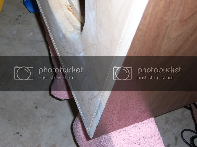

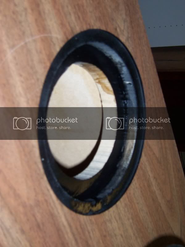

I'm getting close... Got everything trimmed around the edges, then realized I had to come up with a way to trim the laminate around the routered port recess. I had to find something with an 1/8" bearing... So I finally found a flute-style trimmer bit and ground it down to 1/8". Grinding carbide is not fun... where are all the cheap bits when you need them?

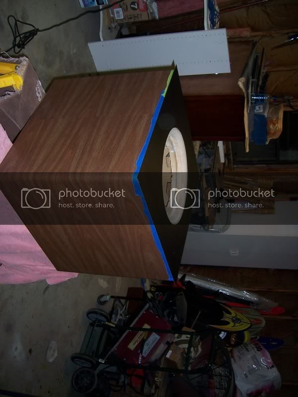

Finally got it cleaned up, then I masked it off and sprayed the inside so I wouldn't see any wood around the port.

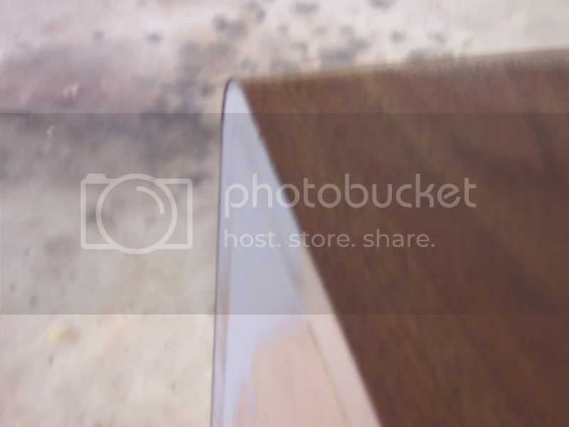

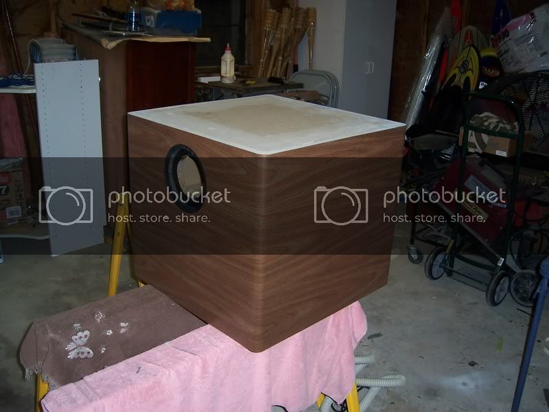

After that I got the lip leftover from the trimmer bit with the sander, so I can lay the black laminate flush over it.
Well I went to home depot today and the black laminate that I originally 2'x2' was actually 2'x4' [just what I needed], so that saved me about 14 bucks, and allowed me to get the contact cement with it for under 20 bucks.

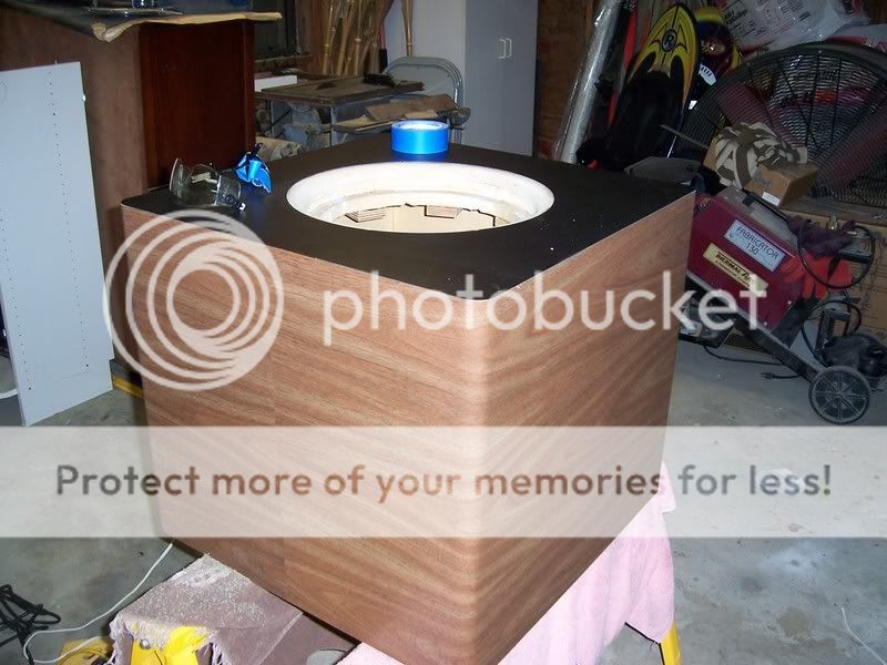

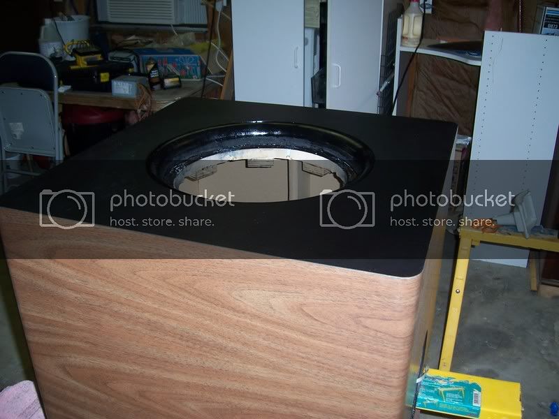

I cut it in half (total *****) and routed out the hole for the driver for the bottom piece. I figure I'd do the bottom first in case I **** up. I was worried about getting it stuck in the wrong place, not having enough glue, having too much resulting in it gooshing out th sides, etc. Well I did it and it worked out perfectly. Perfectly lined up, no goosh. And it's really on there.... not going anywhere.

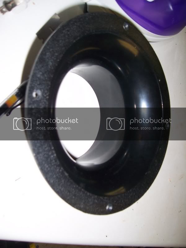

Also got the holes on the precision port countersunk so there wont be any ugly screws sticking out on the flush port mouth.

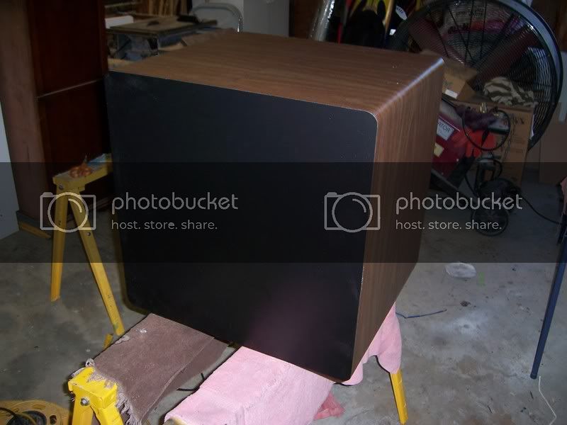

Trimmed...
And painted...

Glue/assemble/install port

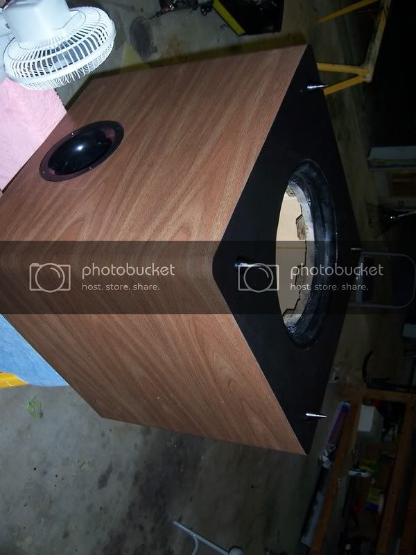

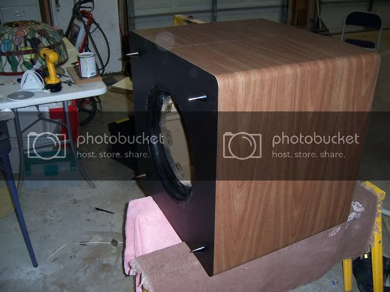

With the work I did tonight, I'm pretty much done and ready to bring it to my apartment. I trimmed the top laminate, glued up the port and screwed it down (its actually much stiffer in place than I thought it would be), and drilled the holes for the binding posts.Then I cleaned out the box (which took forever) to keep the coil clean.
