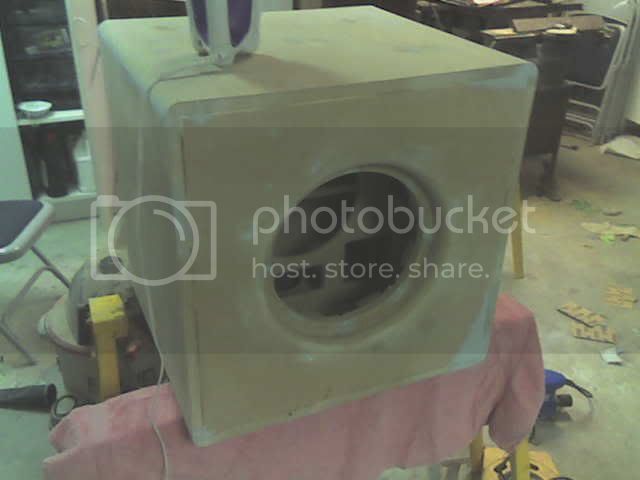

I did get a good bit of bondo work done though. Corners are starting too look pretty good.

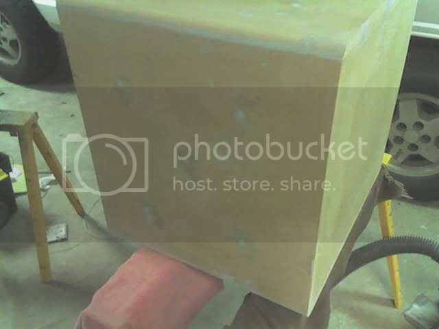

It seems I'm actaully getting somewhere now. I think it took getting the bondo out.

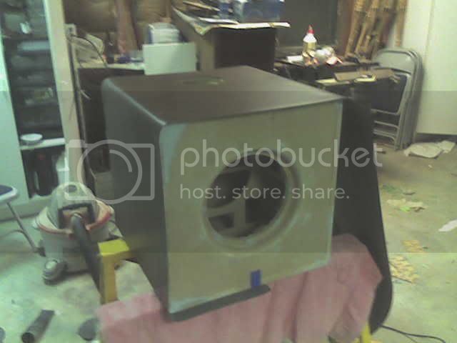

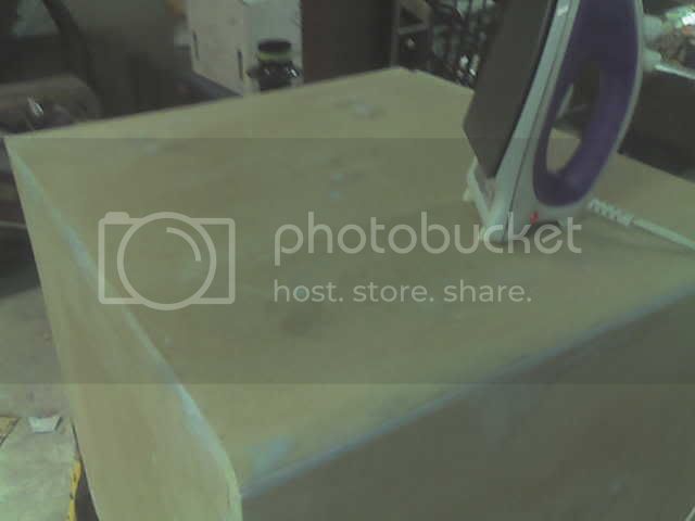

I cleaned up all the imperfections, which took about a dozen different batches. Once that was done and I had cleaned up all the dust I started on the laminate. It takes the corners well enough, but getting the material directly adjacent to the corners will be interesting... I can heat it up but once its hot enough to melt I take it off and it bulges back out... I may have to keep it on and turn the iron off so it cools while being pressed flat.

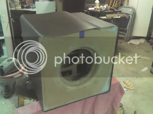

Found a way to get the spots next to the roundovers... I just irons small spots then hold them down with a body dolly. Seems to just **** the heat out too, so it cools pretty quickly.
Now I just have to cut the seam. I have both layer overlapping, so I may have some semblance of a clean, straight seam.Cutting this stuff is tricky though. Even with a fresh razor blade. Hopefully I won't **** it up at this point.
