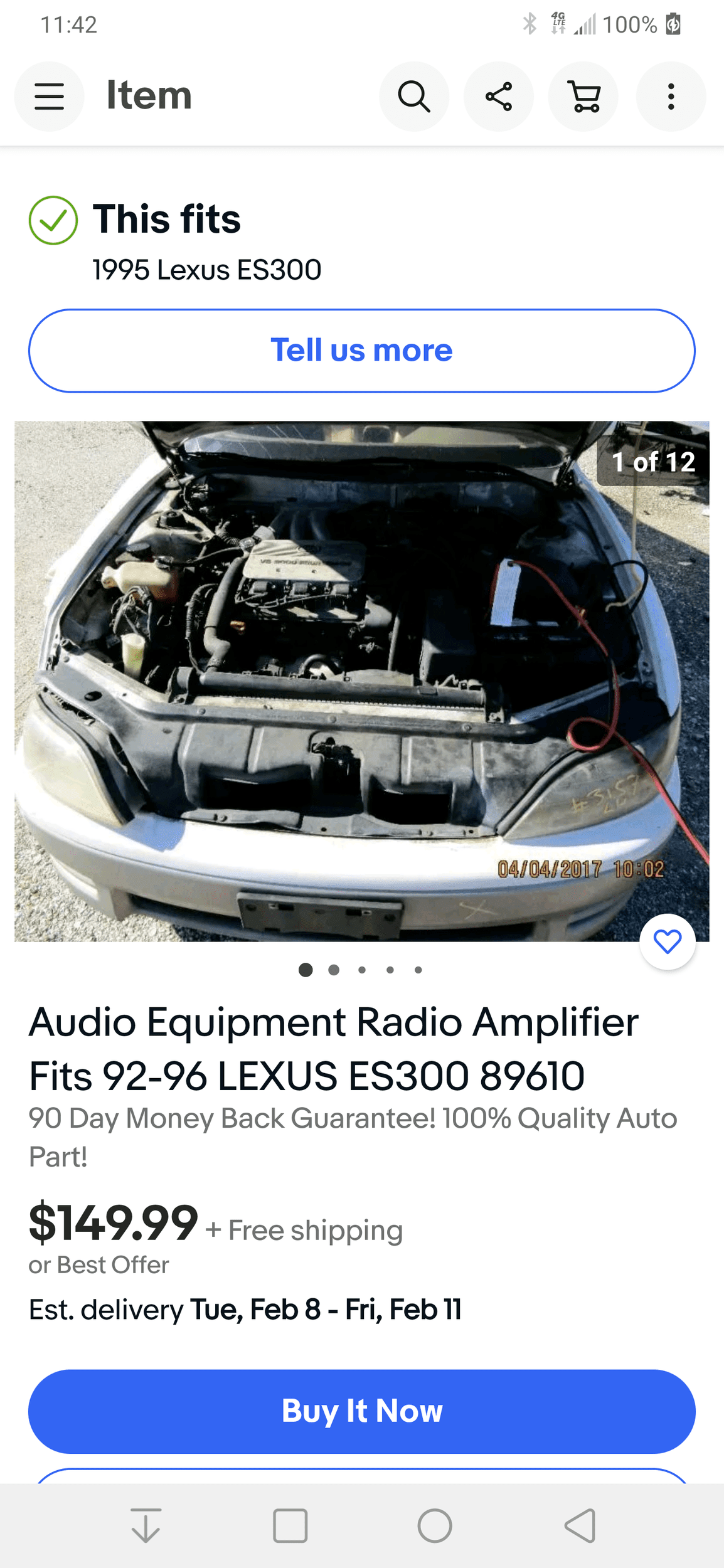

Money back guarantee. Worth a shot.
BTW, a possibility but, have you checked the amp's fuse? Also, have you tried calling tv repair shops to find if they may be able to fix it?
Money back guarantee. Worth a shot.View attachment 35549
yes, i did check the fuse for the amp... and I know though there are used factory amps out there... i could probably find a graveyard and pull one... my concern is the entire happening again... the original pioneer amplifier was good but it is electronic and it does have a little age on it... that's not to say a used amp wouldn't last time but forwhatever reason I've committed now to a two amp install with the converter... I'm using a relay for the 'remote on' to power the three but counting up all things including RCA>2-wire adapters it going to cost me at around $200. using a factory amp i'd be needing the converter anyway but then at least I'd know what I'd be getting... my vehicle has low miles for it's age but most don't...
