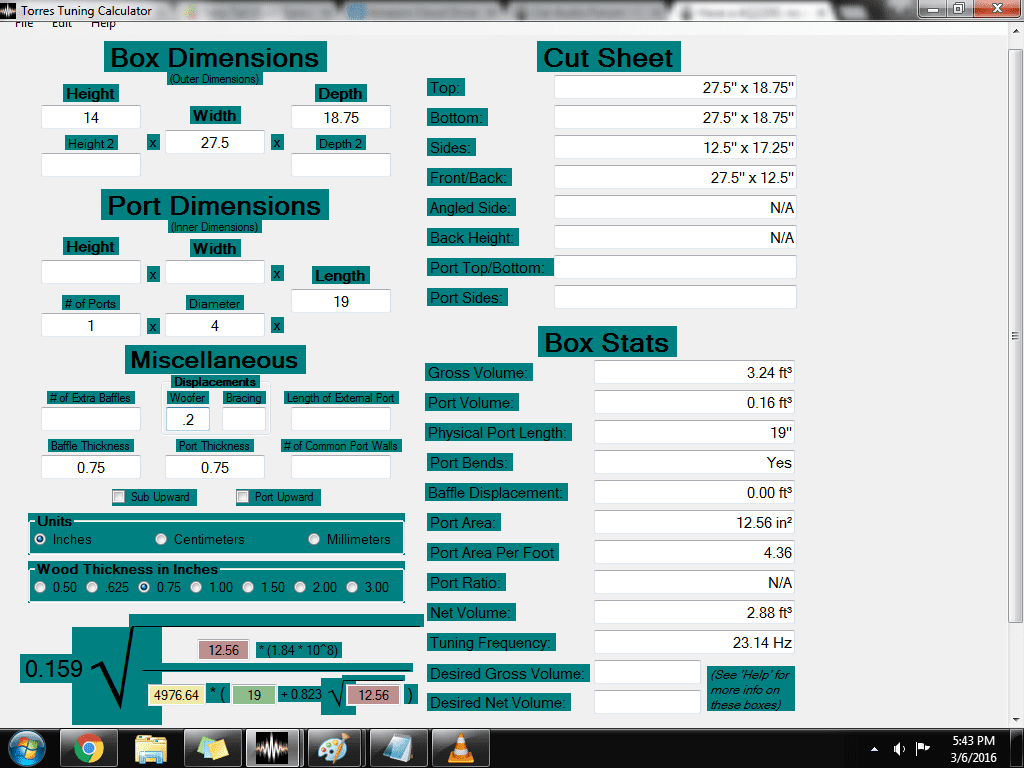

something is seriously wrong with your box... like completely wrong... Port is way too small, box is way too big tuned way too low. If its two 4 inch aeros, it looks a lot better and its workable, however, there's still an issue. It looks like its a side port as well, which is far from optimal.
How is this not telling you your box is totally wrong?
This ^^^^^^^^^^^^^^^^^^^^^^^^^^^^^^
Ok you are correct then I missed the 2 4" part.... But don't be scared of running .5ohm, that aq 2200 can do it without a sweat. Just keep gain turned down and it will be just like running it at 1ohm... It won't be hard on the cars electrical unless you go full tilt ballz to the walls..got a volt meter and stay above 12v and no problems
