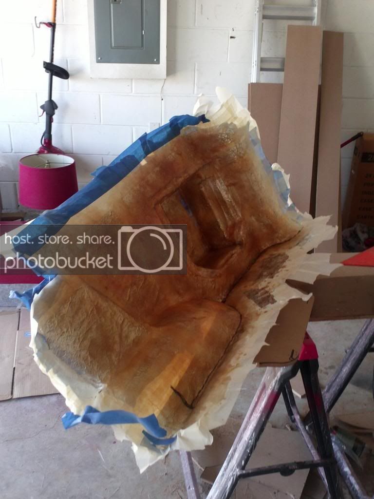

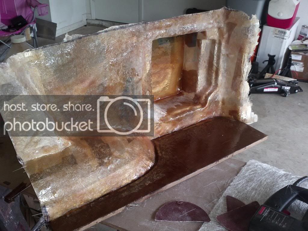

well here is a small update got the mold pulled and trimmed up for the most part....
anyways here are some pics.... if i cant get the base molded to the mold tomorrow for sure on monday(go on vacation tuesday for a week). then its on to adding some more layers before wrapping and glassing the whole face of the box. should be fun lol

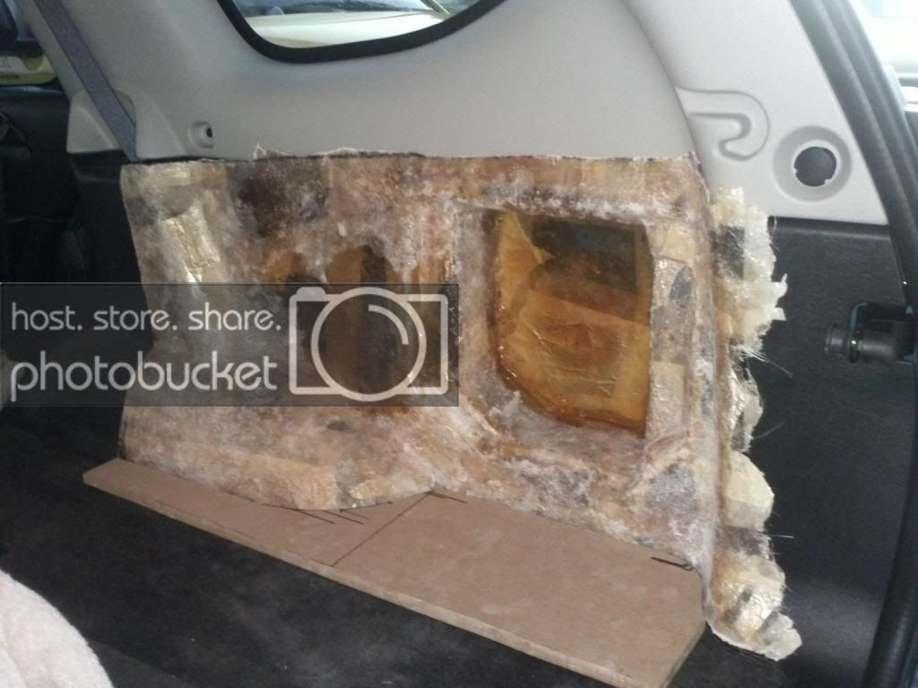

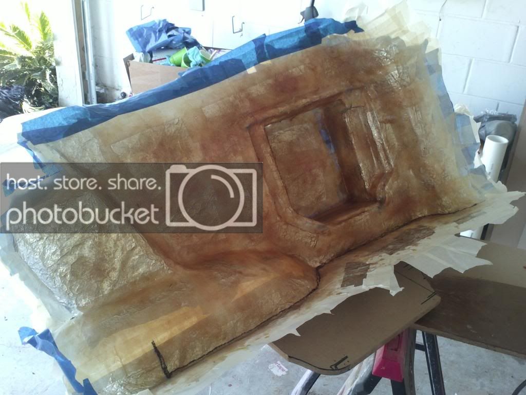

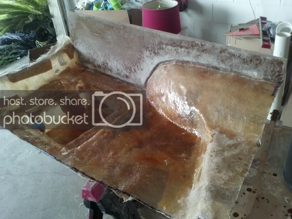

well nothing crazy today..... got the base molded to the mold. did 2 layers and inbetween the layers i pour extra resin the vally. probably will do 1 more layer to be sure and then on the back side shoot sum foam in little cracks here and there then smooth out. i also added another layer to the cubby hole area and the flat back surface. i could probably stop but want to be sure it good. be my first box where its almost completely glass. when i come back from vcay and bills are paid think im going to invest in a dremel to cut the remaining edges off and then start on my speaker ring and wrapping this thing to be glassed.
anyway snap a few pics.....
oh and this thing fits back in place like a glove.
